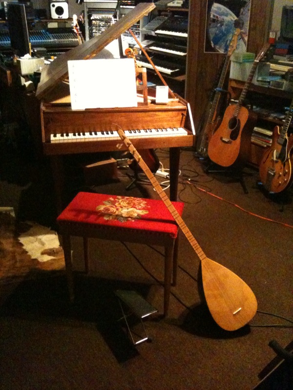

Best pickup type (and mic'ing) for baglama saz?
Well, sooner or later it had to happen. I found the Baglama Saz deal I was hoping for. A guy down at our local animation paradise (you wouldn't BELIEVE the colorful toy world they work in) gave up on learning to play it and put it up on Craigslist, so I went down, handed him the modest sum he wanted, and (after marveling at his personal work studio set-up and meeting his co-worker in the adjacent heaven-office with some lutes and a Turkish oud) drove home one deeper in Middle Eastern instruments. Wow, how DO they manage to make that thin wooden neck so it stays so straight and doesn't need a truss-rod?
The stringing is amazing: the top course with two steel 0.007" and a steel-core wound string, the middle course with two steel 0.011", and the lowest with a 0.007" and a fatter steel-core wound string !? I thought this was a mistake, but a little Googling seems to confirm it as valid. On multiple sources' recommendation, I tuned it (Ascending) Gg dd Aaa. A thin delrin risha seems to be fine as a plectrum, better than than little soft red plastic gala thingie it came with.
The tie-on frets work well, and offer all the half-flats needed for most Maqamat, like B-halfFlat, E-halfFlat and a few more. The bridge is so low it's nowhere as surgical an instrument as an oud (no Mike's for THEM guys), and the whole approach lends itself to straight-ahead carpet-strumming in Neva. Wheee!
I was surprised that K&K lists every imaginable instrument, including a Saw, with a pickup recommendation -- but no Baglama, no Saz. So can someone who's been there tell me what they've found works best, for studio work, and for live playing? A piezo under the bridge? dual piezos on the soundboard? under the soundboard? I don't see any way to access the innards except possibly through the little swiveling cat-door (do they come off?). How about mic'ing, what type of mics in what positions work best?

That is certainly one of the (many) tunings.
I play a bağlama I purchased in Turkey and was told there that the 'normal' tuning is ascending Aa gg Ddd. That was the tuning on all of the several instruments I tried in several stores.
This tuning is referred to as 'bağlama or aşık düzeni' and is re-entrant, so a little difficult at first for those accustomed to normal low to high tuning.
The small soft plectrum is the type used by all the bağlama players I have seen.

Baglama was once my main instrument, and for bang for buck you can't go past k&k twin spot classics, as long as you don't mind them being on there all the time. I had great results on all my sazlar with a spot each side of the bridge... it was a far better sound than my friend's bridge piezo.
I may even be able to dig up a soundbite of the saz with the k&k's...
The AKG C411 is used a lot in Turkey I've noticed, easy to get on & off too, great sound, but you could get the k&k's for ALL your instruments for that kind of $.

I also use the tuning Greg mentions, although properly it should be LA SOL RE, as the actual pitch is often from B or C, (look up Arif Sag or Musa Eroglu ) as the length of the short-necked saz's has generally gotten shorter over the last decade or so.
(Hey Greg, how'd you get those Turkish characters?)
The tuning you mention (the d's sound a 5th below the A's, with the G's one tone below the A's) is the common long necked (uzun sapli) saz tuning Kara Duzeni, although it is used on short neck for folk/dance music.

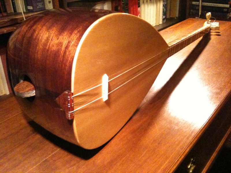

Contrary to the impression created by the perspective of the photo, this is a long neck 23 fret baglama. Yes the reentrant aspect takes some getting used to. I guess they call Gg dd Aaa bozuk tuning?

Correct, Bozuk or Kara, same thing. Nice find!

I have used K&K Twin spots on most of my sazlar, from the curas all the way up to my meydan with excellent results.
It may take some fiddling to get the best high and low responses as far as placement on the soundboard.
Please use the correct pick, and PLEASEPLEASEPLEASE don't try to 'improve' the instrument - since I am pretty sure the luthier had a pretty good idea of how it is supposed to sound...:)
