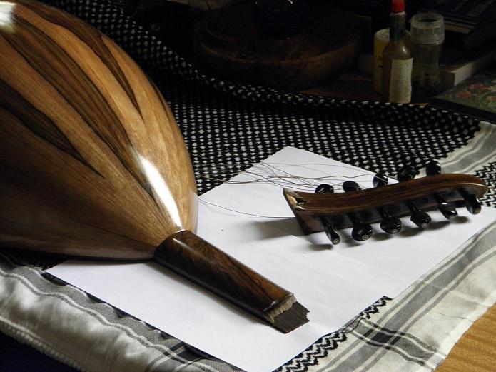

My new oud arrived today with a broken head:(
The neck is also broken through.
Could any makers offer any advice on how to go about repairing it?
(sending it anywhere is not an option.)
Thanks.

Dude this looks pretty painfull...you need to send a note to Dr. Oud -- from my point of view, you might need a new neck...and fingerboard since there's so much damage...but I'm just an oud user, not an oud builder. Really a drag too, since it looks like a pretty nice oud.

This looks repairable to me. I've had worse and fixed them. Not necessarily professionally.

Hi Spyros, I do think it's repairable also, as there are no bits missing, no glue joints broke, only the wood, so I'm just waiting to find out what glue was used.
My main concern is if it would be strong enough, I've glued heads back on but never where the neck is broken right through.

Sorry for the predicament, I am sure a violin/ guitar maker can fix it.

I would try to epoxy it back together or use a high bloom strength hide glue.
It seems like a clean enough break. You dont loose anything by trying that. As the other option is to make a new neck... there is no 2 ways about it imo.
I know the maker ( its easy to tell without asking) but regardless, I dont think we can blame him at all so might as well leave it out of the story. Sometimes there are issues with grain direction and the very rough handling of freight is a reality we all have to deal with.
good thing you are insured and you wont loose to much on it.
I'm getting some good hide glue tomorrow.
I agree, and if it doesn't hold...
too true! Being out near the edge of the galaxy I've always had to do my own repairs and modifications, somehow I bluff my way through it with a lot of thinking and focus.
I plan on making my own oud in the future anyway, either way I need to learn how to make a neck so I guess it's all good.

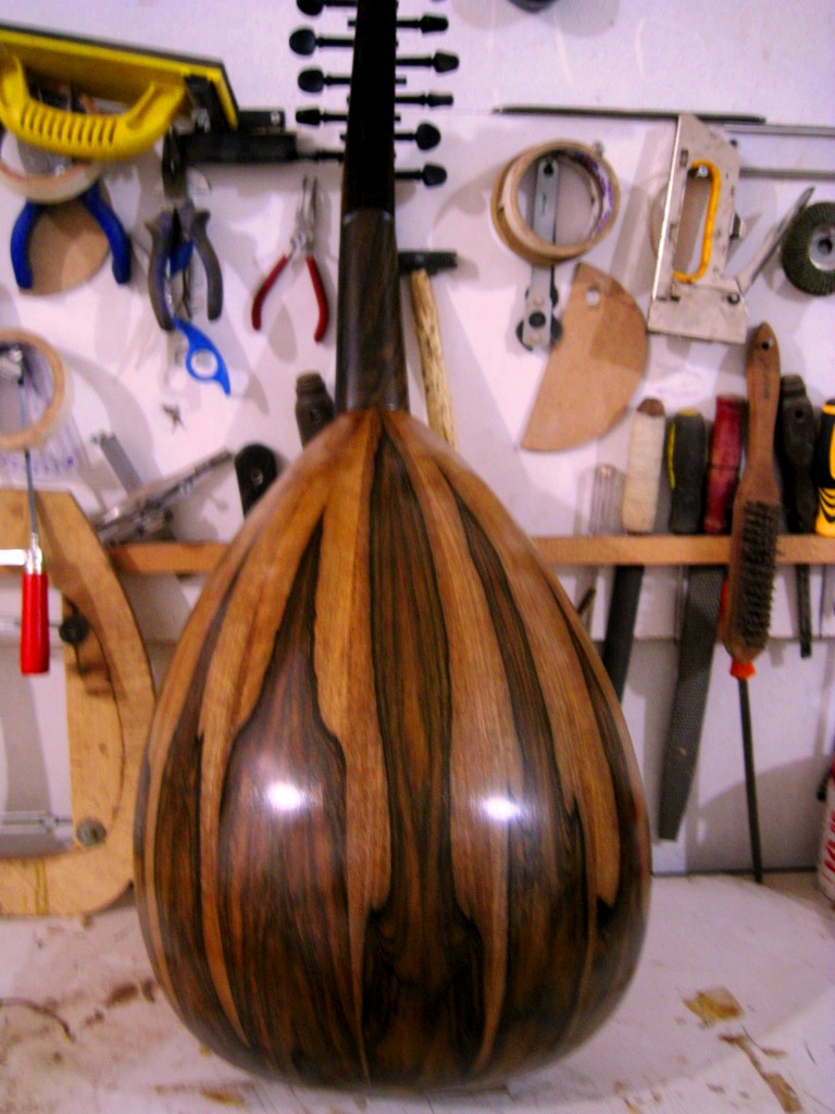

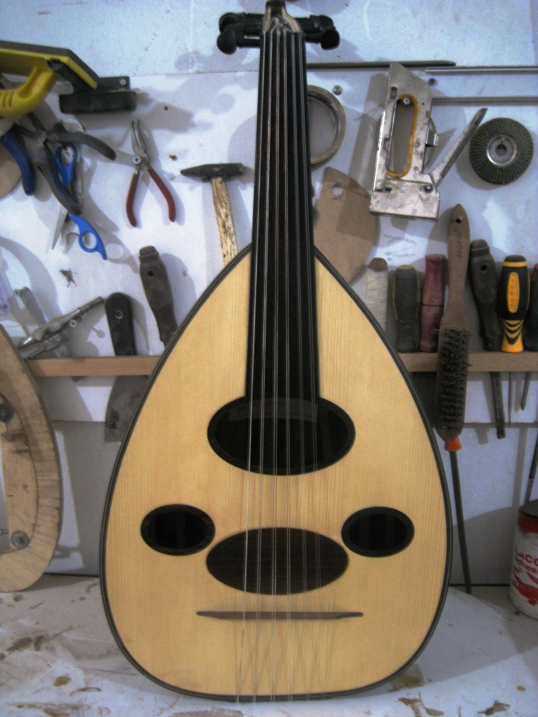

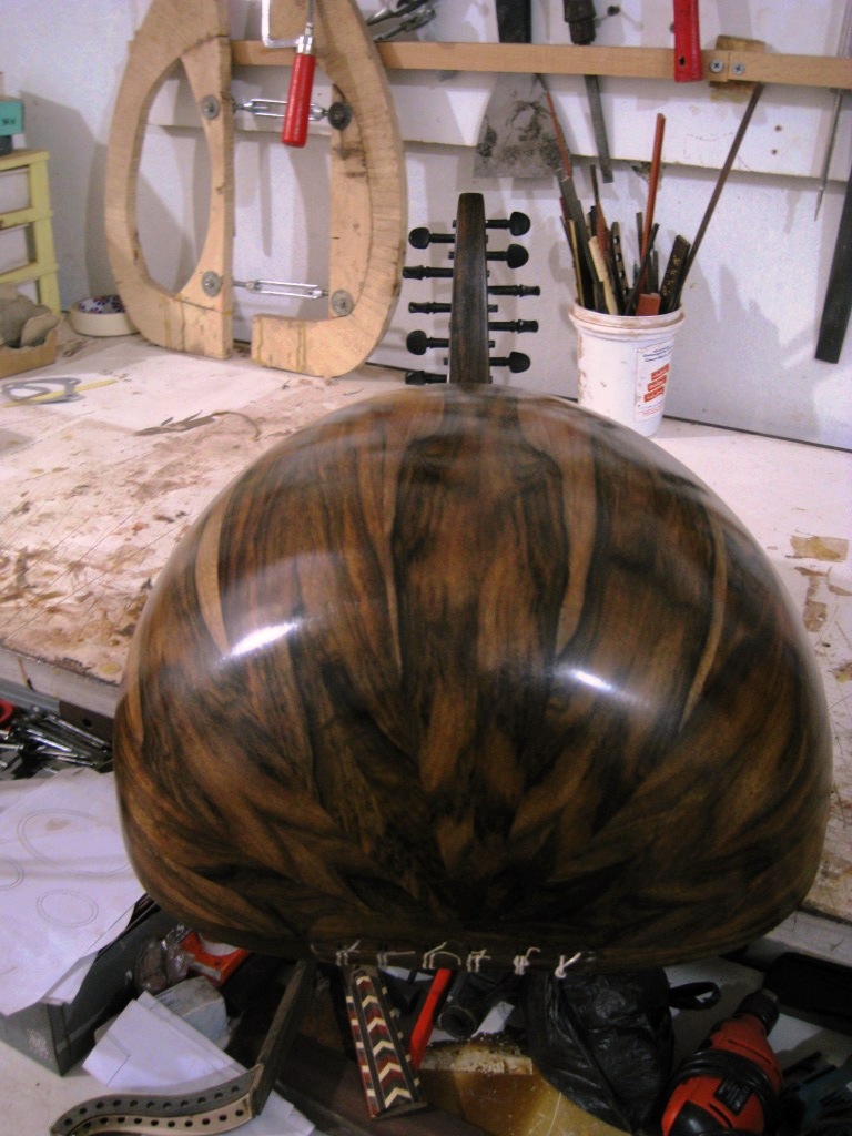

Here you go Awad, but the face is (nice and) plain...
IMG_1899.jpg - 207kB IMG_1898.jpg - 201kB
IMG_1901.jpg - 206kB
