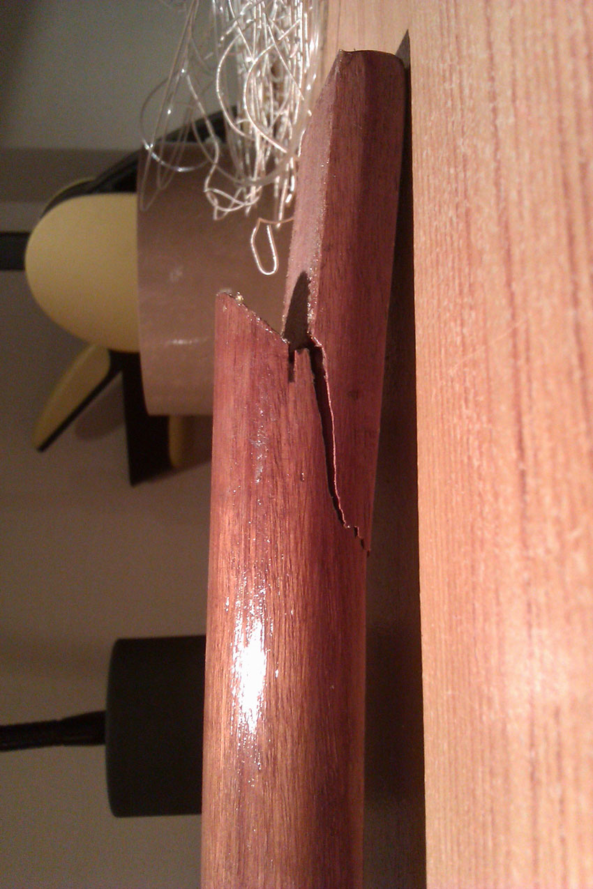

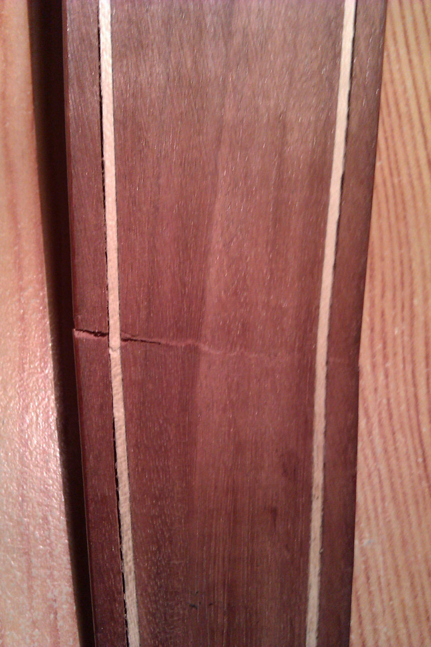

I want to know if it's better to cut the neck an glue it, or to put the glue directly into the fracture ?
Thanks for your help.
[*] posted on 11-15-2010 at 03:27 PM
Put the glue directly into the fracture if you can close it back so it is very tight fitting.

Is the Titebond liquid hide glue, I already have, powerful for this kind of repair ?
I can make a new neck but don't have the tools and time now.
I'll try with hide glue this evening.
regards
[*] posted on 11-16-2010 at 07:44 PM
Titebond liquid hide glue is not real hide glue. It is not as strong because it is not prepared fresh.
Titebond regular glue would be better for this purpose.
