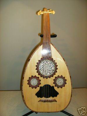

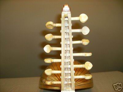

A question from a beginner ... please
Hi there
I bought a used Oud to start lessons and learning.
the keys do not stay but for few minutes after Dozan the oud and they slip.
the problem is ... I live in south Florida USA, where musicians here didnt even know what a Oud looks like.
my Question is ... can I change those keys and install others from another instrument ... Violin ... for example, or what do you think I have to do?

You can have the pegs replaced, but it's not an inexpensive job -- you could check with a violin shop locally, they should be able to show you some different style and size pegs -- viola pegs might work for you; these jobs usually cost in the neighborhood of $200...not cheap by any means.

Please find a real luthier if you're going to have any work done with the pegs. This 'girl' is not it.
A google search turned up someone named Ross Teigen as a luthier near you. Not sure what his deal is, but you should try talking to him. There's also a violin shop a bit north of you that might be able to help.
I don't think you need the pegheds, just decent quality, properly fitted pegs. Viola pegs usually work, though you can order sets of oud pegs online that might be a less expensive alternative:
Ebony: http://www.amazon.com/Oud-Pegs-Set-12-Ebony/dp/B001AYQ8MO
Olive: http://www.dalymusic.com/oud-pegs-olive-wood-set-of-12.aspx (some people don't like olive pegs, but I actually do, as long as they are properly fitted).
There are more options if you search.
If you find a competent luthier, (s)he may want to watch Jameel's oud peg fitting tutorial:
http://oudluthier.blogspot.com/2009/11/peg-fitting-tutorial.html

he took couple of pegs off the oud and tested the holes and said that the pegs were painted and that is a crime ... he cleaned the holes and worked on the pegs with a tool that looks like a pencil sharpener and after a while he said that the pegs are worthless.
he convinced me that good pegs and the process of tuning my oud the right way is a pleasure I shold not miss by using the mechanical pegs ... and I am convinced now,
he ordered a set of 12 ebony viola fancy shmancy pegs that will cost around $40 with shipping and will arrive next week, meanwhile he kept the oud to clean all the holes.

Hey Sam, hopefully the nice man will not charge so much you will wish he called you Dude. You can get a reamer and an adjustable shaver for about $80 total, on e-bay, so keep that in mind as an option, it's perhaps a pleasure you shouldn't miss. BTW fancy rosewood or ebony viola pegs from Dov Schmidt are $1-2 each. Rosewood is easier on the hüles, not as abrasive. If the peg is 10x harder than the hüles, peg wins, wears hüles. Etc.
