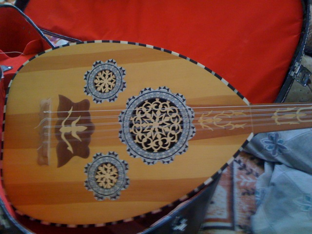

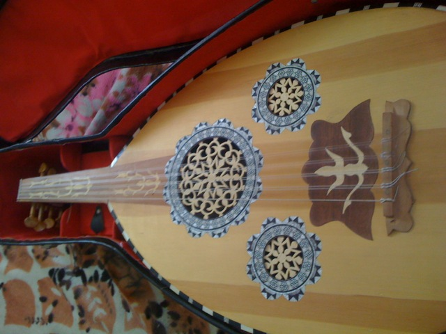

I purchased an oud a few months back on craigslist for $80 and wanted to know more about it. For example, maker, quality, type of wood, or any other information. Also, I was wondering if it is a good oud or bad oud. Here are some pictures.
Thanks for the help :)

Hi Ice88,
It's hard to tell about the quality from the photos. It does not look like a "fine" or "professional" quality instrument, but it looks better than instruments for which I have paid much more than $80. If you want to know the builder, there should be a plate inside the instrument. Look through the rosette at the inside of the bowl. There should be the builder’s plate there, probably in Arabic. Can you find a way to photograph it?
Regarding quality, here are some things to look for:
-Tuning pegs: A good oud has smooth tuning pegs that look uniform and well-milled. They should protrude (stick out) from the peg box about the same distance (on both ends). They should turn smoothly and evenly and not slip after you have tuned the instrument.
-Nut: Should look smooth and evenly milled, not "rough." Should look like a hard, not a soft wood (or whatever other substance is used). When you tighten and loosen the strings, they should tune up and down SMOOTHLY, not popping up or down in tune suddenly.
-General construction: The oud should look well-milled and fitted together. A well-made oud is built smooth and even-looking with a minimum of wood filler (preferably: NONE).
These are just a few of the characteristics to look for.
Hope that helps!

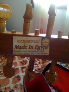

Well inside the bowl it says "Bavly export" and it gives a phone number an address and website. It's the same tag that is shown in the picture. I'm thinking it's a mass produced oud that was made in a factory and not an individual.
P.s that export website is http://www.bavlyexport.com/

Typically, even mass-produced ouds have a plate on the inside of the bowl that gives the name and address/phone of the maker.

Bavly is a generic label that Mid-East Manufacturing imports ouds under. Like this:
http://www.amazon.com/Egyptian-Deluxe-Soft-Case-Pick/dp/B004I6L3TY/...
For the money, with a case, you got a good deal. These are simple instruments quite suitable for learners. They seem to be made by several workshops in Egypt. The sound will not be as refined as on an oud made of harder woods and with a thinner soundboard, but it could sound anywhere from passable to quite decent. As long as the neck is straight and the soundboard isn't buckling, you can get good use out of it. If you search on this forum you can find a lot of tips on how to get the most out of such an instrument, it can be optimized in many ways. It is strung with 5 courses now, which is common, but you probably will want to learn on a 6 course oud, and the bridge and nut should be ready to accept 11 strings. You should get a full set of good strings, like these
http://ostriemusicsupplies.com/marioud-ar.htm

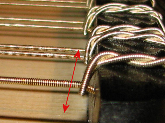

Measure the height of the strings over the fingerboard and examine the nut and bridge. You want the string height at the neck-body junction to be 2.5 to 4 mm, ideally under 3 mm. I once posted some equivalents in US coin stacks if you don't have a little metric ruler. It looks like the strings are not looped ideally and you can lower the action when you restring by looping them properly.
If the instrument doesn't have any structural defects you may enjoy it for years, or at least until you are ready to get a much fancier oud. Try to find a teacher locally and get OudProf's "Learn Maqamat on Oud" DVD on e-bay, because the oud opens up a world of completely different scales that really bring the oud into its own, and why limit yourself to stuff you already know? it's a great tool at the price of a single lesson. Congratulations and welcome to the wonderful world of the oud.

As to looping, thin strings call for the rightmost method, and the fattest wound strings can use that too or, if you can be sure they won't slip, you can use either of the leftmost methods. Then, while the string is still unattached at the peg end, pull it tight, shoving the loop with your fingernail towards the bridge, repeatedly pulling the knot tight, and rotating the loop downward, so the string sits as low as possible on the bridge. After the string is wound onto the peg, but before pulling it fully taught with the tuning-peg, you revisit the bridge and make the final bid for as-low-as-possible. When the string is pulled tight it is still possible to rotate the loop upward to raise the action, but the reverse becomes impossible.
IMG_9721x2.JPG - 70kB
The loop positioning gives you a few precious millimeters of adjustment of string height above the soundboard. Since the neck-body junction is 1/3 of the way from the nut to the bridge, 6 mm of adjustment at the bridge translates to only 2 mm of adjustment at the neck-body junction. If the action is too high in spite of all efforts, i.e. over 4 mm for a percussive timbre or over 3 mm for a zingier timbre and faster fingering, you must explore corrective measures. This is an often-discussed topic on this forum, as the small range of action adjustment that can be effected by fiddling with the loop is one of the familiar curses of the traditional oud.
In the absence of mechanisms to adjust the neck-body angle (which you find on a Fadi Matta or a Sukar), the action height is determined when the neck is glued to the body. Over time, the settling of immature wood (the material of choice for inexpensive ouds) tends to elicit twisted geometries, unplayable actions and other preludes to the traditional "neck job", a savage surgery that makes all things right again, while testing both your relationship with your luthier and the depths of your wallet. Maintaining a steady humidity in the oud's habitat can help postpone this experience, but if it starts out with a high action, you have to deal with it.
Desperate alternatives to the "neck job" include drilling new holes lower on the bridge, gluing on a layer of fingerboard and reworking the nut, planing the existing fingerboard (and reworking the nut), not to speak of time-honored existential remedies such as "sticking it deep in the closet" and "cursing and smashing the damned thing." Let us know how high the strings are above the fingerboard, right at the neck-body joint.

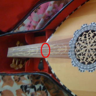

Wow thanks for the advice. It seems to me that I have a lot to learn. When you mentioned measuring the point of "the neck-body joint", is this the point were the nut meets the neck?
BaniYazid
Registered: 8-20-2010
[*] posted on 2-7-2011 at 09:51 AM
neck-body junction
oud 2.bmp - 317kB
Here you can measure the action.

Sorry for the noob questions. So the distance from the fingerboard to the string should be 3 mm? :)
