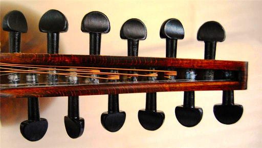

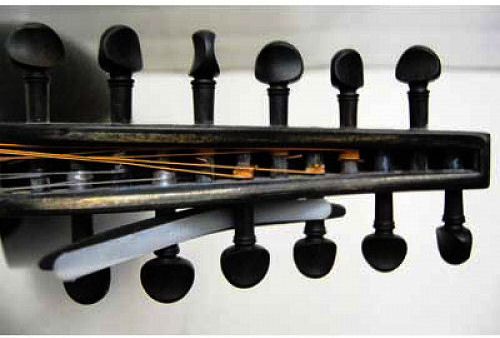

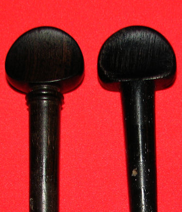

Generally forget the Gawharet El Fans. What I'd suggest is you try to find one of the Sukars with "ebony" pegs. There are basically two types of pegs Sukar uses. The softer wood, often olivewood, that's dyed black, and the harder rosewood or ebony. The taper on the softer wood pegs is steeper, as per tradition, and the reaming of the holes less precise. On the harder pegs, the taper is around 30:1 like on viola pegs, and the reaming more precise. Guess which are more expensive. Both work OK in a stable-humidity environment, especially if you tweak the softer pegs a bit. But in a more demanding environment, where humidity changes fast, the rosewood/ebony pegs are clearly superior, maybe "a necessity". It's very hard to tell on low rez photos which pegs are fitted are on a given instrument. The hardwood pegs have a more complex shape, with a little "ridge".
IMG_8109x2.jpg - 48kB
I think he buys these pegs ready-made. On the photos the brown walnut oud is a model 1, the least expensive. The black oud is a model 14, with ebony pegs.
oud1_256004867_oCm.jpg - 35kB oud14_Img_2792compo1mX.jpg - 31kB
So I would suggest hunting for a Sukar with the hardwood pegs, like a model 212 or 211 - these ouds are beautifully finished, light weight and bright-timbered, or a 14 - these are very dark wood, heavier, with a more powerful bass. Many of the 14s have a black French Polished bowl that scratches very easily, though it's not too hard to add some black shellac.
The Sukar models are more like "concepts", not dogma, each oud is a little different, so pay close attention to what photos you can get, and look for the dark hard wood pegs (and fingerboard). With a little luck and patience you might find one around $600. These pegs tune smoothly and with a touch of compound or chalk/soap treatment, they hold well. But all oud pegs are tricky. They need to have pressure applied as you tune, to seat the peg deeper, especially as the humidity drops.
