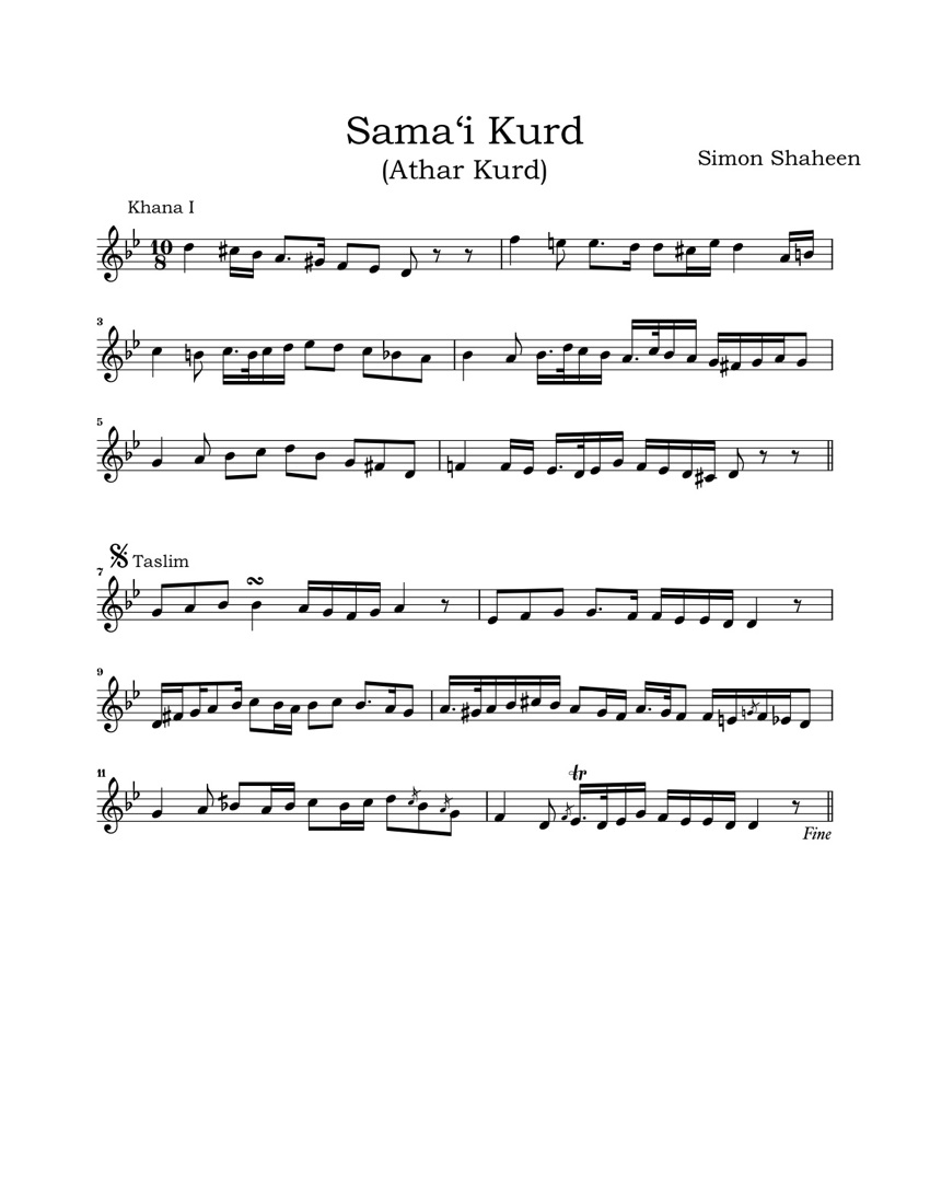

Posts: 2956
[*] posted on 4-2-2011 at 06:09 PM
Simon Shaheen composed a samai in Athar Kurd, it's on his "Turath" cd.
Otherwise, it just seems to be used in modulations, as you have said.
Here is the first Khana and Taslim on Simon's Samai. This should be somewhat representative of the seyir (at least Simon's conception of it).
Simon_Kurd_sm.jpg - 116kB

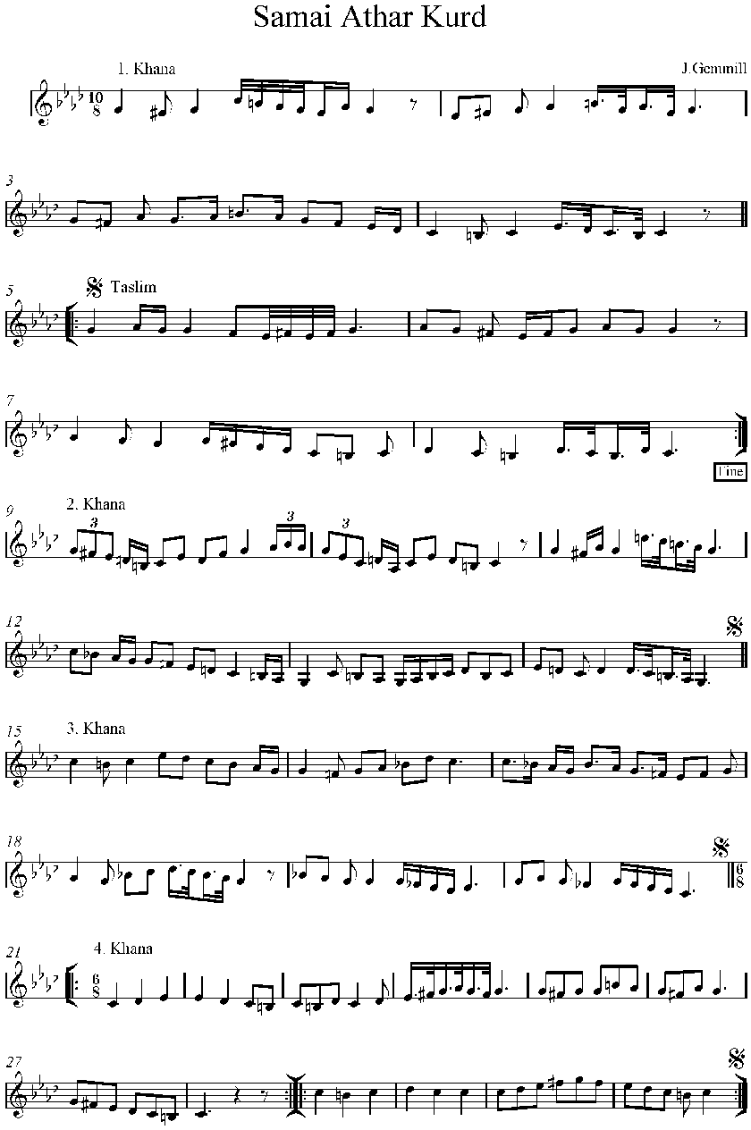

Here is my Samai in Athar Kurd.
The score needs a few lines drawn in, I exported it from Sibelius.
Samai Athar Kurd J.G.bmp - 133kB
