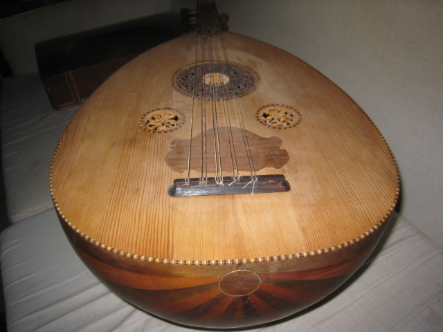

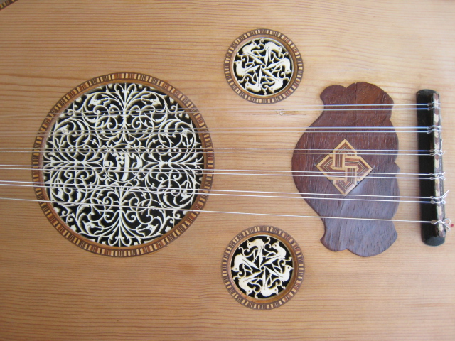

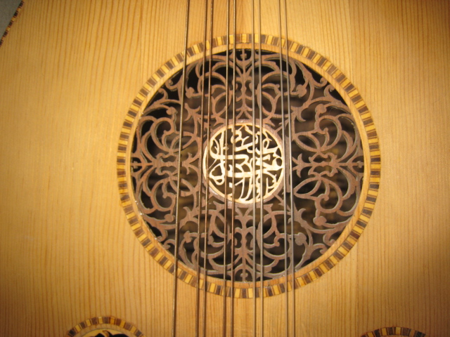

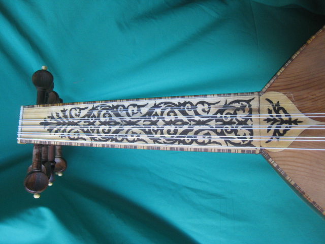

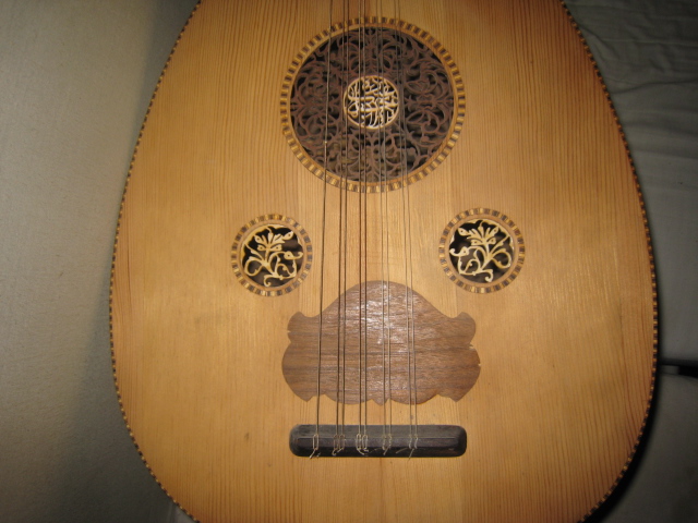

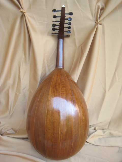

Abdo Nahat 1906: I willn't say original or not original you have to judge
Abdo Nahat 1906 in good quality. 105 years old.NOT AVAILABLE FOR SALE
-Bowl :Walnut&Oak 49.5cmX35.5cm
-Stringlength:61.5 cm
-Big rosette: original of wood&Bone
-small rosettes:original of Bone
-Pegs:Original
N.B: I say the nut is new only.
the sound file come soon.
B.Rds
Abdo 1906 R.jpg - 186kB
Abdo 1906 Label.jpg - 134kB Abdo 1906 Bottom.jpg - 137kB Abdo 1906 F.jpg - 155kB Abdo 1906 B.jpg - 124kB Abdo 1906 P&3R.jpg - 149kB Abdo 1906 R.jpg - 186kB Abdo 1906Pegbox.jpg - 122kB
[*] posted on 5-12-2011 at 03:04 PM
Dear Mr. Ghadban !
You said "you have to judge", so here some questions/remarks/wonderment :

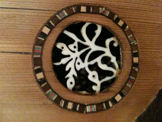

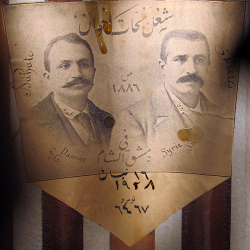

1) How come Abdo makes ouds in 1906 under his label, while Nahat Bro., his partnership with Rofan, was still alive manufacturing ouds & other oriental crafts ?
2) How for heavens could this rose be original ? It says Abdo Nahat & his sons ! Sons in 1906 ? Elias, the elder son of Abdo, was born in 1902, while George the second was born in 1907, so how come they both star on the rosette as associates with their father when Elias was 4 & George wasn't even planned by his parents ? Moreover, it has a major mistake lacking the letter "و" (and) before his sons !
Let alone that the label says Abdo alone. No sons, no associates !

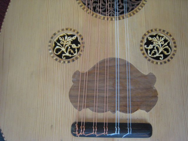

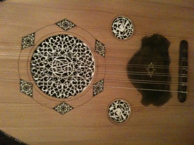

3) Moreover, the small rosette is not Abdo's. See the attached photo of one, assembled on an old oud, 300 $ worth ! I think it's the same hand who made &/or installed both.

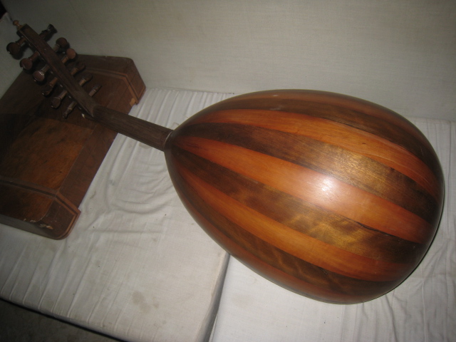

4) The bottom is not sealed as Abdo used to do. This might mean the soundboard is not original, or that it has been detached. It also shows at least two kind of woods, one or two in the edges & another in the middle under the bridge.

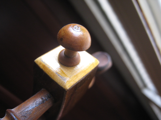

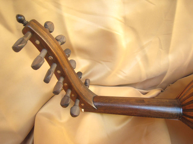

5) Abdo also used to glue a square bone on top of the peghouse, not a nub ! This looks more like Aleppo's custom, not Damascus's.
6) The pickguard does not look like Abdo's 105 years old, unless the oud has not been played for ages, Well, I don't know, I'm not sure about this or anything anymore . It looks more like GHN's pickguard, eventhough GHN's is much more precise, doesn't it ? See the attached photo !

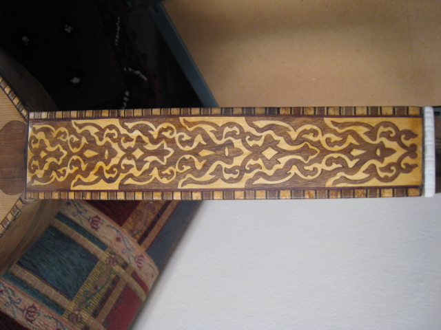

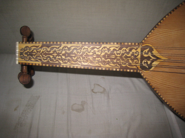

7) The heart/almond-like shape on the end of the fingerboard does not belong at all & does not mach the design of its "father". It's made vice versa, bone on wood (or bright on dark), while the fingerboard is made of wood in bone, or whatever it is, (dark on bright).
These were my remarks after a quick glimpse on the photos.
I don't promise I wouldn't have some more to come afterwards.
Please be brave Ostaz Nazih & say HOW MUCH ?
Why this should always be a super confidential military secret ?
GHN 1 (Small).JPG - 47kB Small Rose (Small).JPG - 48kB

I haven't written my comments in order to insinuate or imply that Ostaz Nazih is cheating here. The man asked for our judgment, and I accepted the challenge & picked up the glove. I have no hard feelings toward anybody, not here nor elsewhere, neither do I carry any bias . I don't know Mr. Ghadban, never saw any oud of his, never bought anything from him & of course never been cheated, God forbid, by him. Therefore I thought I could be as objective as possible.
It's not a multi national contest either between Lebanese &/or Egyptian &/or other luthiers. We don't pay any attention to this issue here, so please keep it this way if you don't mind. It does not matter in this forum's eyes if the luthier is from Afghanistan or from USA or from in between, with due respect to both mentioned. What matters here is the OUD itself, not the belonging of the luthier to this race &/or country.
I hoped to read some more serious posts that would relate to what I've raised earlier, not some not-at-all-funny remarks about mustaches &/or about Egyptian rebel and "buy Egyptian" thing. Buy ya seedy whatever you like ...
What a pity !

[*] posted on 5-14-2011 at 04:38 AM
dear Mr Alfaraby
Dear Mr Alfarabi
I wanted to say that I posted this oud in Buy/sell section by wrong I have tried to transfer it to the ouds,ouds,ouds /section but I didn’t reach that. as I didn’t want to sell this oud .
Thank you for your appreciable feedbacks which export from an expert well-informed and knowledgeable .

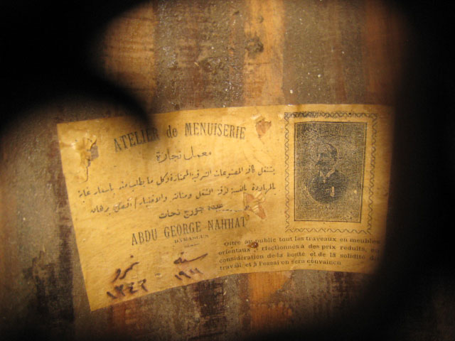

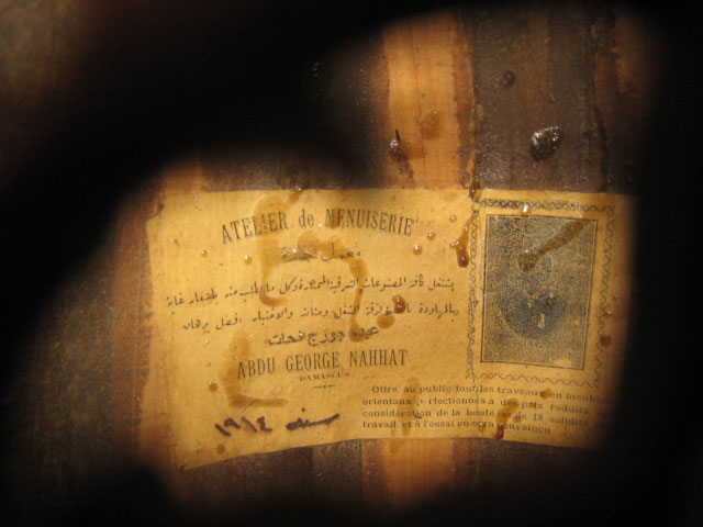

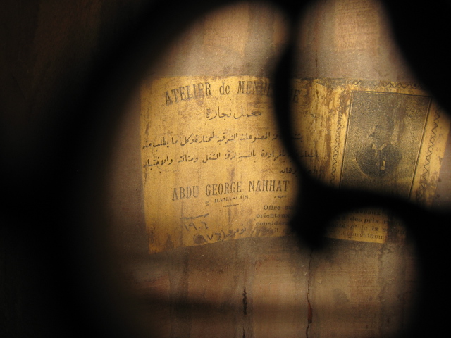

I think the card inside the oud is the true and authentic (Abdo 1906) As I said earlier, there would be no surprise that this oud-making by Abdo Nahat 1906 and not Ikhwan Nahat.if the Ikhwan Nahat dismissed the partnership, as some say between 1900 and 1910 and some also say that Abdo was working in his name in the last period before the separation of the partnership. I would like to say the story of Nahats is not entirely clear that where some of the ambiguities and non-understandable that requires to go to Damascus to Orthodox Archdiocese to verify the dates of birth and marriage and children of Abdo and other Nahat membres. .
The wood rosette section don’t beyond any doubt and clearly show its authenticity.As for the calligraphy of children,there are two possibilities either the bone part is removed although I see something is broken of bone of the letter “ "وor Abdo was looking forward to the day when his sons assisted them by typing their name on the rosette before they practically help him! It confirms my words the kind of old bone used. I think the writing is correct as there is some unobserved modification from a rosette to another made by Abdo as they are hand made.
which confirms the authenticity of the soundboard is the thikness of the soundboard and the Mosaiq at its edge at the edge of the fingerboard and around the rosettes, even the width of the two last ribs of the bowl as well as the small rosettes made of Camel bone, I have seen a lot alike in Abdo’s ouds 1911 and 1914 and 1927 while in the image you show it appears to be drawn from the plastic. (see pics)
I compared the pickguard with other pickguard of Abdo it has the same accuracy. I would like to say that the health of any oud is by the hands which campaign throughout these years, hence you find some aged ouds in poor condition while others are still in good condition.
For the heart I am like you I've seen rougher texture, but it is consistent with the fingerboard.For the end back of the bowl I have seen some Abdo ouds alike. As for the top of the pegbox there is a bone square and a nub over it ,the same I have noticed in Abdo 1911 and 1917.
This oud is an original Nahat in its general shape in its measurement as well as in its great sound

[*] posted on 5-14-2011 at 02:58 PM
Thank YOU Mr. Ghadban. I appreciate your complement & would remember this for days to come.
I agree the label looks authentic, notwithstanding the ambiguities as you've stated. One should trace the numbering they adopted. What does this 947 or so number mean ? I tend to believe Abdo adopted the numbering of Ikhwan Nahat as his, & Rofan did the same, as he kept the numbers going after they've split . Otherwise, how should we explain these numbers when talking about couple of years only working under his own label.
Can't agree with Abdo made ouds while he was still a partner in Nahat Bro. ! Either they worked together or they separated. It can't be that they worked jointly & separately. One can't compete with himself ! In Arabic we call it :
شريك مضارب
Even the authentic documentation of the church is not beyond any doubt, and even more so can't clarify the oud issues we're dealing with . It says Abdo was born in 1865 while we know he launched his business with Rofan, his Elder brother back in 1880. How would one became a luthier when he's 15 ?
Can't accept the suggestion Abdo wrote "hopefully" & Sons before they actually worked with him, let alone George wasn't even born then as aforesaid . First Abdo used to add "his son Elias" to the rosettes, then after George joined in, he started writing & Sons, though George never appeared as a luthier ever after the family migrated to Brazil in 1938, while Elias made his come back after he retired in 1969, leaving us with 100 ouds within 15 years. You may get back to Livia Jacob's research "The Last of the Nahats" to learn more about Elias.
Therefore, Mr Ghadban, one should admit : This rose, even if original, does not belong to this oud. Period. Any other argument should be overruled.
"Plastic" ? Thank you Ostaz Nazih ! Do I sound like who might buy plastic roses ?
Now as to the SOUND : This morning I told a friend that Nazih might blow all what I've written, once he uploads a sound-file with some Abdo ground-to-air explosives !
UNFORTUNATELY you didn't ! What I heard does not sound like Abdo I've seen, heard & played, though I have to admit I haven't seen many, but sure heard a lot.
This is not the "fireworks" one may expect from The Master of all times. Listen to this & compare :
http://www.youtube.com/watch?v=p78NIcSohYc
This argument would continue forever, but one thing is obvious : This oud is not all original, though some parts might be . We should not take out of consideration also that some of the ouds we compare with, might not be original themselves, especially those with the nub !
Once you decide to sell this oud, pls. let me know & quote the price. I want to open it & see its interiors.
Cheers !

I didn’t intend at all to bother you when I said your small rosette appears like plastic
As I doubt from its milk cold color .
Again I am fascinated by your wide knowledge which let me happy by discussing objectively with you.
Generally an Mp3 file sound gives us an idea about the sound as demonstration, it doesn’t give us the complete idea !then the judgment willn’t be right 100% I think we have to listen to the oud lively.
the sound of Abdo 1906 you have listened to is with 5 pairs of strings(without the single C which gives to the sound more bass background) and the Makam was Hijaz Kar Kord which as I think leaves an impression of a sharpness of the sound , I will try to post a new RAST file sound
With Abdo 1906 to know if your impression will be the same or not ! with 5 pairs and one C single of Aquila Light String I added it temporarily!(see pic)

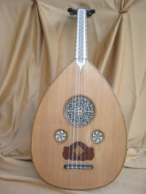

I am proud as I think I am the first oud maker who signs a certificate of my ouds noticing inside all characteristics of that oud(measurement, kind of wood used, serial number,strings,varnish…etc) I admit to you that you have encouraged me to sign a certificate for every Nahat’s oud -at the limits of my knowledge- and my remarks about it (its sound,originality,if there is some repairs and where! ,serial number …..etc).

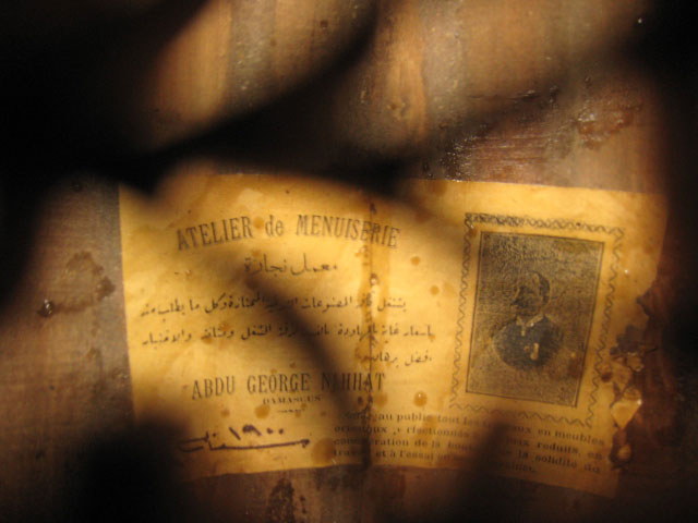

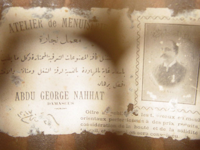

I would like to show you the label of an Abdo Nahat oud 1900 without a serial number,
isn’t Abdo is still in partnership with Roufan in 1900 ? What do you think?
Then the pics of two Label Abdo ouds 1914,1917 without a serial number !!!did Abdo put a serial in some of his ouds and didn’t in other ouds?what you think?
The latest newsworthy that Abdo married twice :) did you know ?

[*] posted on 5-15-2011 at 11:25 AM
Ostaz ! I'm flattered.
I know Abdo married twice. That why he didn't have kids untill he was 35, then had 9 one after the other. His first wife died, so he remarried.
Abdo used to make ouds by order, beside the serial ouds made in the workshop. These ouds weren't numbered since they're unique, kind of off the track ouds if I may say so. These ouds are very rare and might not exceede 20 pieces, or even less. We know about some of these ouds and where they are. You might know aswell : Hamza, Sherif Mohyeddine, Qunia ... etc.
I'd like to meet an intellectual like yourself, but this shall take place in third party country for we both can't cross the borders, though we are 100 km far from each other !
You may sign a certificate, but does this worth ? It's your personal assessment, but not acceptable world wide. See ? We disagreed about almost everything regarding this oud, let alone other Nahats, where we might need the intervention of the UN !! You may sign your own ouds, but not other's.
I shall be grateful if we continue our argument privately, because I doubt if this may interest anybody but us.

[*] posted on 5-16-2011 at 03:07 PM
Quote: Originally posted by Nazih Ghadban
I would like to know your opinion about the second file sound of abdo 1906 (the rast makam)! I think you feel another oud with the Rast Maqam and the single C ! isn't it ?
Well ! I listened to the Rast file in his Excellency's site. It is different quite a bit, but still not convincing as Abdo's great ouds I've heard. The sound-file has been edited, and some effects have been added. One can't judge an oud from a sound-file, whether edited or not. I've heard some 200 $ ouds that sound like a million in recordings, while they're 100 $ live, & vice versa . I do believe the player should play the oud for hours before deciding to own it or leave it. I wouldn't have bought anything without touching ,feeling trying it, not even a shirt, not even a built, all the more so an OUD !
Regardless the effects, I think the basses sound very good, while the C,G strings fail to exploit the maximum from the instrument. Just "Pyramid Lute" appropriate set would derive the best of it. Any other set would be just waisting money in vain !
Another point I thought of about Ikhwan Nahat label &/or rosette : It seems that Ikhwan was some kind of a brand, & by writing on a rosette "Ikhwan Nahat" they wanted to say it's of the same qualifications set by the elder brothers . Hanna, Tawfiq, GHN wrote Ikhwan on their roses. Were they trying to fake something ? Of course not ! They just wanted to say it's like the Ikhwan's oud, the same measurements, the same proportions, the same looks & so forth. Every single oud of these was labeled by the luthier's name inside the oud, trying to tell us: This is Ikhwan Nahat brand , made by Hanna, Antoine, Tawfiq, GHN, etc.
This method has been adopted by Elias Abdo Nahat later in Brazil. He kept writing Abdo Nahat & Sons, 40 + years after his father passed away, saying: this oud is made according to the qualifications & measurements determined by the late grand Master of all times. He used to write on his label that the oud was built in Sao Paulo & indicated its birth date, meaning it was built under the know-how, experience & knowledge acquired under the supervision of the great Master. It's legitimate & desirable, isn't that so ?
As to the labels: I can assure you one of those posted by Ostaz Nazih is forged. Some amateur added Abdo's name in Arabic, in a modern font that had not been invented yet, back in 1914 ! This modern font is a contemporary one, so the label is a mere anachronism. I'd not trust any label, because every photoshop amateur nowadays (well, not just an amateur, a bit higher level :) ) may make any label he'd like. You may find some old paper in an old book, tear it off and here you go, give the order to print, with or without a preview. Take a look & find the changes, but remember : This label does not exist in reality !
Orders for such works can be ordered online through our site for 0.1 cent each :)
This post is dedicated to chaldo, yet I think all there is to say in this context has been already said .
Nahat_Ikhwan Forged.jpg - 158kB
Nazih Ghadban
Posts: 167
Registered: 5-25-2004
Location: Lebanon
[*] posted on 5-16-2011 at 09:22 PM
Dear Mr Alfarabi
Before all: the sound file is without any effect “wallahi”
You are always trying to provoke me, but I will not be shaken as long as what I'm saying is true and is not doubt at all those ouds of Abdo Nahat 1906,1911,1914,1927 are with me before the existence of the computer and the Adobe Photoshop.
Azizi Al Farabi you have said”
I think there is a contradiction in your saying that you have to play the oud to make a true opinion on the other hand you express an opinion about Abdo’s oud 1906 without touching it .I think it is a non-substantive (غير موضوعي (at all.
Regarding the sound of Abdo 1906,this is your own opinion which I respect,but what I feel the sound of Abdo 1906 is quite better and intense and more beautiful than Abdo ‘s oud which you referred to me, I think:
-firstly the taste of the sound is a personal matter
- secondly the role of the musician(player) and his skill
- Third the place of the playing and whether direct or indirect by internet
-fourthly the recording media
I wouldn’t say again what I have said before “Mp3 file sound gives us an idea about the sound as demonstration, it doesn’t give us the complete idea!then the judgment willn’t be right 100%...”
Regarding the labels,I would say and assure all The labels I have posted are 100% true.
And all the types of Arabic fonts(diwani,thoutouth,koufi,Naskh,….) exist before Abdo Nahat I think from the Islamic period before Nine and the tenth century
Here is also a label of abdo Nahat 1911which it is true 100%.
love &Respect
Nazih
Abdo-1911-LL.jpg - 59kB

[*] posted on 5-18-2011 at 10:02 AM
This is very funny and nonsense
The Label of Abdo Nahat 1914 is original 100% :wavey:
Salamat
Nazih
