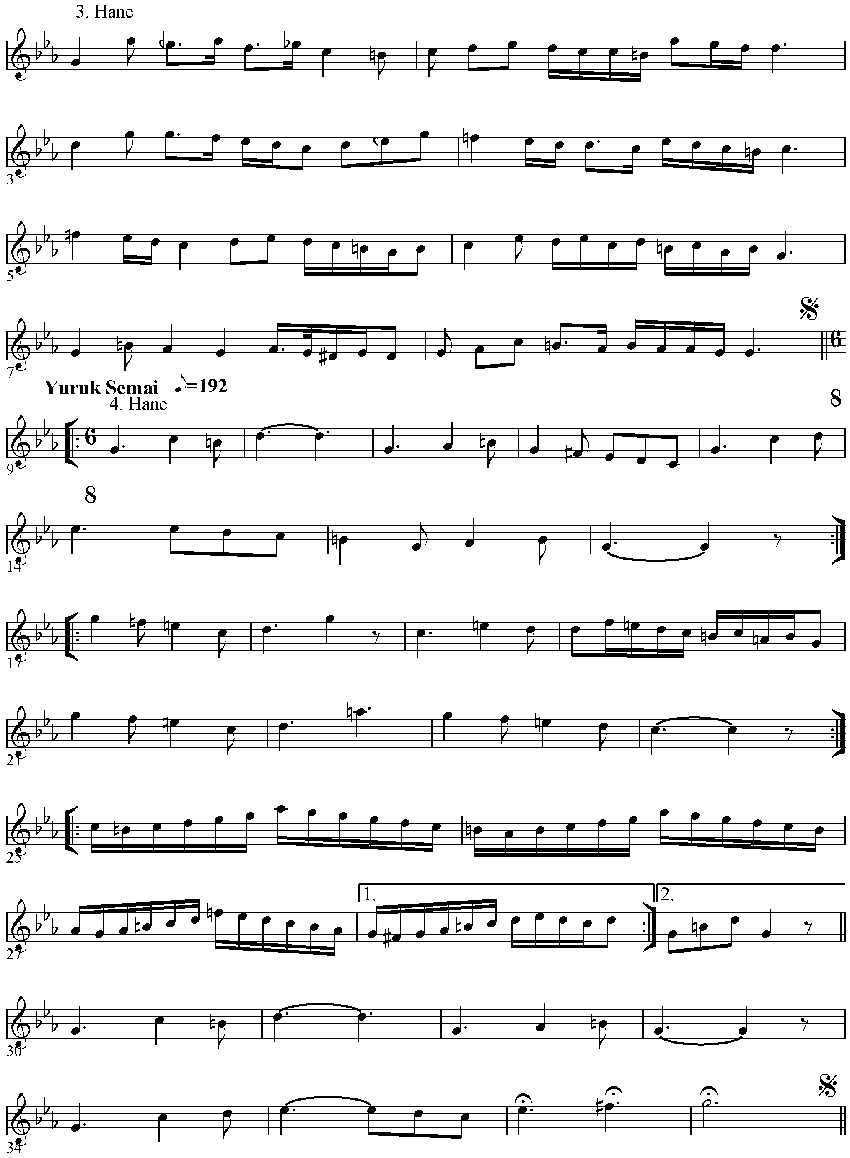

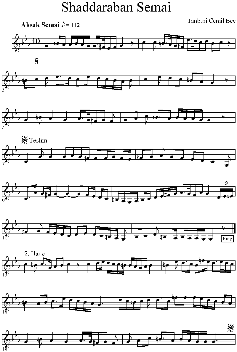

I have an Arabic transcription to Shad Araban from Re
Attachment: samai-shad-arban-D.pdf (122kB)
This file has been downloaded 524 times
Jono Oud N.Z
Posts: 1124
Registered: 12-14-2009
[*] posted on 6-21-2011 at 03:39 PM
There are some problems with the 'D' version of the piece.
Maqam Shadaraban begins on the high octave and descends to the low octave eventually. This chart begins on the low octave..
Also Shadaraban is in nawa/yekah in Arabic tuning not dukah. Here is my transposed version in 'G'.
Sorry, some of the lines didn't come out properly when I exported the score from Sibelius.
Samai Shadaraban - Tanburi Jamil Bey 1.bmp - 116kB Samai Shadaraban - Tanburi Jamil Bey 2.bmp - 122kB
Posts: 771
[*] posted on 6-27-2011 at 09:06 PM
Yeah, the version in D has some errors. In D, the maqam is technically Shahnaz, but the name of the piece can't change even though its transposed. I also like it in G. Thanks for your trascription.
