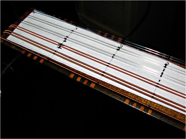

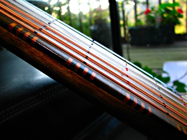

There are lots of ways to mark "fretlines" but all of them suffer from parallax if you mark the edge of the neck. If you use stickers to mark the fingerboard, they interfere with the strings/sound.
On the oud, if you are playing Maqamat, no markers based on Equal Tempered scales are "on", because 1) Even the fundamental positions change depending on the Maqam you are playing in, and 2) You must play by ear.
I'll grant you that at first, markers are not all bad, they can help you figure out where to finger "commas", but please heed my caution notes! The best way I found at the very beginning was to mark the strings themselves. The technique I used was to wait for the string to be stretched and stable, then print a template with the free WFRET program. You can get it here:
ftp://mimf.com/pub/wfret.zip
Be careful to do this correctly, with YOUR exact scale length. You only need to print the first 9 "frets". After you've triple-checked your data, which will look like this for 615 mm scale
Scale Length: 615.0 mm
Fret Number mm from Nut mm from Fret
1 34.5 34.5
2 67.1 32.6
3 97.8 30.8
4 126.9 29.0
5 154.3 27.4
6 180.1 25.9
7 204.5 24.4
8 227.6 23.0
9 249.3 21.7
you print the graphical version, wide enough to slip it under the strings on thick paper. Check it and align it carefully. Then you can put marks on the strings, in a little ring so it doesn't rub off immediately, or mainly on the side you look down on. On fat strings, there is no rotation, so you can even make them almost invisible from the front. There are different felt pens you can use.
img_4236xm.jpg - 79kB Img_4297m.jpg - 88kB
The strings will not stretch enough to affect the markers if you have given them time to stabilize. As these marks wear off, you will find you don't need them any longer.
When you change strings, and refresh any coating on your fingerboard (if it's a soft wood that needed a coating), you can wash off any ink that has rubbed off into the fingerboard.
One SERIOUS word of caution. The proper way to hold the oud is on your right thigh, with the face nearly vertical, meaning you don't look at the fingerboard. DO NOT hold the oud all wrong to concentrate on the marks, or 1) You will acquire a very bad posture that you will then have to struggle (a lot) to unlearn and 2) You will not be hearing what is important. Our equal tempered tuning is an ugly compromise. If you play Ajam, which is close to a C major scale, the third note is not exactly on the equal tempered E. Listen to how much more beautiful it is played correctly, a hair flat, ESPECIALLY in a chord.
Please accept the truth that you should be playing by ear, and only use the markers at the very beginning. Even if you are playing chords, being a little off as you learn is not as big a problem as approaching this beautiful instrument all wrong. :D
