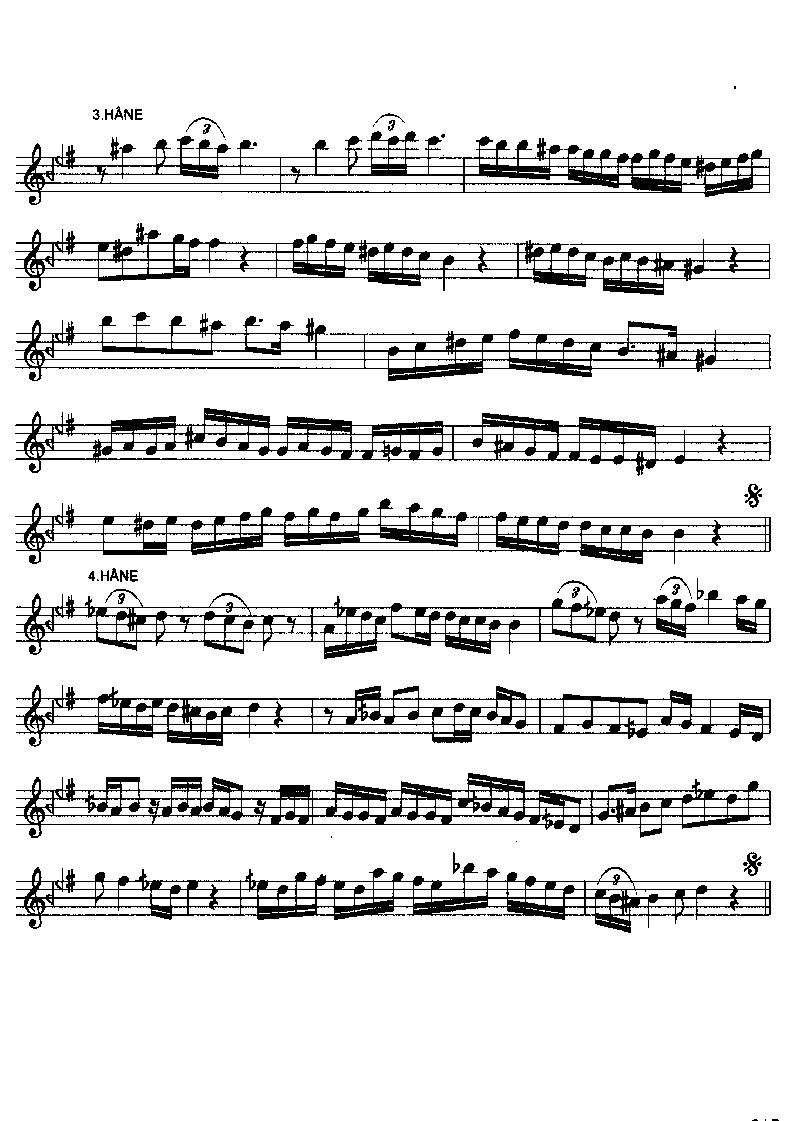

It is funny that we are puzzled by the same issues, and read the same sources ;) (Murat Aydemir guide is very useful, even though there are some inconsistencies)
About the HijazKar semai, I'm puzzled too by the modulation in the third Hane. But it might be simply an imprecision in the music notation (do we have other sources for this score?).
I recently came across a similar issue with the famous Nihavent Semai of Mesut Cemil.
According to the Arabic transcription found here :
http://www.issaboulos.com/archive/index.php
the third Hane starts with a rather obscure maqam on Busalik. If you look at the Turkish version here :
http://www.neyzen.com/nihavend.htm
this sentence is clearly in Makam EvcAra /Zirguleli Hicaz transposed on Segah.
I looked closer at Hane 3 today. Think I've wrapped my head around it but it took some time. For Arabic notation it looks to be technically correct though the A slash flat next to the G# really throws me off. It can better be notated as A natural but this doesn't really get the point across that it's basically a kind of transposition of makam Evic, down one whole tone. Here is a good example of Turkish 9-koma notation winning the prize ;)
So half of hane 3 is this weird Evic transposition I've never seen it before and it must be special to the composer (when was Nedim al Darwish alive actually? Anyone know his dates?). It is Hane 3 after all and the time to show off his chops. Next half of the hane is obviously makam Kurdilihicazkar.
I re notated the piece to Turkish notation, it's a fun one, check it out. See attached.
Adam

Adam, I'm confused by your confusion!
I don't see any significant difference between your 3rd hane and the Arabic-notated one. The slash-flat in Arabic notation is (more or less) equivalent to the backwards flat you use . . . what else is different. I understand that the intonation might be slightly different with an Arabic performer, but the conception of the maqam seems the same, no?
Notating it as A natural would probably be closer to the Turkish Evic in pitch, but not in conception.
I'm not too versed on the Turkish names, an Arab performer would likely call this a modulation to Sikah on A half-flat. IMO, the more confusing thing is the descending part with F - E - D# - C - Bb - A/b.

I was wondering if the maqam is Awj Ara (Evcara) on Segah (Ed) and falls to Segah on Tik Hisar (Ad).
This would make more sense with the Turkish raised Segah third than the Buselik one.
(The reason I mention the raised Segah is that if the pitch is played as Segah in Arabic intonation it is too flat for Hijaz type maqamat).
The third of Hijaz was a major third up till the mid to late 1700's, as recorded in the Cantemir book. (The second was also a neutral second, but this only exists today in Iran and in Turkish 'Gypsy' music).
The second and third were both flattened, probably to make the large interval sound smoother.
This is related to Byzantine music.
(Sorry if I have repeated myself a bit about this issue).
The Ad going down to E is nasty, the perfect fourth makes much more sense.
Maybe for Arabic style performers, the idea would to play the third (of Hijazkar) as Buselik as normal apart from alternating to Segah in the third Khana.

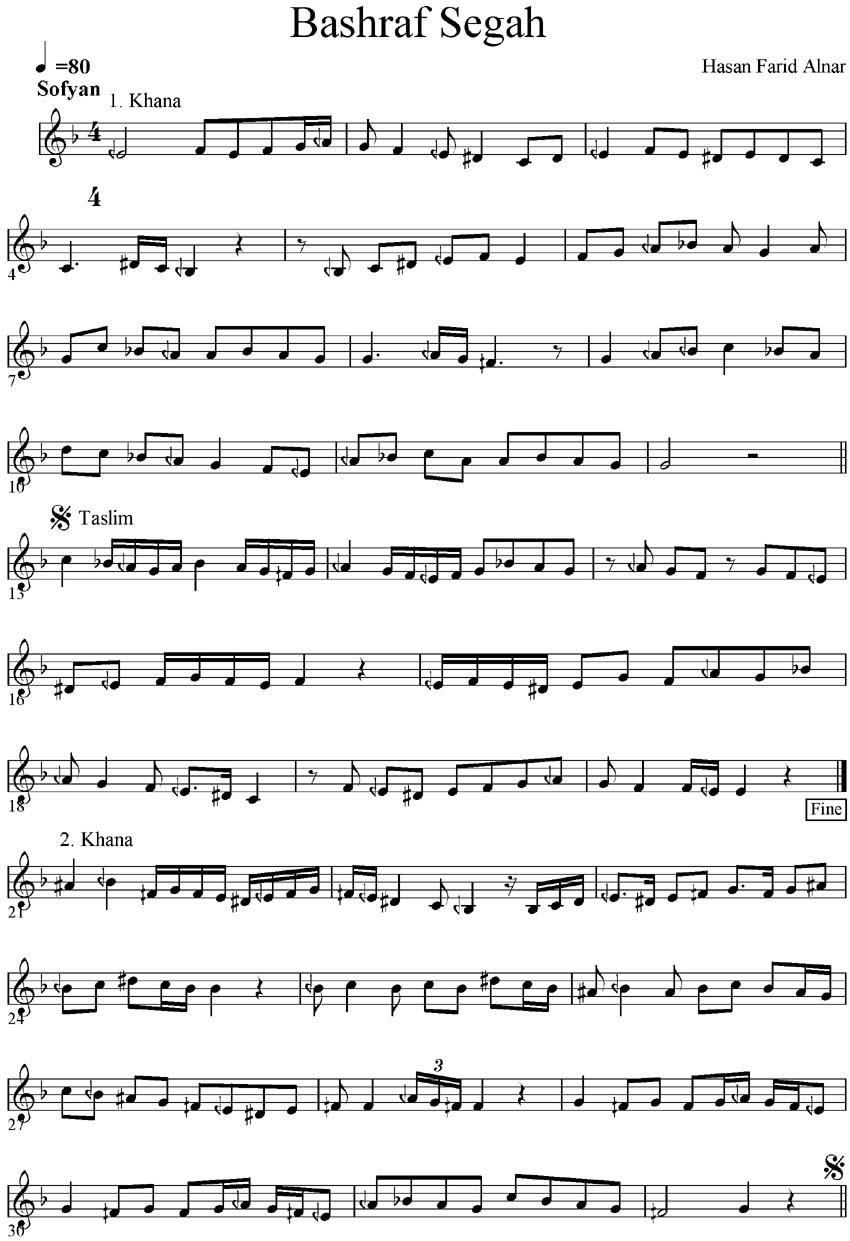

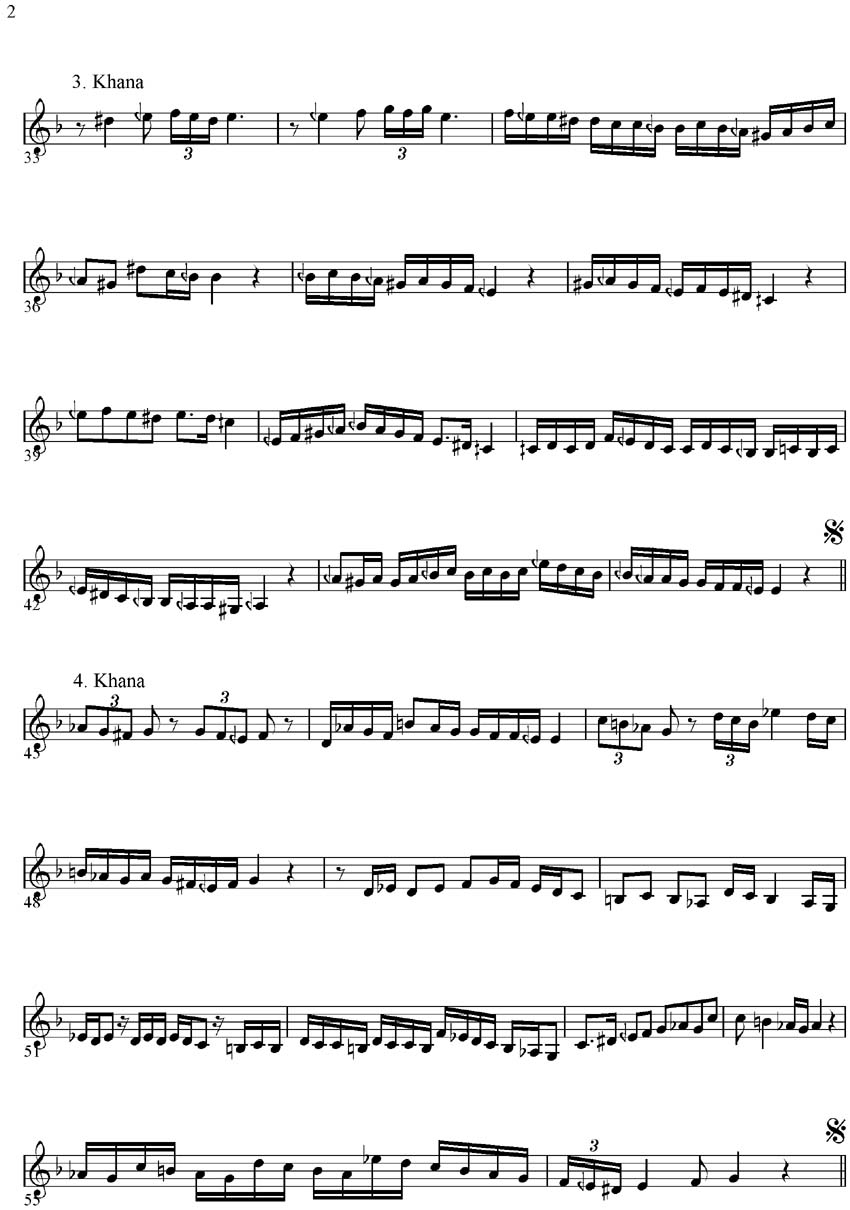

Check out the modulations in the third khana here:
I am interested in the modulations here, I have a couple of ideas but...
Here are the Turkish and Arabic notations.
They relate to those in the Hijazkar piece.
(By the way, I am using Sibelius and do not have the flats with the slash available, previously I would write them as flats and draw the slashes with a pen and photocopy, LOL).
(I have edited the transposition again recently too).
segah_p_hasan_ferit_alnar1.gif - 24kB segah_p_hasan_ferit_alnar2.gif - 22kB Bashraf Sikah Alnar_0001.jpg - 160kB Bashraf Sikah Alnar_0002.jpg - 133kB
