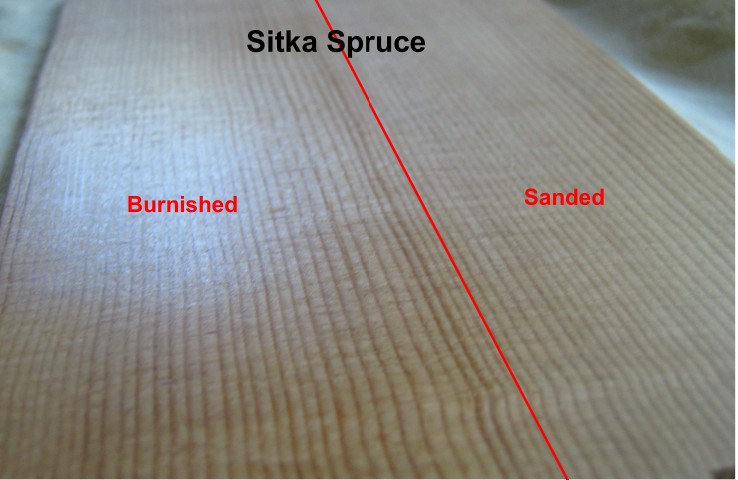

Curious about the practicality or otherwise of burnishing a sound board a few trials have today been undertaken.
Using a sample of quarter sawn Sitka Spruce the surface was first sanded to a smooth finish with 320 grit paper. One half of the sample was then
burnished with a raw silk cloth and also a small smooth piece of wood (spruce) - rubbing vigorously in the wood grain direction.
This resulted in a polished surface that was - in turn - somewhat resistant to absorption of a water droplet. A water droplet left on the surface for
several minutes and then blotted dry showed some moisture absorption and consequent localised 'raised' wood grain but this - on drying - was easily
corrected by re- burnishing.

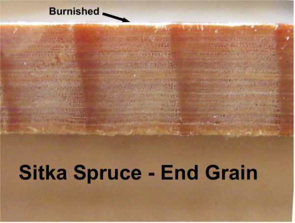

The burnishing operation seems to compact the wood cells at the surface but does not seem to spread any resins (softened by the slight heat generated
by friction?) contained in some of the cells (at the surface) in a uniform manner as would be the case with a varnish coating.

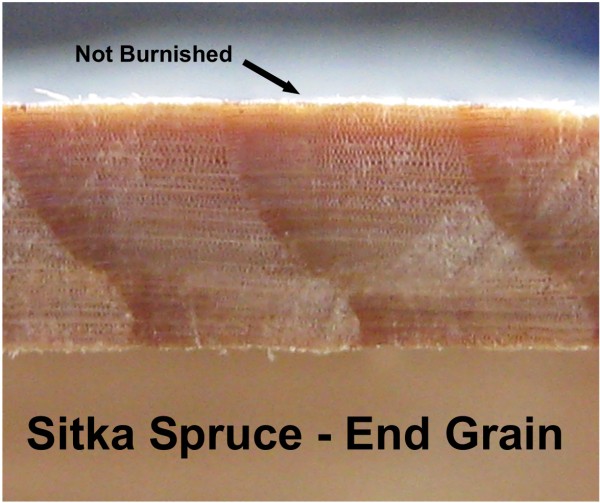

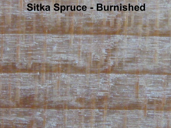

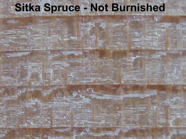

Here are some macro images of the unburnished and burnished samples of Sitka Spruce - end grain and normal to the surface for comparison.

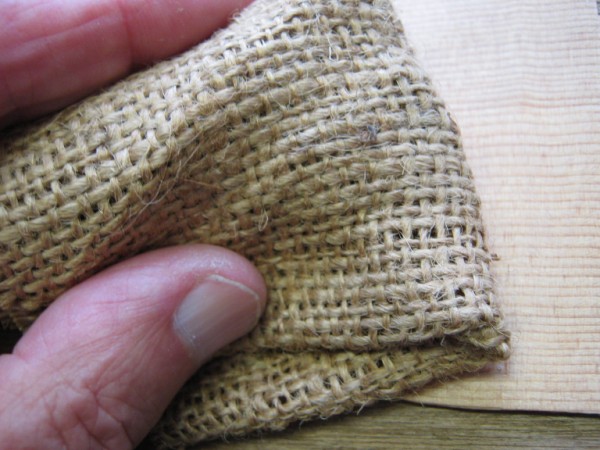

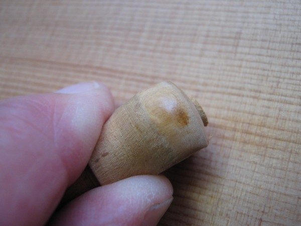

Both hard and soft burnishers were tested - boxwood, burlap (sack cloth) and raw silk cloth. The boxwood burnisher gave the shiniest results quickly
so is probably the way to go. A hard burnisher must be very smooth and well rounded and used with caution to avoid scoring or marking the sound board
surface.
(The makeshift burnisher shown here is the head of a boxwood peg blank)

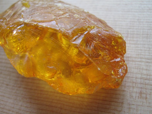

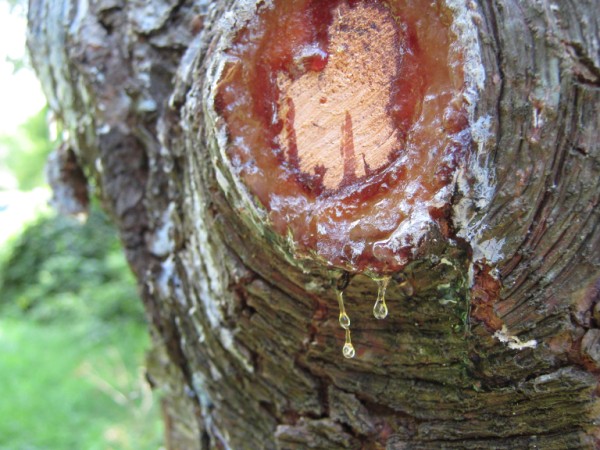

The attached image shows a sample of raw resin of Northern White Pine on my property naturally exuding from the tree to seal a wound - in this case a
cut branch.
The second image is a piece of of refined Rosin - transparent amber coloured and brittle. This is the basic resin ingredient for varnish making. I use
Rosin - diluted in alcohol - as a flux for soft soldering metals. I have never tried it as a varnish so out of curiosity will now run a test to see
how it turns out.

The dark areas visible in the end grain macro images of Sitka Spruce previously posted are minute latewood cells not resin deposits. The lighter but
still barely visible cells in between are the larger earlywood cells.
The burnishing process would appear to work by compressing cells on the surface of the wood - the smaller the cells the greater degree of polish,
Hence the greater shine apparent in the burnished surface latewood cells compared to earlywood cells seen in the previously posted images. The finer
the grain of a wood the more uniform and higher degree of polish produced by burnishing - very fine grained sound board woods often being
preferred.

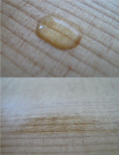

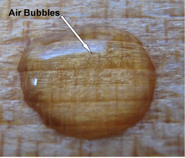

A drop of water was applied to the surface, allowed to stand for 30 minutes, and was then 'blotted' with a paper towel. The damp surface after air
drying showed no sign of 'grain raising' or residue or staining. Another test with a drop of mineral oil showed staining after the oil was wiped off
indicating absorption of the oil into the wood cells.
An enlarged image of the water droplet shows air bubbles in the exposed but compressed early wood cells - a typical feature found in the earlier
experiments with egg white foam distillate. It is thought that the distillate retained in the wood cells forms a molecular film around air trapped in
the cells by the water preventing further absorption of the water into the wood.

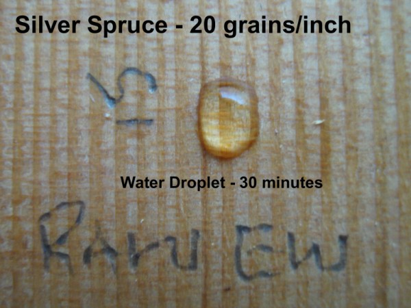

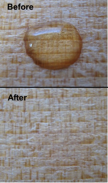

Searching through my wood scrap box turned up another test piece from the egg white foam distillate trials - this time a piece of fine grained
(quarter sawn, 20 grains/inch) Silver Spruce with one part coated with raw egg white and the other with egg white foam distillate. Both surfaces were
burnished to a shine with a boxwood burnisher and tested with a water droplet for absorbancy. The attached images show the water droplets after 30
minutes. The droplets were then removed with a paper towel. After drying the locations of the droplets were still visible as dull marks. These dull
areas were restored to a full shine by further burnishing.

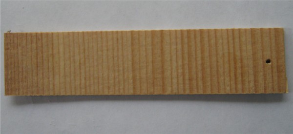

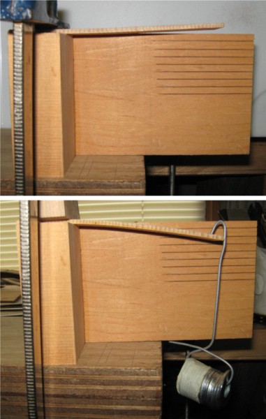

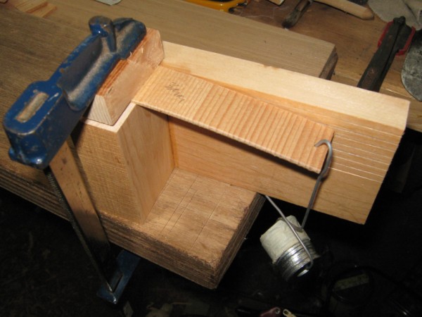

To test the effect that mechanical surface treatment (burnishing or scorching) might have on sound board material a basic test rig has been set up -
sample strips of quarter sawn Sitka Spruce sound board material 25.4 mm wide (1 inch) and 2.6 mm thick clamped at one end and a 100 gram load applied
at the free end the deflection at the free end being measured against a scale (5 mm spacing) marked on the side of the test rig. The overhang between
the clamped end and the load is 85 mm.
This arrangement - for the technically minded - is a simple cantilevered beam (i.e. the test piece) where the deflection of the free end is a function
of the load, the area and geometrical section of the beam, the length of overhang, and the modulus of elasticity or 'Young's Modulus'. Young's Modulus
is a measure of the stiffness property of a material so that a low value means that a material is less stiff than a material with a higher value. Low
stiffness equates with a greater beam deflection.
The environments tested were:
1) no treatment
2) burnished upper surface
3) lower surface scorched at 150° F (65°C)
4) lower surface scorched at about 450°F (232°C)
Measured deflections after 24 hours (to achieve stability) were:
1) 2.5 units deflection.
2) 3.0 units deflection
3) 3.75 units deflection
4) 5.25 units deflection
As all else remains constant except the stiffness of the wood it can be concluded from these results that any form of mechanical surface treatment

These trials measured the effect on wood samples that were uniformly heat saturated to the extent that minute pockets of resin in the wood were melted
and drawn to the surface. So the next question is if the heat is very quickly applied in a random, non-uniform manner does this result in stiffening
of the wood? The answer is no it does not. A further test with a 5 mm wide light scorch mark down the centre of the test piece gave a deflection
under a 100 gram load on the test rig of about 4.25 units after 24 hours. This is a greater deflection than test piece #3, previously reported, that
was uniformly 'scorched' to a temperature of 150°C.
Clearly there may be some variables in the methodology that might affect the results to some degree - particularly Relative Humidity (greater RH =
greater deflection?). However, the measured RH during these trials has remained in the range 72% to 77% so this should not have greatly affected the
outcome if at all.
It is anticipated that a similar but reduced permanent softening will also occur along the grain (i.e. along the length of a sound board) so will test
that theory next.
A retest has been carried out on the 5 samples by applying the 100 gram load and measuring deflection after 24 hours and the recovered no load
deflection.
Interestingly the heat treated and scorched samples that were softened to the point that they permanently yielded under load (and so did not return to
their original zero deflection unloaded) when subjected to another loading cycle only deflected the same amount as the untreated sample.
So, for example, the deflection of the untreated sample was 2.5 units under load - returning to zero deflection unloaded.
The original 'scorched' sample #4 after loading had a permanent set unloaded of 1.5 units. When this sample was cycled with another loading of 100
grams, the sample deflected only 4 units after 24 hours and then returned to its unloaded deflection of 1.5 units - total deflection 2.5 units, the
same as the untreated sample.
It might be concluded from these limited test that if a softened 'scorched' sample is loaded beyond its yield point it then becomes stiffer - at
least, returning to its original untreated stiffness.

To complete these brief trials a sample (same dimensions as samples previously tested) was prepared from the the same piece of Sitka Spruce sound
board material - this time with the grain running along the length of the sample rather than across. This represents a measure of stiffness along the
length of a sound board.
Under a load of 100 grams the untreated sample deflected about 0.25 unit compared to about 0.5 unit deflection when the sample was scorched. So - not
unexpectedly, despite the small size of the samples - this indicates, from the deflection measurements, that the stiffness along the grain is
significantly greater than stiffness across the grain for both untreated and scorched samples.
