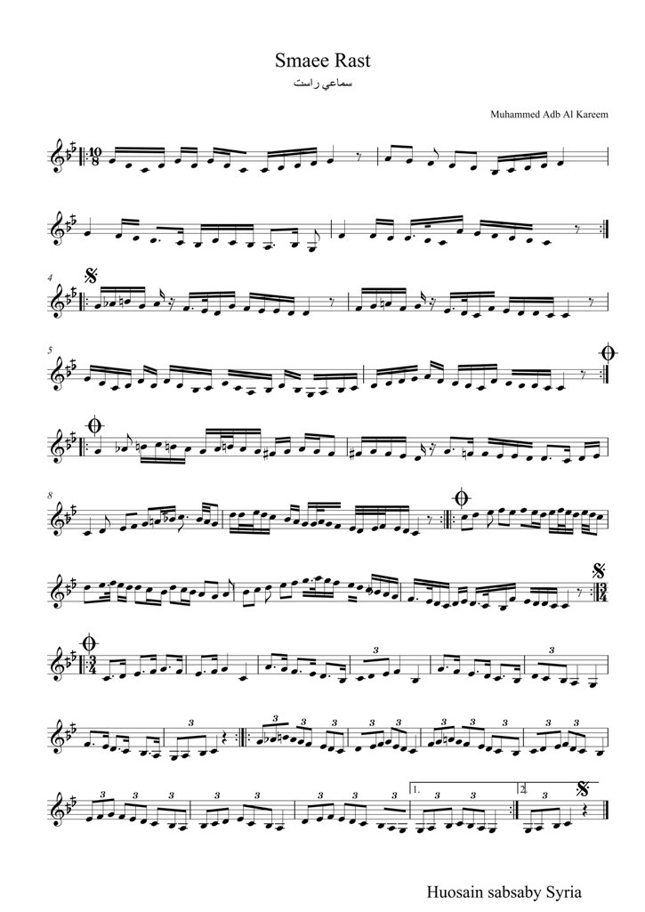

00:00 This is Samaee Rast by Mohamed Abdel Karim. I can see/hear differences between George's track and the score. I'll study it next...
A huge :applause: and :bowdown: to Husain Sabsaby, and if you don't mind I put the score here. Also, it's an extract from : "Composition by famous oud players of the modern age, Silh al wadi institute" by Husain Sabsaby.

Is it me, or the staff notation? I don't understand why it is written 4 above the G clef. 5 should be written instead of 4 and 7 instead of 5, am I right? If I am, what GA (George Abyad) plays is written between the 5th and 8th measure, twice. The 6th measure starts on F and GA starts on E-b- with the same pattern. GA's version is also different at the 8th measure. In both case GA exclude the note A (natural). So, I think it is voluntary in order to keep the Hijaz tetrachord on G.

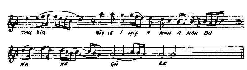

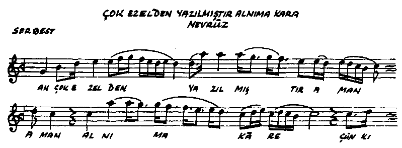

'Nairuz' was originally a 'maqam' that was only a pentachord to start with (D, Ed, F, G or G, Ad, B, C), this later evolved into a full maqam, later called maqam Ushshaq.
The 'Zebek' article explains this.
Here is an old anonymous piece in Nairuz too.
Maqam Nairuz itself is jins Nairuz above jins Rast, although I have never seen a composition actually composed in the maqam itself.
It is a very common modulation though and can often lead on to Saba on G afterwards.

This file has been downloaded 488 times cok_ezelden_yazilmistir01.gif - 8kB cok_ezelden_yazilmistir02.gif - 7kB

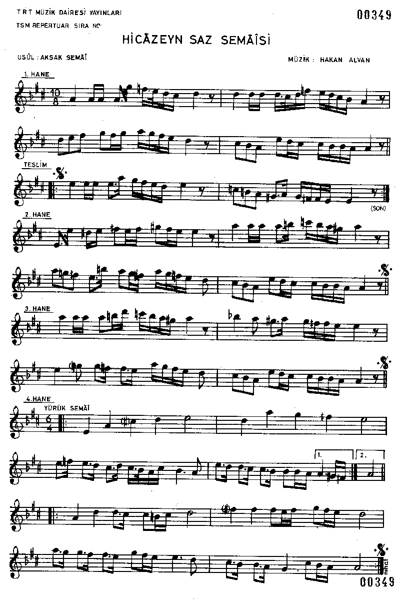

Concerning maqam Panjgah:
'Cantemir considered the makam Pencgah to be a compound of Nisabur and Rast:
'This makam is produced by three secondary scale degrees and one basic scale degree. The secondary scale degrees are acem, uzzal (hijaz), buselik. The basic scale degree is rast'.(Music of the Ottoman Court.)
When the F# appears, the Enatural replaces the Ed in maqam Panjgah. The upper part of Nishabour is usually G, A and Bb. So, the basic sayr of Nishabour is: G, A, Bb, A, G, F#, E. This is blended with maqam Rast in Panjgah. In the final descent the F replaces the F# and the Ed, the Enatural; concluding with maqam Rast.
Here is a classic piece that illustrates this.
Panjgah is also a useful link between Rast and Nakriz as also shown in the composition.
Nawa Athar seems more likely in the Samai though.

Attachment: pencgah_saz_semaisi_i.pdf (48kB)

I have read that modulating from C maqamat to D maqamat and similar modulations is not generally accepted.
I've read the same thing. On the same CD you have a modulation from Nakriz to Hijaz: track 7 at 00:31. But I read in AMTMP that Hijaz is so strong in Nakriz and / or Nawa Athar that one can quickly module to Hijaz.
Then, after learning pieces in maqam Ushshaq, I found that there is a b7 Rast jins emphasized underneath the Ushshaq jins.
In Turkish music this emphasis separates Ushshaq from maqam Bayati, also Ushshaq descends to a lower Rast on G below the tonic too.
Do you think that is the case here? I do not feel a lower Rast on GG... And what about Gb? Is it usual to use this note in Ushshaq? I'm not sure, but I think Bayyati is unfolding from A to the note C at 02:10 and we are back on Rast at this moment. So it's about 10 seconds of Bayyati.
So, it seems that a full modulation between C and D maqamat, etc is not common, but these do seen to represent temporary stopping points or suspended cadences.
I feel it like that at 02:45, a suspended cadence on D (you have a qarar too), what do you think? These concepts of suspended cadences and pivot-notes are brand new for me, I used to focus on notes out of the scale.

The Nakriz sound in Hijaz is the b7 'chord' beneath the tonic.
The Hijaz jins a tone above the tonic in Nakriz is the equivalent in reverse.
I have never actually heard a full modulation between these though (e.g: a piece or taqsim in Nakriz linking to one in Hijaz), where as the shift from Rast to Ushshaq and Bayati does occur sometimes.
The differences between Ushshaq and Bayati are explained here:
http://www.youtube.com/watch?v=fBOizia1tZg
Traditionally, maqam Bayati does not have a focus on the Rast jins on b7 (C) under the tonic, but this is very common to Ushshaq.
This would make the transition to Ushshaq more likely traditionally. The lower Rast on G jins is not always present.
In Bayati, the main sayr is; G, F Ed, D (descending).
Here are two pieces that illustrate the differences.
Often Syrian and Egyptian (etc) musicians play Bayati-Ushshaq as one maqam these days (Bayati).
Older Arab archive recordings reveal the differences though.
In Turkish music the separation is more pronounced.
The Gb is a taste of Saba off Ushshaq / Bayati

Jono Oud N.Z
Posts: 1124
Registered: 12-14-2009
[*] posted on 8-30-2011 at 07:55 PM
Quote:
And what about Hijazayn, since the finalis of the modulation is D
I am just looking into maqam Hijazayn.
This maqam was created by the famous Ottoman Sultan composer Selim III (1761-1808).
'Hijazayn' means 'double Hijaz.'
http://www.donjuanarchiv.at/veranstaltungen/symposia/symposia-2008/...
This maqam begins with Hijaz and ends on Hijaz on Usharyan (low A).
Interesting maqam...:cool:
hicazeyn_ss_hakan_alvan.gif - 26kB
