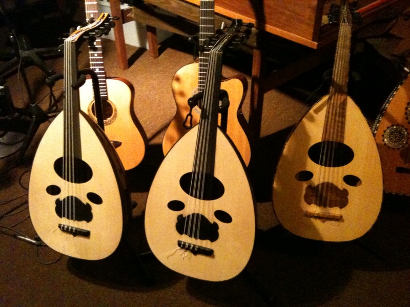

I have a Model 14 (i.e. a 214) and a Model 212 (i.e. a 12). In dimensions and bracing they are very similar if not identical, a 600 mm scale oud with an embedded (i.e. not glued on) long ebony fingerboard, with the same unfinished spruce soundboard, pegs, bridge, neck, neck adjust mechanism, etc. They were made around the same time. The finish is different, the 14 being stained black then Shellac'ed, whereas the 12 is just Shellac'ed ("French Polished"). I treated both soundboards with raw egg white at the same time, the same way. The same strings were then installed, Daniel Mari basses with PVF (Seaguar) trebles. The main difference is the bowl, with the 14's ribs being what appears to be ebony (more likely than the advertised "black oily walnut", though nobody who's looked at it is 100% certain). The 212 uses ribs of a greyish medium dark walnut with very pretty light purfling. The Model 1 that I no longer have was a little different, being 615mm scale with other woods and differences, but looking at THESE two (on the left) they seem to be twins in different garb.
oudphoto1.jpg - 157kB
When you pick them up, the difference in weight is a surprise, with the black 14 being substantially heavier. I can't measure it, my good scale tops out at 100 grams ;-) Then the next surprise, is how different they sound. The 212 is bright and sounds great uptuned. It can sound semi-Turkish when the action is lowered. The upper midrange is very strong, it sparkles. The 212's maqam of choice would be Ajam, and it sounds great playing major chords. The 14 has a stronger bass and a more Egyptian timbre, with a bit of that percussive "slapback". It invites raising the action and letting it sound very deep and melancholy, very Saba. I tried adjusting the action to try making the two sound more alike, and couldn't. They are hardly twins, and I love it like that. Each oud's personality affects what you play/improvise on it. Some moods are more suited to one or the other.
But returning to the belief that the bowl wood has little or no effect on the sound, I just can't see what else is so different about these two ouds; they share the Sukar sound, but diverge quite a bit. I've scratched my head a lot over this. I just don't see another explanation. And intuitively it makes sense. As soon as you pick up that 14 you sense it's a "deeper" or "heavier" oud than the 212.
I can't remember who, but one of our oudies here had gotten a 212 and I'd described the timbre he might optimize for. He had tried different strings and tweaks, only to arrive at the same conclusion.
BTW, the Model 1 I had, although a hair different, having the same sized body but the scale being 15 mm longer, and very different woods, was otherwise very similar to the other two, yet it was a different animal again, with a specific amazing strength in the midrange, practically capable of knocking reptiles off the walls. Strongly playing that A Huseini above the second course gg Neva would practically shake the oud out of your hands. Being to the point and quite loud it's eminently suited to a specific market.
Anyway, until further evidence, I have come to believe that the wood of the bowl surprisingly can have much more effect on the timbre than most oudies will tell you.
