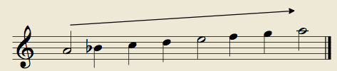

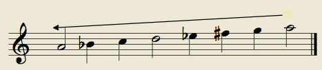

I have some scale in mind that i would like to transform into a makam system, so i wanted to know if there's any makam called like that in the turkish makam system.
simply its a blend of "saba zamzam" (from arab maqamat) makam and kurdi makam
the main makam is kurdi but the conclusion of the makam ends with a hicaz on the fourth degree...
Example:
Screen Shot 2012-02-28 at 7.50.36 PM.png - 12kB Screen Shot 2012-02-28 at 8.00.37 PM.png - 12kB

Saba Zemzeme is a fairly rare makam in Turkey, but I think it is legitimate within that makam to play normal Kürdi as an internal modulation, so I would suggest simply calling it Saba Zemzeme.

yes.. i know.. in turkey there isn't such makam, and i ment to do mainly a kurdi makam and the modulation will be hicaz tetrachord on neva (4th degree)

This seems more like a "shuri zamzam" if I can make up a name.
Shuri is Bayyati + Hijaz, you have Kurd + Hijaz.

i was all wrong, i messed it all up.. saba has the hicaz on the 3rd degree, and i ment on the 4th degree....
just look at the images i uploaded at the first post..

you can see it as nikriz on cargah (3rd degree) it would be even more precise..
Posts: 2956
[*] posted on 3-1-2012 at 06:17 AM
What you've written looks like shuri (karcigar), but with kurd for the second degree instead of sikah.
