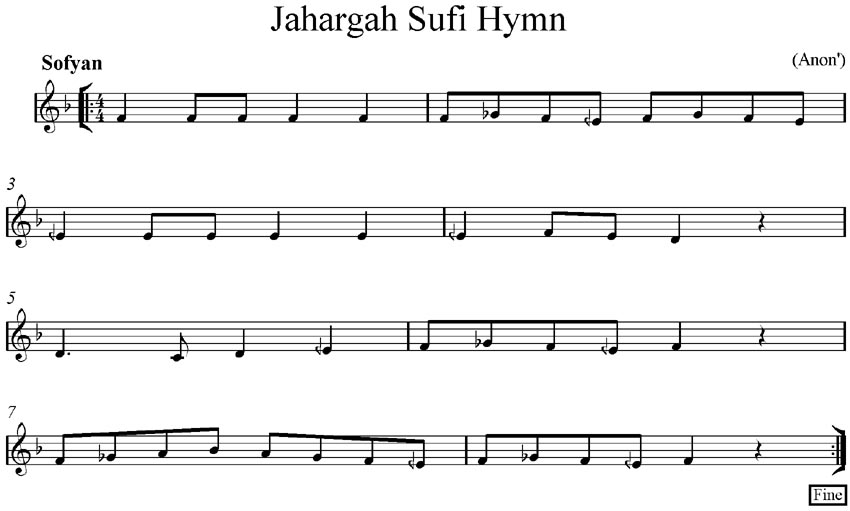

The other Cargah is like Saba but concluding on the note Cargah:
Jahargah Sufi Hymn.jpg - 57kB

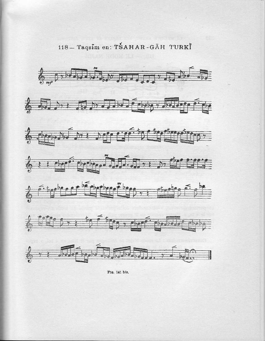

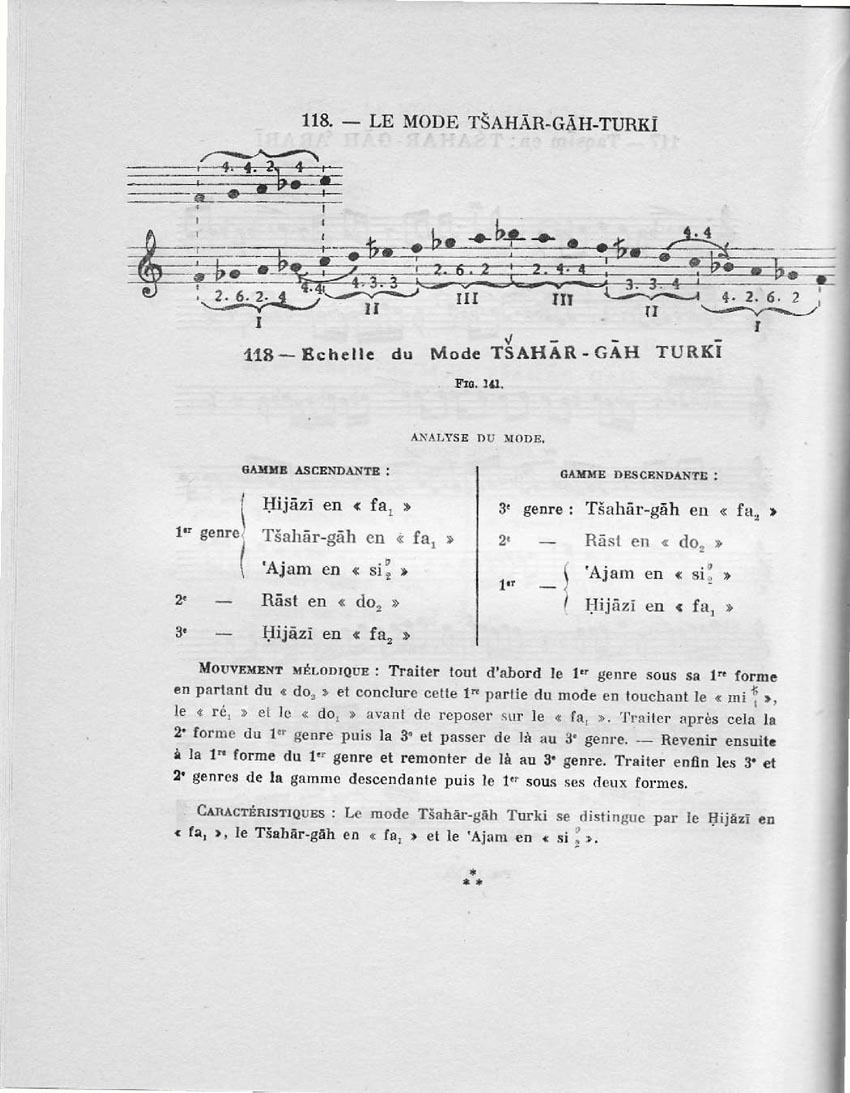

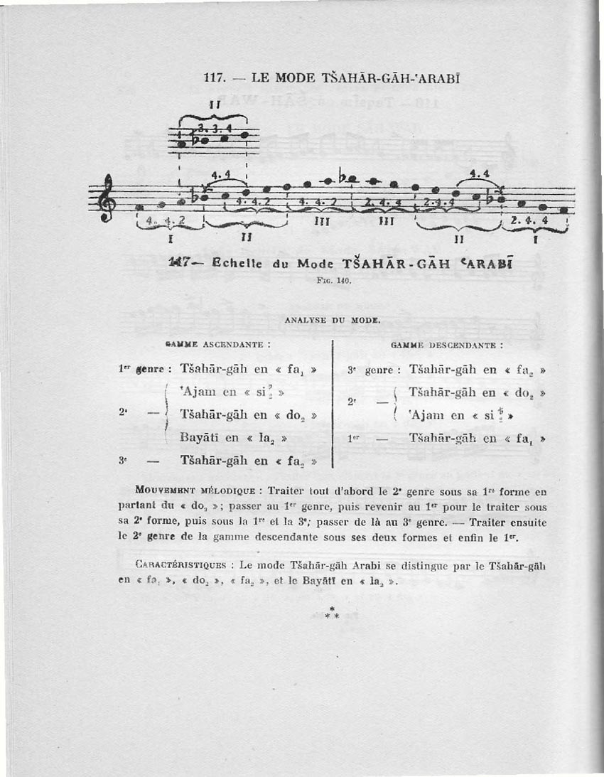

These maqamat are referred to as ' Tsahar-gah- Arabi' (current Arabic Jahargah) and 'Tsahar-gah-Turki' (like Saba with conclusion on the Jahargah note) in the Rudolphe D'Erlanger book:
Attachment: phpPd1q2W (140kB)
This file has been downloaded 122 times Attachment: php9ga2eb (170kB)
This file has been downloaded 138 times Attachment: phpxwTN3r (138kB)
This file has been downloaded 120 times Attachment: phpSuNjwL (150kB)
This file has been downloaded 156 times

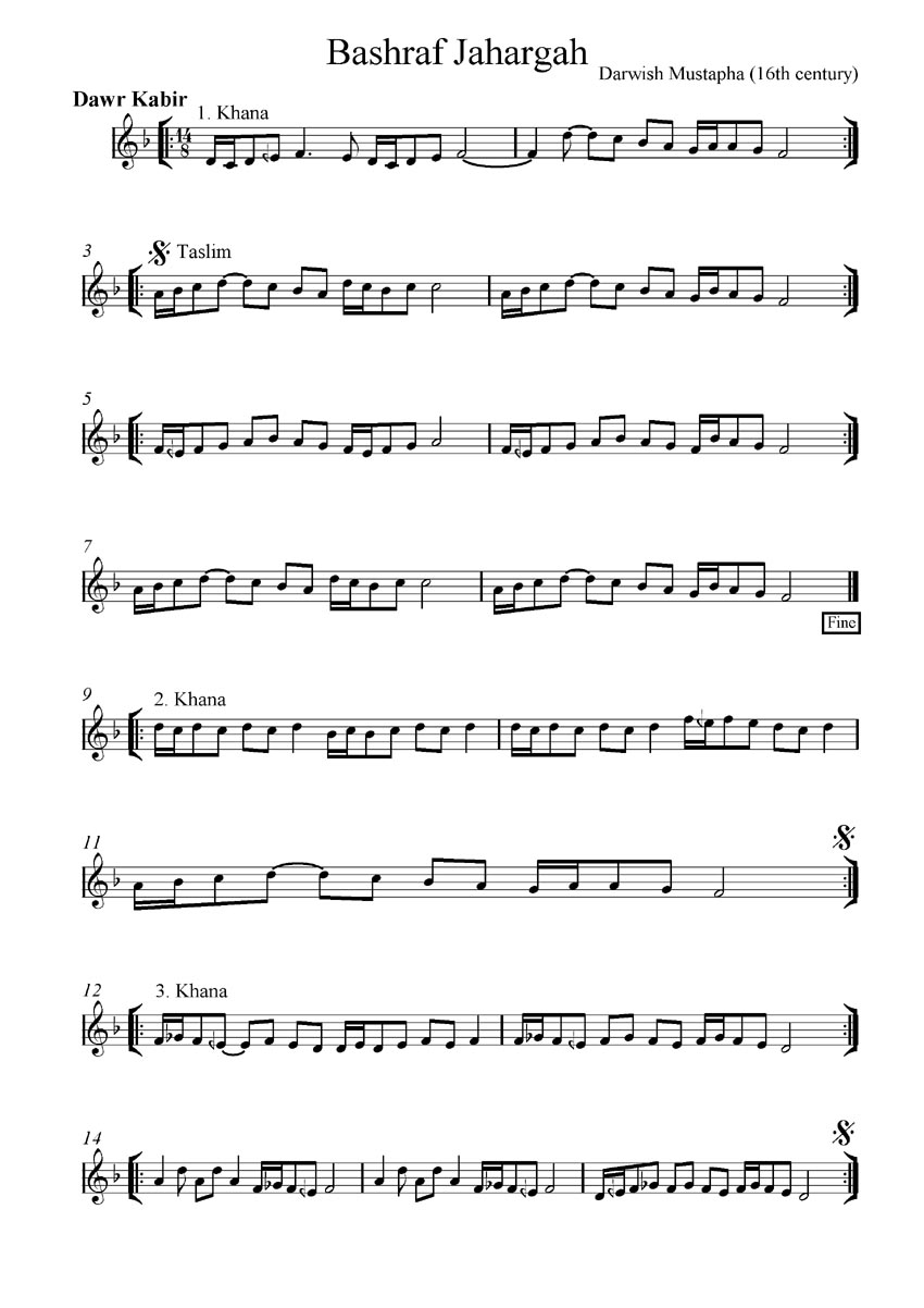

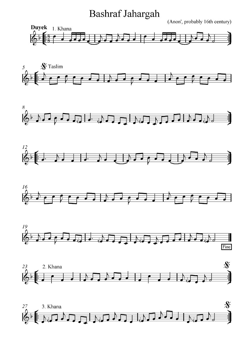

Here are two old Ottoman pieces in Jahargah:
Bashraf Jahargah.jpg - 121kB Bashraf Jahargah 2.jpg - 119kB
A recording of the first piece (Bezmara, Arabic pitch Jahargah)
http://www.youtube.com/watch?v=QXBWiBaaJJA

It seems that the current Arabic Jahargah is identical to the old 16th century Ottoman one.
This would seem logical as this is the basic mode off the fourth degree of the basic scale (Rast).
Although, I think this maqam is in between the basic maqamat and those that employ secondary scale degrees, as the Ajam note entirely replaces the Awj one.
The Cantemir repertoire is definitely a major link between old Ottoman and pre-Ottoman Medieval styles, and what has become known today as Classical Arabic music.
(The intonation of the pieces from the Cantemir book is also the same as current Arabic and Persian art musics, with the neutral, not 1 comma flat tones, and without the extra notes added to Turkish music post 1750).
