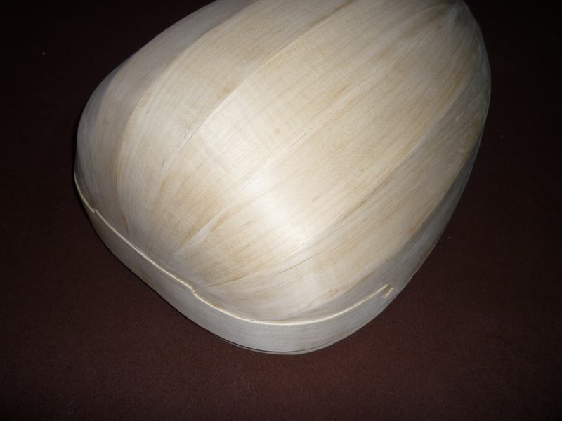

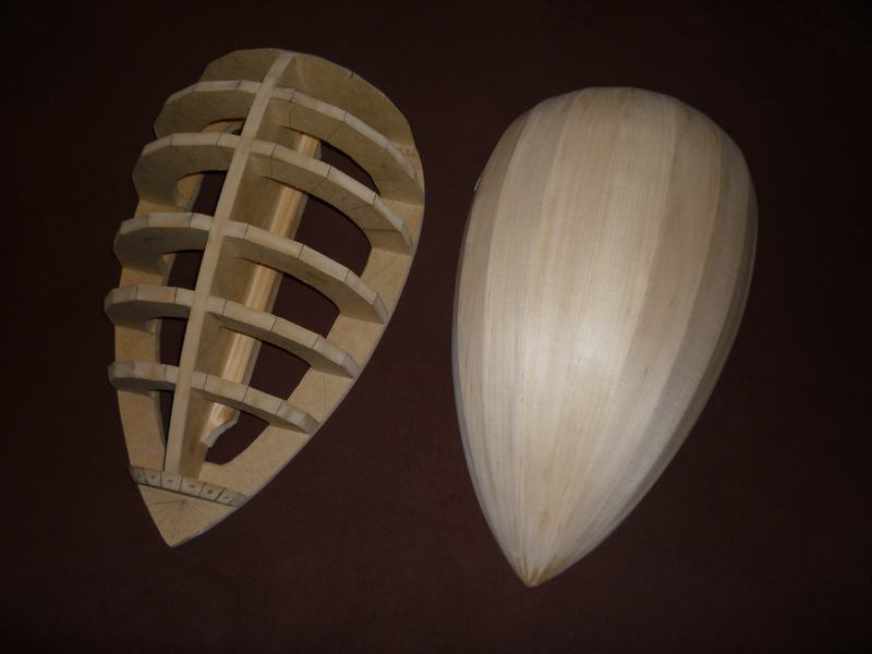

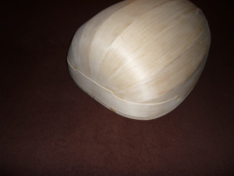

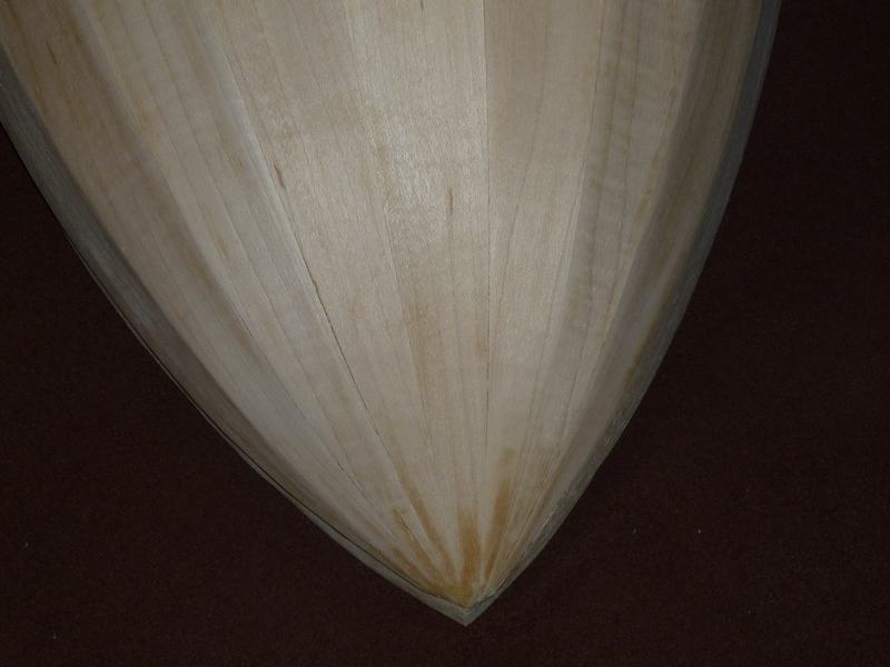

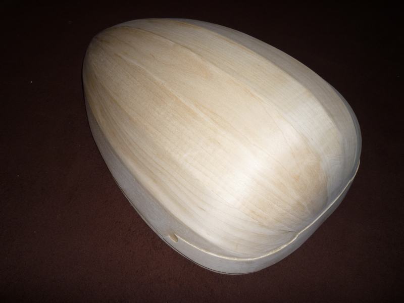

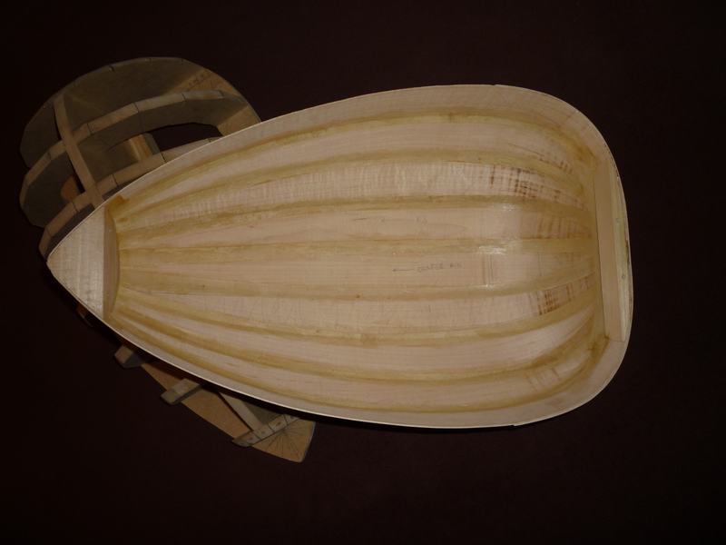

Instead of all, I didn't give up with an idea to make renaissance lute at my own. Having been collecting pieces of information over the net and following your advices now I have another, not perfect but yet along better bowl, now in maple. Ribs are quite thin, about 1.35 mm, neckblock is made out of basswood. I managed to have the "balloning" effect not to be more than 1 - 2 mm, and the final shape differs from the designed one only a very little. But I still got some troubles when fitting the ribs together - some of the joints are tight and even hardly noticeable, but some of them have a gap... And I won't show you what's happen under the endclasp :) How to avoid it in future? Is it really so hard job (or best kept secret of instrument making :) )?
Anyway, I am going to finish this my very first instrument. I got mahogany block big enough for neck and some scraps of beech for a pegbox. Please, help me to design them. Especially - how wide the neck should be at body joint and an the nut, I think, for a six course instrument, to have it comfortable to play?

Pretty good for a first attempt. There are no secrets - achieving perfect rib joints is learned through making rib joints - like most manual skills it cannot be taught but is inherent in the natural abilities of the craftsman. Your next lute (or oud) bowl will be more perfect than the last and less of a fight now that you have made one.
The most difficult areas for making perfectly fitted joints is at the ends of the ribs - particularly at the bottom end of the bowl where the compound curvatures are greatest. The end clasp or cap is there not only to reinforce the bowl in the 'below bridge' area but to cover up any gaps in the joints and nail holes used to temporarily secure the ends of the ribs to the mold. Any gaps at the neck block end will likely be removed when the neck joint is cut. However small joint gaps will not affect the integrity of the bowl due to the joint reinforcement strips inside the bowl. Slight gaps are more visible on bowls made of light coloured woods but much less so if dark coloured woods or alternating dark and light woods or dark liner strips set between the ribs are used (one secret I suppose!)
I note that you have used an oud like tail block inside the bowl. This will likely not affect anything but lute bowls of the renaissance period had not only an exterior end clasp but also a thin, hot bent, softwood counter clasp glued inside the bowl. This is glued in place after the bowl has been removed from the mold.
Also it is best to cut the neck joint before assembling the ribs and bowl to ensure accuracy.
How did you determine the geometry of the bowl - is it based upon an historical instrument (Maler or Frei perhaps from the appearance of the bowl)? What are the completed dimensions?
It sounds as though you have not made a full sized drawing of the lute in order to determine critical details like string length, string spacing at nut and bridge, bridge position, sound board bracing, sound hole diameter and position, neck length etc.? If not then this might be a good time to do so - using a tracing of the bowl profile as a starting point.
Once the relative positions of the above have been established then the neck joint width can be accurately determined.
A six course instrument is fine for the extensive surviving early Renaissance lute repertoire but seven or more would be more appropriate for the late Renaissance period. Note that the extra courses on a lute, beyond the six stopped courses on the fingerboard, are generally played open and not stopped - an additional complication but not so difficult as might first appear.

- I choose the way to make bowl with both blocks screwed to the mould just because, I have no idea what to do to have the ribs not to be glued up to the mould :) Of course, I could put some thin plastic under ribs, but it hadn't been my favorite thing to do.

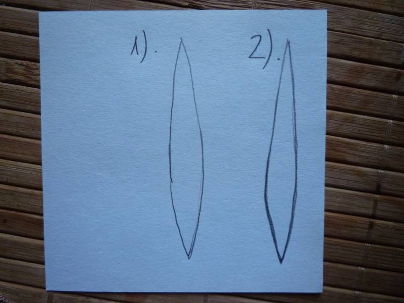

- I was preparing the ribs only with very basic shape, wider and longer, and then, after bending, fitting the joining side by plane, and for final touch I used sandpaper glued to flat surface. When it was at least fairly acceptable, I was determining the outline of another side comparing it to bulk edges of my mould, and preparing it same way - is it a proper approach?
- With top ribs I did it another way - I realised what you said, that the "balooning" effect occurs where the curvature is the biggest. So I fitted paper strips, and then marked slightly another shape of these two top ribs. It is on the picture (the second one). Fail or not?

For information on the method I use to construct a bowl see pages 7/8 of "Old Oud - New Project" on this forum. To prevent the ribs sticking to the mold I place strips of 'oven proof' (heat resistant, non stick) paper under the rib joints as they are assembled. The paper is removed as each joint is completed and to be sure that nothing is stuck to the mold surface, I run a thin metal spatula under each joint as it is completed. Don't use plastic under the joint if using the hot hide glue method as it may melt and stick to both rib and mold surfaces!
The outside ribs are usually made a bit wider than the rest.
For a bowl that is perfectly semicircular in profile finishing the rib joints with sandpaper glued to a flat surface works pretty well. Note however that many historical lutes (Frei and Maler included as well as some old ouds) do not have perfectly semi circular sections but are deeper at the neck block end. Also some of the larger lutes of a later period had significantly flattened bowl sections. For these, the ribs (often over 30 in number) - after rough shaping - must be individually fitted with plane and file to obtain perfect joints. Rib spacers can be of some benefit here in disguising any slight joint imperfections.
Rib widths should be checked for reasonable consistency as work proceeds on fitting and assembly of the bowl to make sure that the finished bowl looks symmetrical.

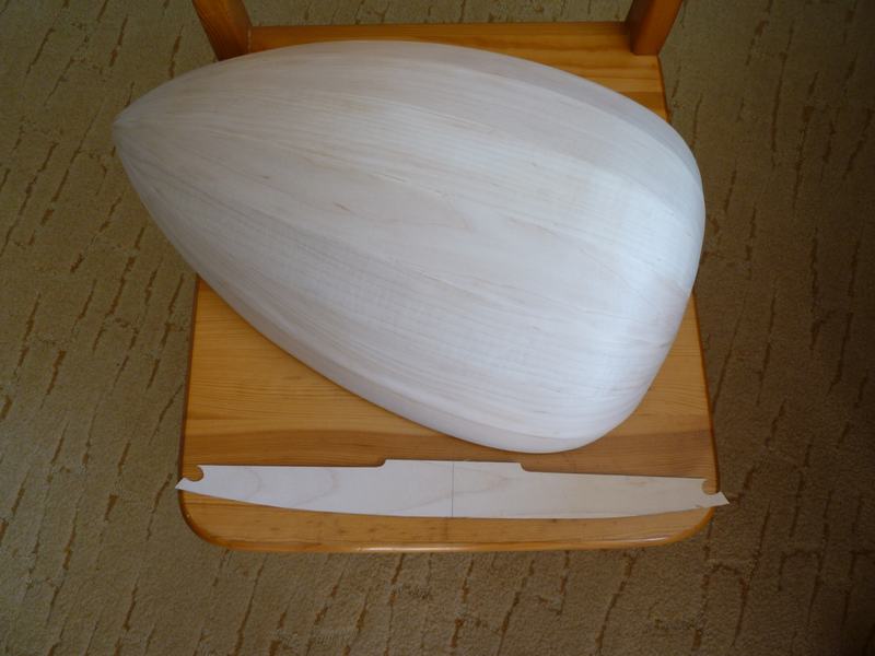

Dear Mr. JDownig,
Thank you a lot for your attention. It took me some time to carefully read all your posts you mentioned. But in all, it is marvellous, and I appreciate a lot your contribution to this forum and all newbies in lutemaking :)
By the time, I made careful drawing and decided about all measurements. Also, I did some progress. Here are: mahogany neck and freshly prepared pegbox. "Walls" of the pegbox are made out of ash (or beech, I am not 100% sure), the wood for it was taken from... very old broomstick :D Two blocks are from basswood, also thin maple veener will close the back of it.
I am going to stain neck and pegbox black - with ordinary black ink from papery-store, and cover it with shellac, to not to have the neck leaving black blushes on the hands. I realize it is maybe not the best option, and not historically appriopriate - but how can I do it more professionally?

Progressing well - good for you antekboodzik.
It is often difficult to stain hardwoods a dense uniform black using wood stains as they tend to show the wood grain and would likely not disguise the different woods that you are using for the neck and pegbox (if that is your objective).
So - best to avoid staining woods if you can. Keep it simple - let the natural beauty of the wood shine through!
However, to stain the neck a dense black I would use not an ordinary black ink but so called 'India Ink' - once used by draughtsmen - still available from office supply or art supply stores. This ink contains shellac and is water resistant. So you could use this without a protective coat but it would soon wear through to the unstained wood of the neck.

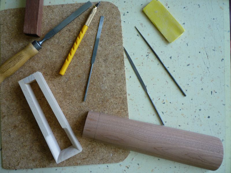

Hi, here's some progress I did recently. This is my setup for thicknessing halves of the top. I found a wood-carpenter, who did a resaw for me, but unfortunately, with his very big bandsaw he was able to make 8-9 mm thick plates from a wedge only. I found, that thicknessing it by my small block plane is possible, but a very hard job, even if the plane is really sharp. What I could do to make it easier and faster? Maybe this is the time to join halves and rougly cut the layout of the top - there would be less wood, or I can use some gouges to remove some portions of waste wood?
By the time I prepared very basic calipers - even somehow fragile, it works, but anyway, I will make another one using aluminium bars/profiles.
[file]24209[/file]

there are my "lazy" go-bar press, and all of braces in place and scalloped, but not trimmed to correct lenght yet.
How do You like it?
