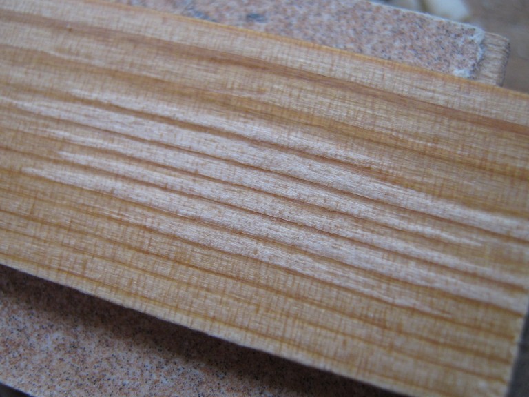

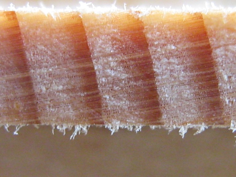

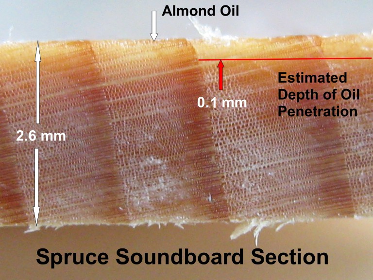

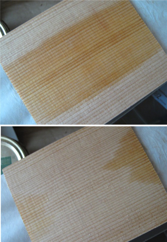

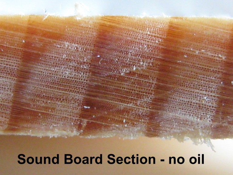

But how porous is a typical sound board wood to an oil finish?
Never having applied an oil finish to a soundboard I tested a quarter sawn sample of Sitka spruce that was 2.6 mm thick with a coating of Almond oil.
The oil was applied liberally to one surface and allowed to 'soak in' for 12 hours before the surface was then wiped clean of the surplus oil
remaining.

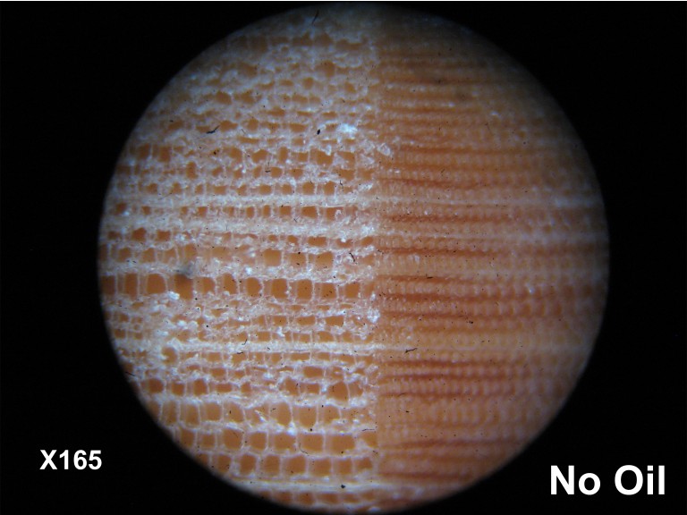

The oil darkened the surface as expected but there was no visual evidence of any oil having penetrated the full thickness of the sample.
The sample was then sectioned and examined under high magnification. Again there was no evidence that the oil had penetrated no more than about 0.1 to
0.15 mm below the surface as the attached images reveal. A non oiled sample is shown for comparison.
In practice when applying a rubbed vegetable drying oil finish (like TruOil or Danish oil) to hardwoods, the oil is rubbed in and allowed to remain on
the surface for about 10 minutes before being wiped off - so the above penetration test is more severe than would be experienced in normal
practice.
Although attempting to glue a brace to an oiled surface using hot hide glue would likely not be very successful (although I have never tried it) - on
the basis of this test there would appear to be little chance of any non drying oil finish soaking through the full thickness of a sound board to
cause problems with the security of the braces.
This perhaps surprising lack of penetration of a non drying oil on the sound board wood sample in turn suggests that the acoustic effect of the oil
(due to internal damping) may also be minimal.

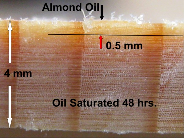

I should point out that due to a miscalculation the depth of oil penetration previously posted should read 0.3 mm not 1 to 1.5 mm. The line drawn on
the image to indicate depth of penetration is to the correct scale proportionally. Estimation of the penetration depth is complicated because the un
oiled wood has some degree of translucency (as seen in the image of the section without oil) making the depth of penetration seem deeper than it
actually is due to the top lighting of the image. However, the oiled section has now been examined under a high power microscope with much better
resolution than the digital camera images to confirm that the depth of oil penetration is only about 10 early wood cells deep - that is no more than
0.3 mm as previously estimated.
I suspect that the degree of penetration is not time related so that there will be the same depth of penetration regardless of whether the surplus oil
is wiped of the surface of the wood after 5 minutes or after 12 hours or more. There may be some inter reaction of the oil with the wood cells that
limits penetration but I do not know what it might be.

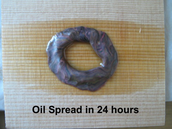

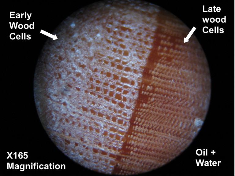

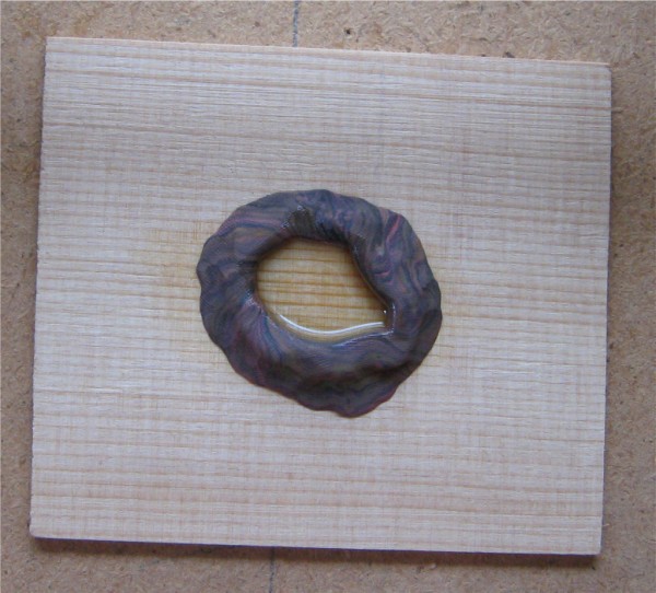

Well, here is some food for thought.
The drop of water on the surface of the oiled test piece was fully absorbed into the wood within 20 minutes spreading along and across the grain and
apparently removing the oil in the process - see the attached image.
Microscopic examination of a section of the sample revealed what appeared to be a white translucent crystal or jelly like material filling the larger
early wood cells spreading to almost the full depth of the test piece.
It would seem that the water has reacted in some way with the oil to form some kind of emulsion (?) that has drained freely through the early wood
cells (but not the smaller late wood cells). Either that or the oil had in fact initially and invisibly soaked through the full depth of the test
piece and had reacted with the water as it too drained through the sample?
Curious - but it would seem from this that non drying vegetable oil does not protect against moisture ingress.

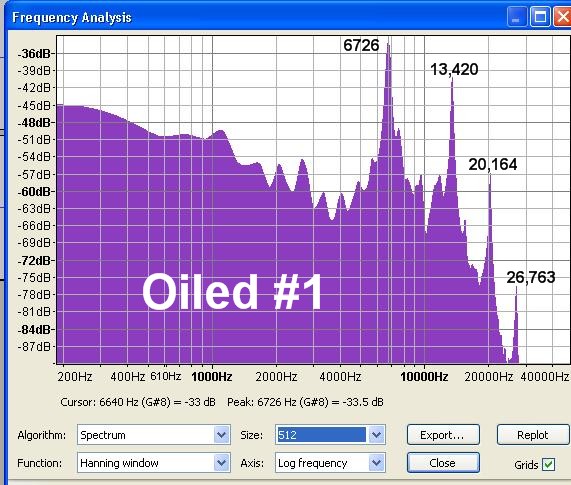

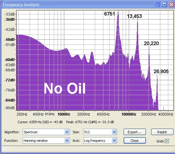

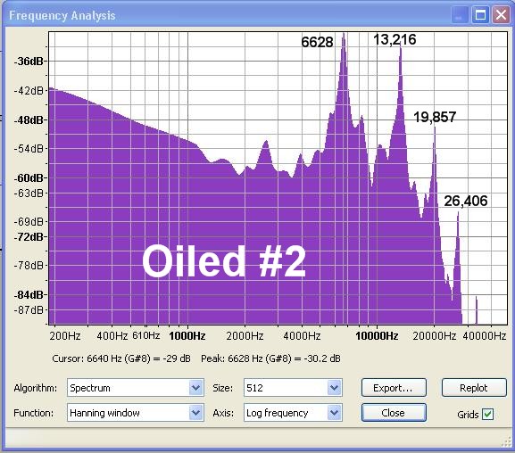

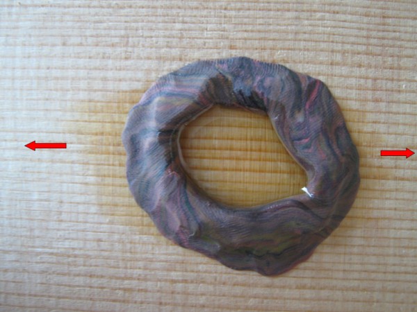

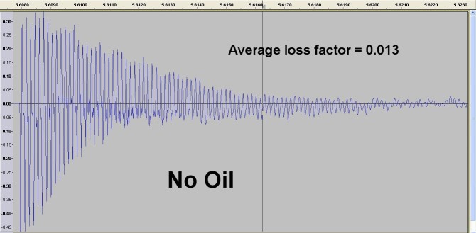

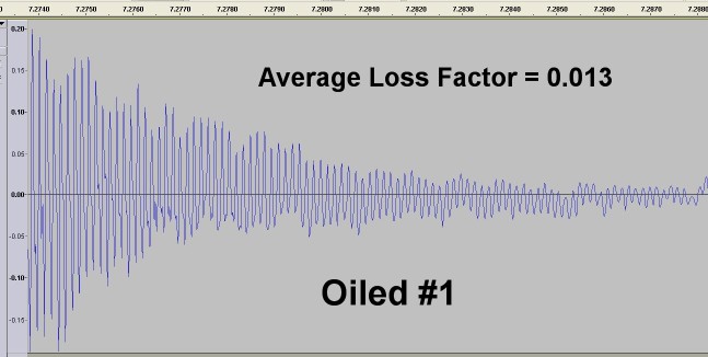

So, moving on to acoustic testing.
The sample chosen for the comparative tests is a piece of fine, straight grained spruce of construction grade - a bit 'heavy' so not quite good
enough for selection as sound board material. The sample has been prepared by reducing in thickness a test piece from another trial - dimensions 39.9
cm x 17 mm x 2.5 mm, grain vertical across the minimum dimension to represent a quarter sawn soundboard. Density of the sample is 514 kg/m³.
The sample was first acoustically tested free of oil and then after Almond oil had been applied to the upper surface of the sample. The oil was

The attached images - for comparison - show the Audacity spectrum analyses and waveforms for the no oil and oiled acoustic tests.
The spectrum graphs show clear harmonic peaks of the fundamental, second, third and fourth harmonics from which the average speed of sound is 5378 m/s
- within 0.5% for both oiled and non oiled tests.
This translates into an acoustic Sound Radiation Coefficient - a standard measure of sound board material 'goodness' - of R = 10.5 for both the oiled
and non oiled samples.
So - no change due to oiling.
What about internal vibration damping?
From the waveform - amplitude against time - it is possible to make an approximate estimate of the loss factor which represents the level of internal
damping.
Again there is no significant difference between the oiled and non oiled samples.
It doesn't seem like your almond oil is penetrating, so it's not too surprising it doesn't do anything, in any department.
Yes that is the anticipated result - oil penetration being limited by the time duration surplus oil remains on the surface before being wiped off - in
this case after 10 minutes.
To see if a longer time duration makes any difference, for test #2 the sample was flooded with oil on the upper surface and left for 24 hours before
being wiped off. It was noticed that oil had partly covered the underside of the sample but it is not clear if this is due to deeper penetration of
the oil through the sample or due to oil running over the ends and sides of the sample and then spreading over the underside by capillary action.
Therefore, to test for oil penetration a small plate of quarter sawn Sitka Spruce sound board material - planed smooth both sides - 4 mm thick has
been prepared. A small reservoir for the oil made from modelling clay has been made on the upper surface of the plate. This will be left filled with
oil to determine how long it will take for the oil to penetrate to the other side of the plate (if it ever does). After 3 hours it can be seen from
the attached image that oil is spreading essentially along the longitudinal wood cells. This mechanism suggests that the oil observed on the underside
of the sample in test #2 is a result of surplus oil running over the edges of the sample.
Non drying oil spreading in this manner might have implications for future repairs to a fixed bridge due to contamination of the wood under the bridge

The #2 acoustic tests revealed a 2% drop in the speed of sound calculated from the resonant peaks - average value 5281 m/s compared to 5385 m/s for
the un-oiled case reducing the sound radiation coefficient to 10.27 or about 2% reduction. There was no measurable change in density of the sample.
Estimating the loss factor from the waveform gave a value of 0.0144 or an increase of about 11% compared to the un-oiled case.
These results would be consistent with a greater depth of penetration of the oil over a 24 hour period. Note, however, that it is very unlikely (I
would hope!) that oil would ever be applied in this manner.

The reported 'mysterious' crystal or jelly like deposits in the wood cells would appear to be a non event.
The wood sections observed under a microscope at X165 magnification for both untreated Sitka spruce and spruce treated with oil and then water are
prepared by slicing the end grain of samples with a razor blade to produce a clean cut of the wood cells in section. This is a pretty rough and ready
method that should be done with a 'microtome' apparatus for perfect results - but they are pretty costly and I do not have one.
Using a Canon PowerShot A470 digital camera set to X1 macro mode with the lens hand held against the microscope eyepiece I was able to record somewhat
imperfect but otherwise reasonable images of the wood cell structure for both the untreated and oil + water samples - see attached images.
In both cases the 'mysterious' deposits are in evidence so they are likely nothing to do with mixing water with the oil finish. They are, in fact,
probably just accumulated crushed cells caused by the rough specimen preparation method of free hand slicing with a razor blade!
This being the case there should be no significant effect of the addition of water on top of the oiled finish for test #4 - but the trial will be
carried out just to see.
After 24 hours the oil in the saturation test has spread longitudinally across the full width of the test piece and is now flowing into the end grain
and is just starting to spread along the longitudinal cells on the other side. The lateral spread of the oil is much less confirming that the oil is
primarily conducted along the longitudinal cells close to the surface. There is no sign of oil soaking through the thickness of the test piece.
In the meantime, test #3 after 24 hours showed no change in the results previously obtained in test #2. This test piece will now be fully saturated
with oil (as far as possible - by soaking both sides over the next day or two and wrapping the piece in plastic) and then audio tested to represent
the worst case scenario.
The solubility of hide glue in Almond oil has been tried by immersing some dry 'pearl' glue in oil for 24 hours. As expected there was no softening of
the glue. So it can be expected that hide glue will act as a barrier against spread of oil across a joint but likely would not prevent the spread of
oil through the underlying wood cells. However that assumption would need to be tested.
After 48 hours the clay reservoir on the saturation test piece has been removed. From the attached image it can be seen that the oil has spread
uniformly along the longitudinal grain - but with little lateral spread across the grain - and is seeping into the end grain partially spreading on
the underside of the test piece.
The test piece has been sectioned through the reservoir location in order to determine the approximate depth of penetration of the oil - estimated to
be about 0.5 to 0.6 mm. (see attached macro image). This does not represent a practical example of oil application where there would, of course, be no
reservoir feeding a continuous supply of oil to the wood. It does demonstrate, however, that the penetration and absorption of a non drying oil
applied by wiping the upper face of a quarter sawn sound board is considerably less than might be first imagined - certainly nowhere near enough to
saturate the full depth of a sound board (crack free) measuring 1.5 to 2 mm in thickness.
