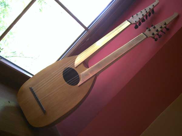

Has anyone heard of an oud with a metal fingerboard???
If yes, how does it sound?

I agree with you that to make an actually real oud with a metal fingerboard would not seem to make any sense since an oud sounds great as it is...
...however what I have in mind is trying a metal fingerboard on the "oud neck" of my RAGMAKAMTAR which is sort of a double neck oud -- one neck oud and the other neck sarod. A sarod is a bit like an oud with metal strings and a metal finger board.
Normally I use a material called "trespa" for both fingerboards... trespa looks like ebony but is more hard. It is made from wood fiber and epoxy resin. This material works well for both nylon and steel strings.
But for my next ragmakamtar I am thinking to use a brass fingerboard for the sarod which will sound great.... but my girlfriend actually suggested to use brass for BOTH necks simply because that would LOOK amazing.
So I am just checking to see if anyone has tried something like this...
...anyway you are probably right that it will not work - but in a couple of days I will try it out and we will know for sure :-) I have a walnut and an aluminum fingerboard prepared and will try them both out on the new instrument... I am afraid that wound bass strings might give off a bit of a harsh sound as they buzz against the metal. . . . . . . but anyway for this new instrument I am looking for a very bright sound - so who know?
I let you know how it works.

I think Fritz perhaps misunderstood slightly in my question - certainly a 2mm thick metal fingerboard on an oud would be absurd... but what I am going to try is a 0.5mm thick piece of brass glued to a 2mm thick piece of maple. Still of course even this might cause some sort of blockage of frequencies. . . (?) . . .on the other hand the effect might produce some unexpected pleasant results. If there is anything I do know for sure, and that is that it is never enough simply to go on theories and speculation alone - new ideas need to be tried and tested before discarded.
For example when I first had the idea to try to make a double neck with one neck nylon and the other neck steel string, everyone told me that this can never work. After 8 times trying I almost gave up on the idea assuming that what they all told me was finally correct..... however I feel that ragmakamtar version #9 has a very good sound on both the nylon and the steel string necks. . . which just goes to show that commonly accepted theories can be wrong.
For those interested, here are two clips comparing both necks:
http://www.youtube.com/watch?v=m2gOcczf7IM
http://www.youtube.com/watch?v=LXDM8TEvPQk

well in a matter of perhaps hours I will know if it will work or not - at least with aluminum.
if aluminum will sound good, I will go buy the more expensive sheet.
I guess 0.5mm is the thinnest I could go - and thicker would be too heavy.
Perhaps metal might interfere with some resonance - I'm not sure, but my main worry is that with very low action the buzzing might be way too metalic . . . but it must be tried to know for sure.
Anyhow it is all just about cosmetics since TWO shiny gold fingerboards would look amazing...
The way I glue it is very fast, easy, cheap and unconventional ...... I put a 5mm wide band of contact cement around the outer edges of both sides to be glued - then I saturate the area inside the 5mm bands with super glue (!), then I just put the two sides together (the 0.5mm metal and the 2mm wood. The nice thing about this method is the contact cement holds it in position immediately, and then the CA glue squeezes to saturate the entire surface, and holds tight like a mother once it is dry (25minutes).
Of course I clamp it between two very flat boards to be sure that the final surface is totally flat because metal can not be tweeked like wood (this is the main disadvantage).
Will let you know how it sounds....

I got the bronze fingerboard on... so far it works great for the nylons... it seems to work well with the wound strings, but I'm not yet 100% sure --- the instrument is only half a day old now, so it will take a little time to settle. . . but so far I am very encouraged.

[*] posted on 8-12-2012 at 12:54 AM
Quote: Originally posted by Giorgioud
Well, my most heartfelt congrats Edward, I am really looking forward to see how your new "baby" is going to sound like.....may I ask if you if you could post some sound samples in the near future for our aural pleasure?
Thanks, nice one mate!
Thanks G.O.!
Here is a pic...
i will be making a short vid very soon..... will post!
metal-FB.jpg - 18kB

[*] posted on 8-12-2012 at 01:20 AM
Wow, man, gorgeous! How do you tune the esachord (may I venture at a wild guess that you tune it like a guitar?) and the five-course (Syrian tuning perhaps?)?

[*] posted on 8-12-2012 at 03:17 AM
What is the 5 course Syrian oud tuning?
My oud neck is tuned (from low to high):
FF - CC - GG - cc - ff
The Sarod neck is almost the same:
cC - C - G - c - f

[*] posted on 8-12-2012 at 01:15 PM
just and update: it is starting to sound very good all around - even with the wound strings with very low turk-type action.
however I can see now one major disadvantage of the metal fingerboard for an oud, and that is that when u want to seriously fine-tune the superlow action, it is great to have a wood fingerboard because the wood can be sanded and finely tweeked - - - this is also possible with metal, but more difficult.
personally I would not use a metal fingerboard on a regular oud - and I am only using it on the ragmakamtar for cosmetic reasons. . . it simply looks very cool to have a double neck with two metal fingerboards :-)
It definitely does sound great, but it is more difficult to work with.
