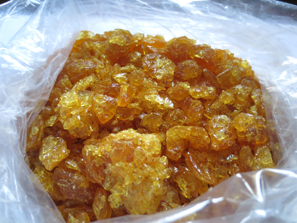

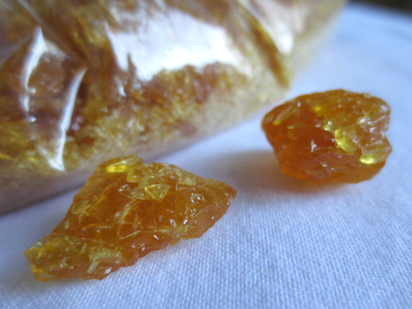

[*] posted on 8-26-2012 at 08:59 AM
Just bought shellac flakes today...
I'm in Istanbul now....
A friend brought me to a side alley with a shop that sells minerals, chemicals etc.
They had 3 grades of flakes, and this is the highest grade for luthiers - beautiful clear, light honey color.
TL150/kg.
Can't wait to try it out....

[*] posted on 8-27-2012 at 01:36 AM
It may have been the same shop. They have bags of minerals - gypsum, salts etc
The cash register is in a separate little cubicle on the right.
A side street off the busy pedestrian way selling baklava to plungers, stretching from Ataturk Blvd to the Spice Bazaar.
The flakes I got are the clear ones.
The photo is darker than real life without flash, and if you separate the flakes from the clump, they are very light and pure.
The darker ones are furniture grade and much cheaper.
