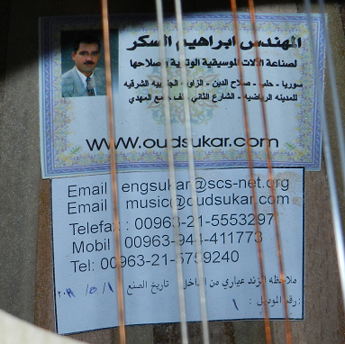

Thanks for all the input..nice to know there isn't much difference in the sound quality between the different models..the seller sent me a pic of the
certificate and it looks like the date when it was made is hand written over the original date i'm assuming this is normal because I have seen the
same thing on a different sukar.. I also asked him about the adjustable neck and he didn't say anything about it..I honestly don't know what the
adjustable neck is suppose to do but is it possible to tell from looking at the pictures.. The certificate pic is below

the adjustable neck allows you to rise / lower the action to your personal preference. this is done by fiddling with a wing nut you will find inside
the bowel, near to where the neck meets the bowel. you can not tell by the pix you posted whether it has such device or not.
the label looks slightly different to the label in my old sukar, but, for what it's worth, i dunno if my sukar was genuine. it had an adjustable neck
though.
