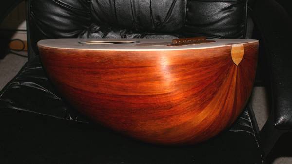

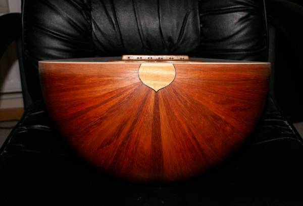

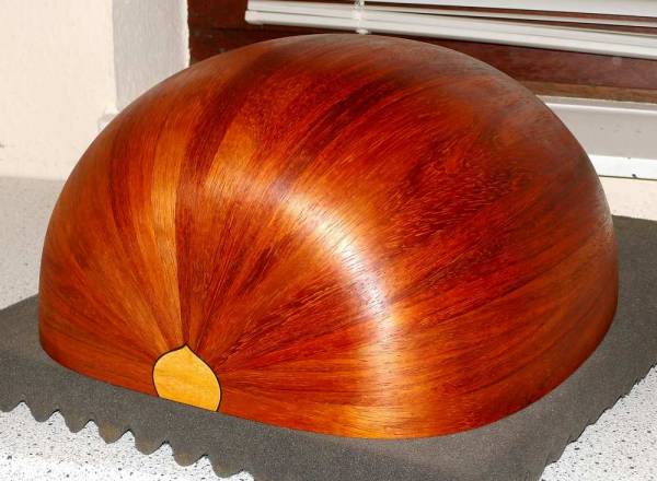

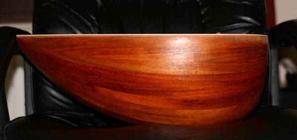

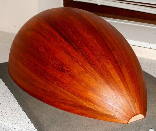

Hi... hope, U like my new Oud made of Padouk, with a very fine tight and straight grained spruce top curved slightly inside in length and a bit in wide direction... Inlay in the 1,6mm top made of genuine mop, bridge walnut, pickguard made of very thin mahogany, layed in bookmatched pieces symmetrically.
Decke drauf 1Mike.jpg - 27kB DeckenKanteMike.jpg - 16kB MuschelFertig1Mike.jpg - 38kB MuschelFertig2Mike.jpg - 40kB
Attachment: phpnCIWdm (19kB)
This file has been downloaded 290 times
Attachment: phppJeBtY (20kB)
This file has been downloaded 271 times

The padouk is very uncomfortable to work with... I needed much time to bend them precisely, nearly one whole day...
The top of this Oud has a slight concave surface... this Oud will be able to be played like a turkish one, but with the characteristics of a classical arabic oud. 600mm string length, 500mm body-length, fine dimensioned sound hole.
The neck is already inserted, only needs to be covered with Padouk... and the fingerboard... may be of ebony or dark rosewood...
Music is the food for the soul

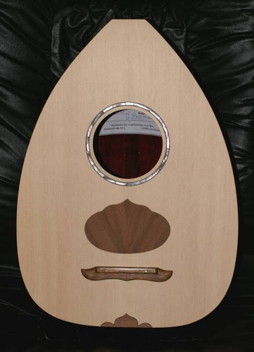

[*] posted on 10-6-2013 at 09:26 AM
Very nice bowl Fritz.
I also like very much your bookmatched pickguard.
Simple idea, but very original and beautiful.
Could post some picture to show the concavity of the soundboard.
And why did you make it concave ?

Hi Robert ... nice to read you !
Yes... the Padouk is a beautiful wood in colour and seems to be a nice tone-wood. I will see...
I think I will make only such pickguards in the future... perhaps something like a brand...
The mahogany pickguard will look amazing when the shellaque is applied... very thin viskosity, but enough to make the top nearly safe against fingertips leaving on the surface when handling the Oud an long time.
I tryed to make some pics of the curved surface... but it is difficult to catch this feature in a picture.. but I will try again... I have got a very fine photographical equipment.
I made the top concave to meet the needs of some players and Profs... It is a try, to give the playabiltiy of turkish Ouds to arabic ones. I think, almost all turkish Ouds have such concave top. And some players want to play in turkish style ... on an arabic Oud...
This Oud will sound great I think... with good strings (NylGut)... Next days other pics will be posted... :)

Hey Robert
Here are the promised pics about the top I made concave... Have a look... also on the other pics I posted now :)
The purfling is made of flamed maple... it will shine more when shellaque is applied :) So the body is completed. Today I made the rest of the necks stripes of Padouk to make the covering complete. Now comes the fingerboard...
Greetings
Fritz
