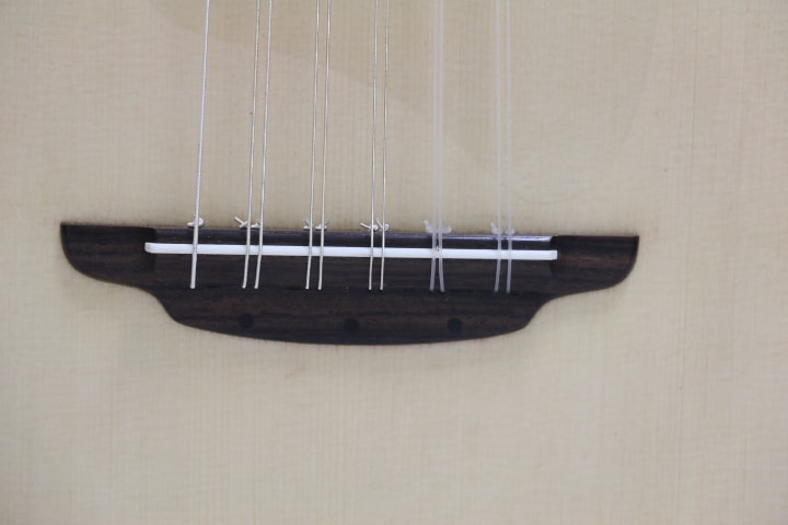

Most modern Barbats and these new Persian Ouds like these are using uniquely designed bridges. As you can see below, the strings are tied on completely differently. Stings are easier to put on, but how does it affect the sound?
If a guitar saddle and a floating bridge had a baby, it might look like that.

Mortys
Posts: 163
Registered: 7-12-2009
Location: Utrecht, The Netherlands
Mood: As happy as Oud face
[*] posted on 5-18-2016 at 10:59 PM
Dear Jody & Brian,
Thank you for your questions.
Well in first case i meant generally about the shape and look of a bridge. In detail , of course every inch of any part of an acoustic instrument have an effect on the sound and also the bridge mass and the rest of related matters.
But this is the art of the luthier to take this issues into account to get the best sound out of an instrument, right?
Building ouds with a saddle is nothing new, as Mohammadi bros doing this like ages and their instruments prove to be one of the best out there, if not the best! You can see in the pic that navid ( Thank you Navid bytheway) posted.
Body depth is 17cm
Max width is 36cm
Removing the armrest is no issue but it's not replaceable any more. Design is a matter of taste (like actually everything in life Brian), some like, some don't.

[*] posted on 5-19-2016 at 06:20 AM
Well, each culture has its own aesthetic preference regarding sound. Persian, Turkish, Iraqi, etc. I have no doubt that you are correct that this bridge design is preferred by some.
Design is not merely a matter of taste, but of functionality. If you designed a shirt with one arm, it would be great for a guy with one arm but others may not like for reasons having nothing to do with "taste".

The only other Oud that has a guitar-like saddle is the MultiOud. I don't really know if a Guitar-like saddle would produce a more Guitar-like sound. But I'll say this...
When I bought my first Barbat (with a Mohamadi-style bridge like I posted) my mom was sitting in the front of the SUV, and I showed it to her by opening the case and strumming the open strings... and she said..
"THAT's not Oud, THAT's a GUITAR"...
I was quite pissed off...
What does my mom know about Ouds anyway??
