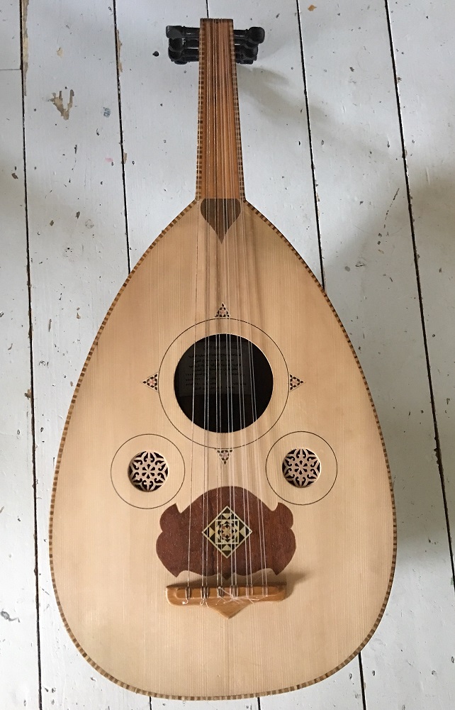

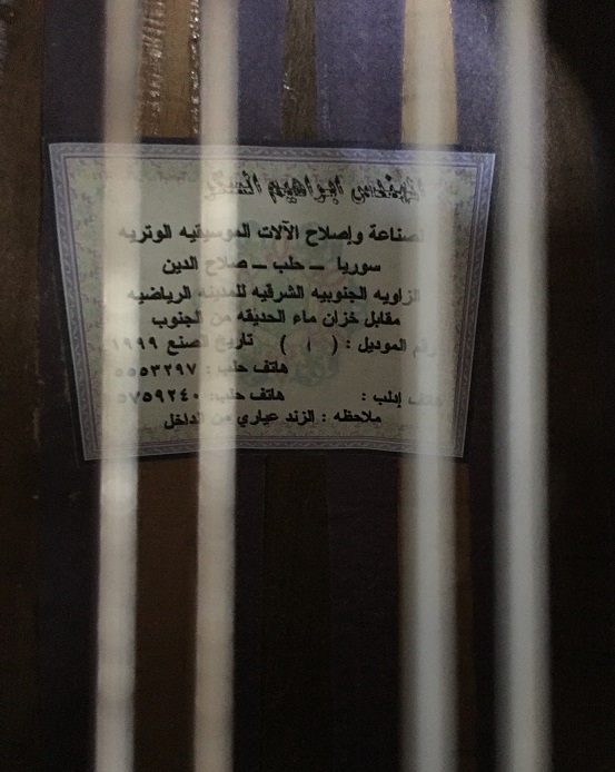

[*] posted on 3-13-2017 at 09:13 AM
This is the 18 year old Sukar Oud we have.
IMG_4381.JPG - 201kB IMG_4382.JPG - 208kB IMG_4383.JPG - 119kB

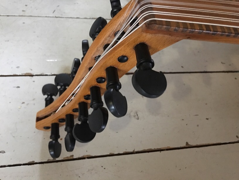

[*] posted on 3-18-2017 at 04:02 AM
Hey guys got the Geared pegs from Chuck Herin at pegheds and installed them on the Oud, have to say they are incredible it's very easy to tune now, got some F to F la Bella strings on there and the old Sukar Oud is now back to life and the mrs is back on it playing her favorite songs. I've even had a go my self and I think I'm getting addicted to it.
Also ordered the AKG mic as suggested by Brian and it sounds fantastic thanks for that.
IMG_4417.JPG - 107kB
