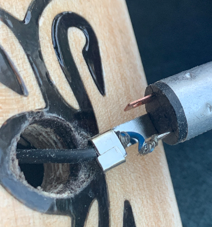

I recently purchased a few ouds from a builder in Turkey. however the mic inserts have an issue. when the plug moves it stops transmitting. I have a feeling it's the poor connection. Anyone have experience with these?
I wonder if they need to be soldered.

That is exactly what it sounds/looks like to me. In your pic, one of the connections is missing/not soldered?
Is there another wire hanging inside loose that looks like it came off that other side in the pic?
If so, you can always try connecting with an alligator clip to test. If it works, solder it back on...
Hope you can get them going. Sounds weird that more than one has issues? I can see one loose maybe, but more is confusing...

The one wire is attached to the ground and one to the clip. all of the ouds have that same connection. Getting an alligator clip and testing it seems to be a good idea. I tried contacting the builder a few times haven't responded.

It sounds like this is an unbalanced connection, which only uses one conductor(and a ground).
the wiring may be fine, but check the soldering points that none are cold soldered(broken).
Also, when plugged in, if there is any movement you can loose connection. It is hard to explain how they connect inside, but looking at this is helpful:

Yes - these connections need to be soldered.
Also, the assembly needs to be stabilized at the point where its housed, in the oud.
I hope you hear from the builder, because somebody in the shop didn't do their job,
this is very shoddy workmanship.
If you're near a guitar shop that works with pickups in
acoustic guitars, they'll be able to help you out. Best of luck to you.

I took it out and bought a new jack meant for acoustic guitars, and soldered it and mounted beautifully. The sound is great. I decided to just replace these jack on all the ouds I have and solder them. They’re cheap just takes a few mins to do.
