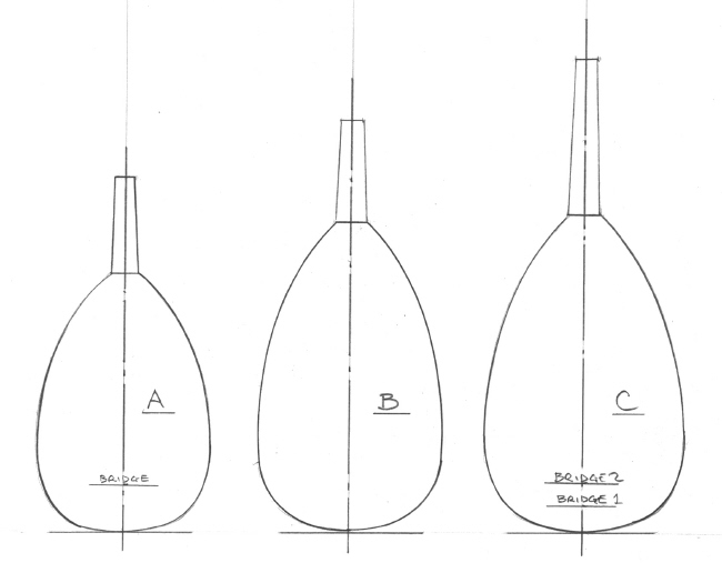

Out of interest I sketched three early oud profiles to scale for comparison.
Sketch A is an Egyptian oud by Hosam Muhi Al-Deen Holmy in my possession - subject to the posting in the Oud Projects Forum "Restoration of an Egyptian Oud"
String length of this instrument is 620 mm and is thought to date from the early 20th C.
Sketch B is a Syrian oud by maker Baseel Al Tounjy, in the possession of Richard Hankey - see his posting in the Oud Project Forum "Oud or Lute"
This oud is dated 1889 but the belly is missing and , therefore, string length unknown. With a 'low' bridge position the string length could have been around 750 mm?
Sketch C is a reconstruction of an oud described by Ibn al-Tahhan (Egyptian?) with "corrections" made to dimensions that do not "make sense" geometrically. This results in a much smaller oud than described by Ibn al-Tahhan.
String length is about 850 mm and date 14th C.
See also "Ancient Scales of Measurement" on this Forum.
Oud Sizes 2.jpg - 45kB
[*] posted on 11-26-2007 at 10:16 AM
I learnt yesterday - for the first time - that an analysis of the Ibn Al-Tahhan oud appears in an article published in the Galpin Society Journal in 1979 "Reconstructing the Medieval Arabic Lute: A Reconsideration of Farmer's ' Structure of the Arabic and Persian Lute'" by Curtis Bouterse. The author questioned the dimensions derived by Farmer from the original manuscript and sought to resolve the problem - as I did - by assuming that there had been scribal errors in the units of measurement and that the unit "isba madmum" had been used instead of "isba" making the length and width of the oud twice what it should be. (not that this speculation made independently by two researchers means that it is correct!)
Bouterse then went further than I did and proposed that , conversely, the unit "isba" used to locate the bridge position should have been "isba madmum" resulting in the bridge being located at 9 cm from the bottom of the bowl instead of 4.5 cm. I have edited the image of oud C in my previous posting to reflect this change - bridge 1 being the original and bridge 2 being the position proposed by Bouterse. As can be seen, bridge position 2 works better proportionally and results in a reduced string length of about 810 mm.
A further thought arising from this comparison of three 'early' oud profiles - is it possible that the neck on oud B has been cut down some time in the past to reduce its length? Was it at one time proportional in length to that of oud C? Just a thought

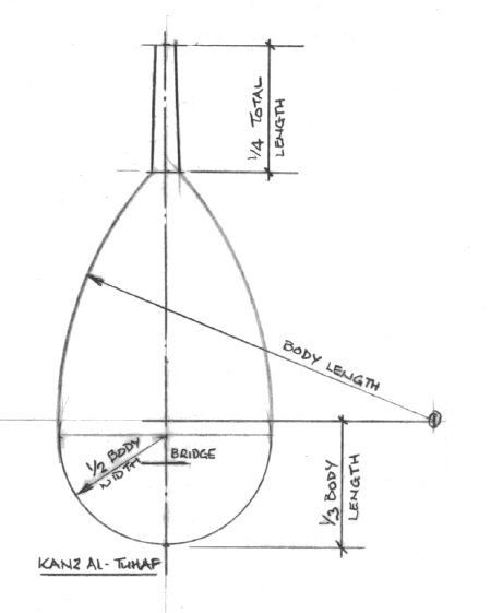

[*] posted on 12-4-2007 at 11:45 AM
The attached image is a sketch of another early oud from the
14 th C Persian manuscript Kanz al-tuhaf as translated by Farmer.
As with the Ibn al-Tahhan oud the overall length given does not make sense so half the length has been used assuming scribal error in the units. The oud dimensions are then, overall length 810 mm, width of body 337.5 mm, bridge 135 mm from bottom of bowl, neck length (at 1/4 of overall length) 202.5 mm, depth of bowl 16.9 mm.
I have reconstructed the geometry of the oud as shown in the sketch. The bottom of the bowl is semicircular with radius half the maximum width.
The radius of the upper outline of the bowl is the length of the bowl with the centre located at 1/3 bowl length measured from the bottom. (This layout also works for ouds A,B, C previously posted)
Kanz al-Tuhaf reduced.jpg - 41kB
