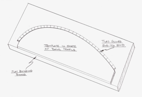

[*] posted on 9-9-2008 at 06:05 AM
The attached rough sketch should make what I have in mind a bit clearer.
The tiles - all precisely and equally cut to the required dimensions - are assembled on a flat building board against a removable template cut to the required profile of the bowl. The template is made either from non stick plastic card or thin card waxed to prevent sticking. On the assumption that the purfling is to be veneered on both sides - veneer (paper or wood) is placed on the building board temporarily trapped under the template edge to hold it in place and flat. The tiles are glued end to end (following the template profile) as well as to the veneer. The ends of each tile may require trimming to a slight angle, as work proceeds, to obtain close fitting glue joints between each tile - the angle being dependant upon the curvature of the template.
Once the glue has dried, the template is removed and any surplus veneer trimmed away with a sharp knife. The purfling is then flipped over and the other side glued to another piece of veneer (using a weighted board to hold everything flat). Surplus veneer is again trimmed after the glue has dried. The preformed 'tiled-purfling' strip may then be lifted from the building board ready for gluing between the ribs of the bowl.
This, of course, will result in parallel sided purfling rather than tapered - both types are viable options - it is all a matter of how you go about constructing the bowl, how many ribs are required, how accurately you work in jointing the ribs and the allowances/adjustments made for the width of the purfling as you proceed. 4.0 mm wide purfling seems excessively wide to me (do you mean that?) especially if you are working with 21 ribs.
Alternatively, tapered purfling may be made by carefully sanding each end of the 'open' side of the purfling to the required taper before gluing on the second layer of veneer.
Either way, making the purfling this way should be pretty straight forward but time consuming and tedious.
If the joint between each rib pair has been accurately cut and prepared then there should be no need to make further adjustments by triming any material off the purfling.
Johnathan, for my information and interest, you have confirmed that there is veneer on both sides of the purfling under consideration. Is this purfling parallel sided or tapered? Also what is its width and how many ribs are in the bowl?
Interesting topic

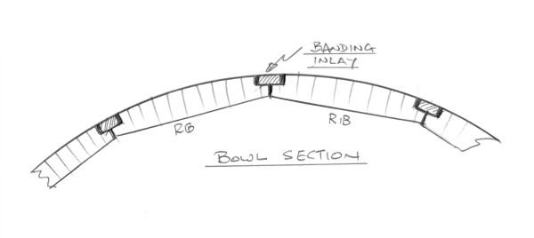

[*] posted on 9-10-2008 at 12:42 PM
Another possible solution that comes to mind would be to construct the bowl without any inter-rib purfling. The rib to rib joints could be fairly inaccurate - within reason. After contouring the bowl by sanding, a groove or channel could be cut (accurately) over each rib joint - to about half the depth of the ribs, say 1mm deep. Inlay banding of the required width might then be glued into the channel. The banding would only need to be just over 1mm thick so could then be easily glued into the channel using hide glue and a hot iron.
Of course, accurately cutting the channel in the first place would be a challenge but some suitable tool might be designed for this duty with a little thought.
Just an idea.
Banding Inlay Oud (600 x 268).jpg - 15kB

[*] posted on 9-10-2008 at 02:19 PM
Interesting topic. I've thought about this many a time. I asked Nazih about this once, and he said that he places the spacers between the ribs as he builds the bowl. Never asked him about how he actually makes the tiled spacers though. I think John's building board would be a precise way to do it.

[*] posted on 9-10-2008 at 04:34 PM
No, he doesn't leave a gap. That could never work since the gap would have to be dead parallel. I suppose you could leave a gap by using a spacer of teflon or plastic---something that would hold the ribs apart but be removable afterward. I think he probably has the strips ready to go, just like veneer spacers, and then when he has the rib fit, he just slips it in.
If you wanted to plow a groove along the joint line I wouldn't use a router. I'd make a curved fence (think a thick rib) that I could clamp in place along the joint and then run a purfling cutter (two knives spaced apart--like for cutting violin purfling grooves) along the fence to establish the width. You could then remove the waste between the lines with a chisel, or better yet, a small router plane like a vintage Stanley or Lee Valley/Lie-Nielsen. That would provide you with good control and a relatively flat bottom.

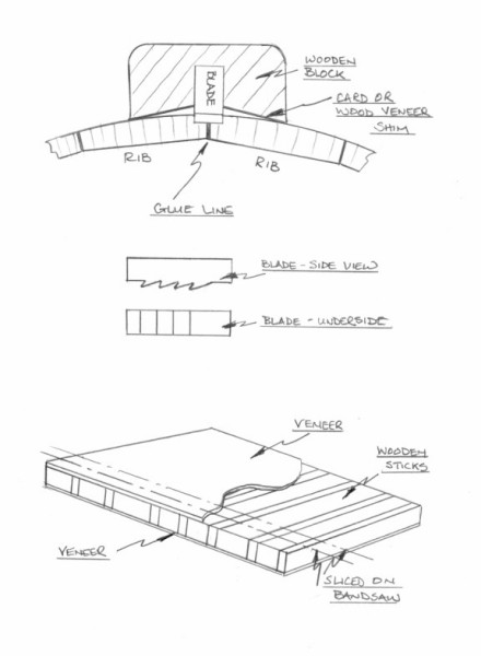

[*] posted on 9-11-2008 at 09:00 AM
The attached image gives a rough idea about the 'inlay plane' that I had in mind. A very simple affair - essentially a wooden block with the cutter glued in place with epoxy resin. The underside of the block is a shallow 'V' section so that it will 'self centre' on the curved surface of the bowl. The blade height might be adjustedto the required depth of cut for the inlay channel by gluing card or veneer of the required thickness on the surface of the 'V'.
The blade is made from a piece of steel of slightly less width than the inlay channel with saw teeth cut either with a needle file or with a steel cutting chisel. The teeth are cut straight across the blade and have no 'set' as a normal saw blade would have. This is in essence a miniature plane maker's "float" or file which produces a very smooth cut. For occasional work, the teeth likely would not require hardening.
I make miniature chisels - suitable for cutting out the waste material from the banding channel - from carbon steel rod, heated to red heat with a propane torch and hammered and bent to the required shape followed by oil quenching and tempering.
I shall make a prototype of this tool to see how well it works and will post the results later as a separate thread. However, if anyone wants to go ahead and try their hand at making one feel free to do so. We can compare notes later!
To make the tiled inlay banding, the attached image illustrates the method I would use. The tiles start life as wooden sticks of the required section glued together side by side and then glued as a 'sandwich' between two sheets of veneer. After the glue has dried, the 'sandwich' is then cut into slices of the required thickness (about 1mm +) on a bandsaw using a fine toothed blade. The saw marks may then be removed (if necessary) using a simple purfling thicknesser of the type that I am using in the thread " Old Project - New Lute" in the Projects Forum. The saw marks could also be left - if fine enough - as they will be hidden in the inlay channel on one side and will be removed by final sanding on the outer face.
Inlay Plane (576 x 785) (440 x 600).jpg - 32kB
[*] posted on 9-11-2008 at 09:44 AM
BRAVO!
that is really really clever!

[*] posted on 9-11-2008 at 11:01 AM
Nice idea incorporating the float instead of the chisel. You probably wouldn't have more than a tooth or two engaged in the cut at any one time because of the curve of the bowl, but the high angle of the float would provide a more controlled cut. I like your drawings almost as much as your ideas, John. Good stuff!
[*] posted on 9-11-2008 at 11:41 AM
I was thinking would it be viable to sharpen the blade and put a hook on it like on a scraper blade? that would avoid making all this precision filing
[*] posted on 9-11-2008 at 12:29 PM
I am not sure that a single 'scraper' style edge would work Samir - as Jameel notes, only a single tooth would be cutting at any one time but you would need two or three teeth to ensure that at least one tooth would be always cutting due to the longitudinal curvature of the bowl. Besides - due to the small size of the blade - filing the saw teeth should not be a great problem. The best shape of tooth would be one cut with a chisel - like a hand made file - but this might require a bit of skill and practice to 'get it right'!
I should say that I do not think that this proposal to cut a uniform, shallow channel for a banding inlay will be quite as easy in practice as it might appear on paper - which is why it likely is not a traditional method used on oud bowls (is it?) But it would be a nice option if it could be made to work easily, accurately and efficiently.
More than likely, between rib purfling has always been made to the full depth or thickness of a rib - probably because it is less time consuming in the long run for an experienced luthier to do it this way.
Incidentally, for information, I have checked the old oud that I have and the purfling (conventional white-black-white) is about 3mm wide overall, parallel along its length (more or less!) and is full depth.
That is one nice looking oud.

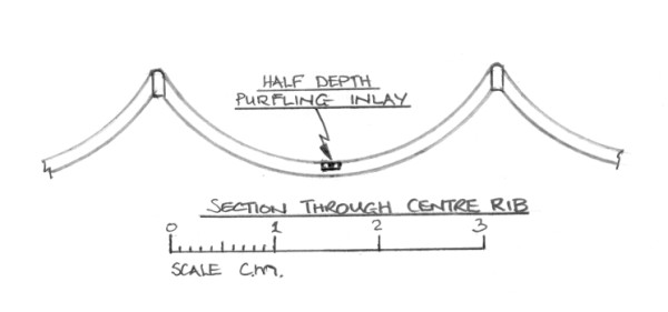

[*] posted on 11-21-2008 at 07:24 AM
I have not yet explored further the possibility of cutting half depth banding or purfling grooves over the rib joints of an oud but came across this bit of information that may be of interest.
Re-examining a museum drawing of the 16th C Dias guitar in the Royal College of Music, London recently, the drawing shows that the (ivory?) fillets between the ribs are full rib depth but that there is also decorative purfling set into the centre rib that is only about half rib depth. The depth (or thickness) of the ribs is about 1.2 mm and the purfling about 1.5 mm wide by 0.5 mm thick, a 'sandwich of kingwood between ivory - pretty delicate stuff. The rib surface below the purfling is reinforced with a strip of parchment. The sides of the guitar are also decorated with the same half depth purfling.
The guitar is a fluted rib vaulted back design. The longitudinal curve of the ribs is much less than that of an oud but the figure '8' sides have tighter radius curves than the bowl of an oud and the surfaces are concave as well as convex. The question is how was the channel for the purfling originally cut and with what kind of tool? Was the channel cut after the guitar body had been fully assembled or were the channels cut before the ribs and sides were bent and the purfling glued in place after the body had been fully assembled?
I suppose that the easiest solution would be to cut the purfling groove prior to bending - although this might increase the risk of the ribs splitting under the stress of bending.
Cutting the groove after bending might still be possible but guiding the tool accurately and, at the same time, maintaining a consistent depth of groove, would be a very skilled operation.
Of course, to pre-cut a half depth channel over a rib joint would not be a viable option for an oud bowl.
Dias Purfling (600 x 281).jpg - 18kB
