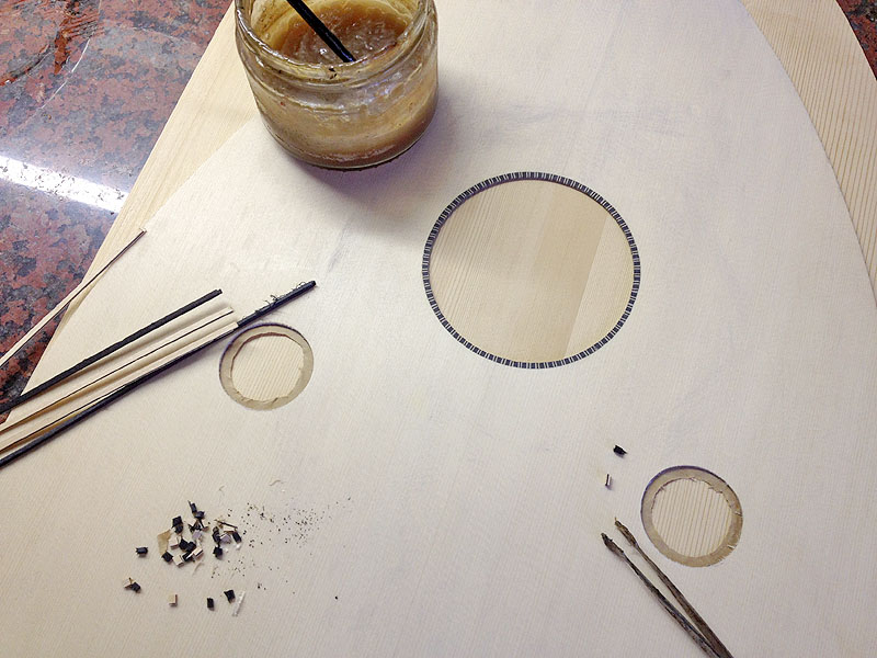

Seven course cocobolo
The Cocobolo oud will be a seven course oud this time.
the soundboard is master degree german spruce.
the rosettes purfling is made using black and white tiles, using hot glue to join the small pieces.
there is also a paper support under each opening to give an extra support.
when the hot glue is cured, the rosette purfling is very strong and can be sanded down carefully to the soundboard level.
IMG_0061.jpg - 128kB
Best regards, Samir

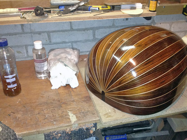

Sanding, french polishing
Thank you Bulerias
The back has been first scraped and then sanded starting from 120, 150, 180, 220, 280, 360, 400, 600, 1000 and 2000 grid.
A pore filler is used as sealer to smooth the oud and give a nice fisnih with the french polish. 2 days of polishing should be enouph every now and then a new coat.
IMG_0072.jpg - 104kB
Best regards, Samir

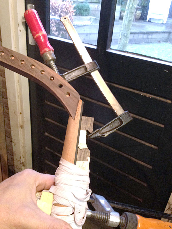

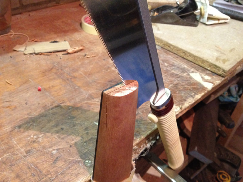

opening the pegbox/neck join
The opening is made carefully using japenese hand saws, the opening is not parallele to the fingerboard. to my opinion it gives a better look as we see later.
IMG_0079.jpg - 120kB
Best regards, Samir

mounting and joining the peg box
after some tweaks, the peg box fits nicely, and when applying some pression the glue squeezes from the 4 openings.
IMG_0082.jpg - 140kB
Best regards, Samir

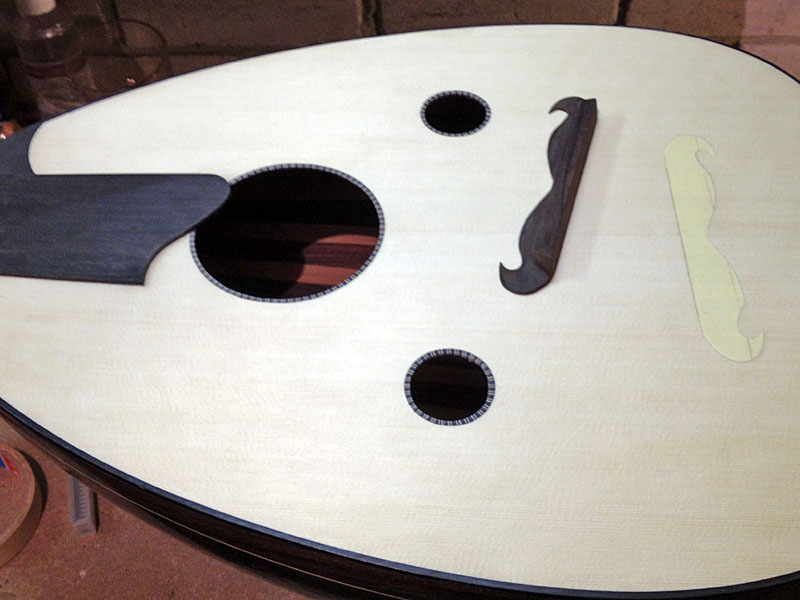

french polishing the top (shellac)
The bridge is made ready first and the masking tape takes the shape of the bridge on the soundboard. this can be done by drawing with a fine pencile around the bridge , applying a masking tape, and then cutting around the edges of the pencil on the tape.
IMG_0083.jpg - 97kB IMG_0085.jpg - 98kB
Best regards, Samir

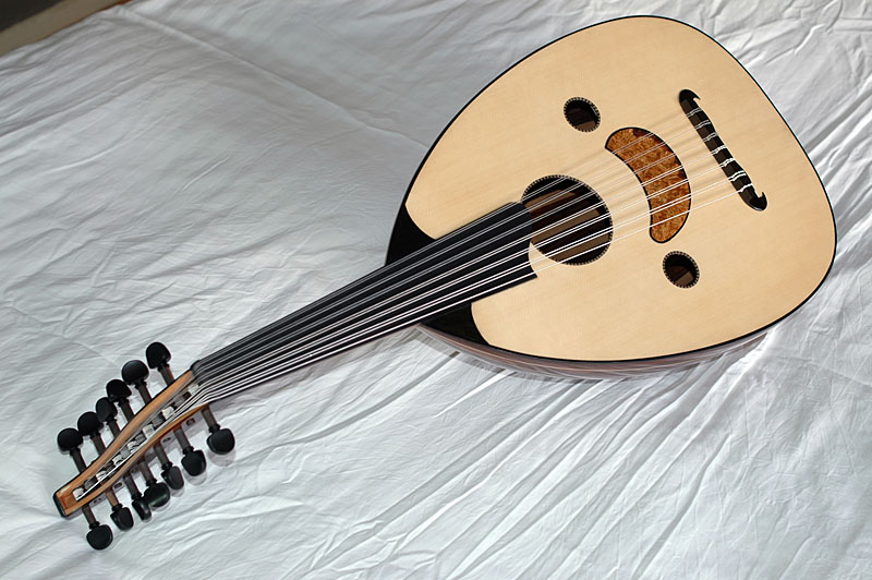

End project

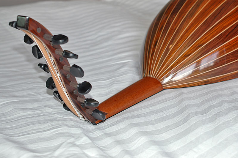

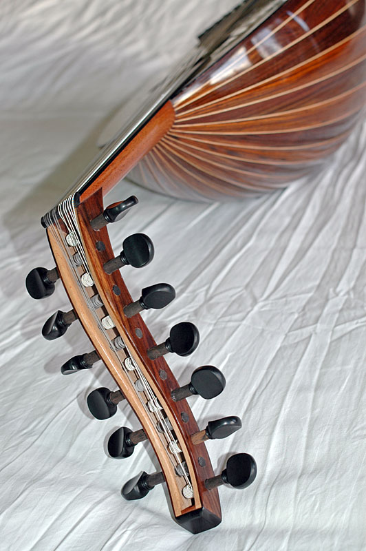

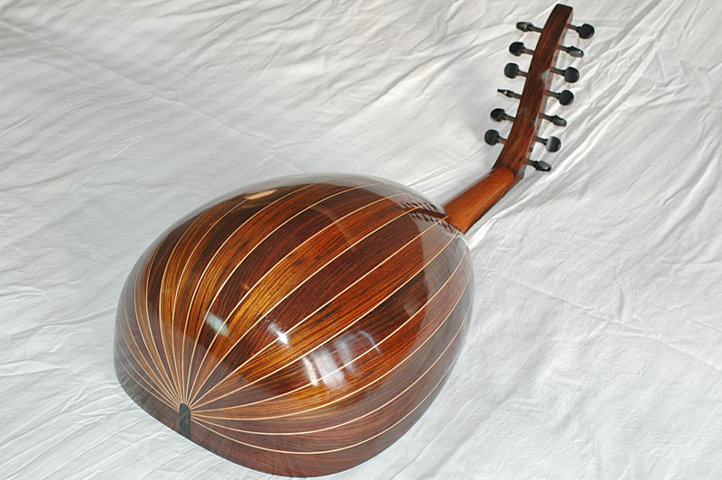

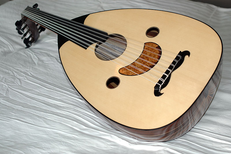

HI Guys, the cocobolo oud is finished, I still have to make a nice rosette and mounted later this week.
the strings are on and it is ready to play some tunes. this is by the way my first 7 course oud.
the strings are labella FCGDAFC
Brasilian Rosewood bridge
root wood pickguard
strings lenght 58,5cm
DSC_9801.jpg - 120kB DSC_9806.jpg - 123kB DSC_9819.jpg - 128kB DSC_9825.jpg - 121kB DSC_9828.jpg - 112kB
Best regards, Samir

sabbassi
Posts: 570
Registered: 4-28-2008
Location: Morocoo
Mood: happy
[*] posted on 12-18-2011 at 05:41 AM
Thank you guys, I appreciate this
I will make a bone rosette for it this days, and probably will sell it if I can get what it is worth.
I have mounted Pyramid lute trings on it instead, I will make a video/sound tomorrow and post it here.
I have also changed the nut to bone nut and lowered the action to 2.5 (neck join) . 7 strings is lot of tension.
the action now is very nice and smooth, buzz free
thanks
Best regards, Samir
