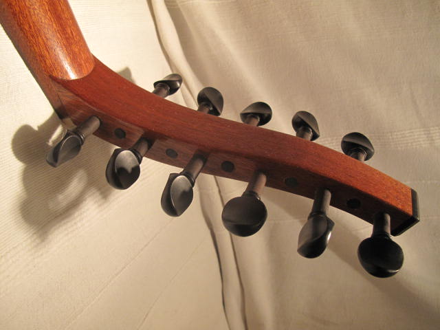

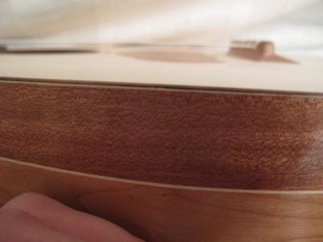

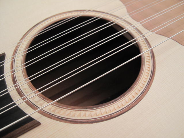

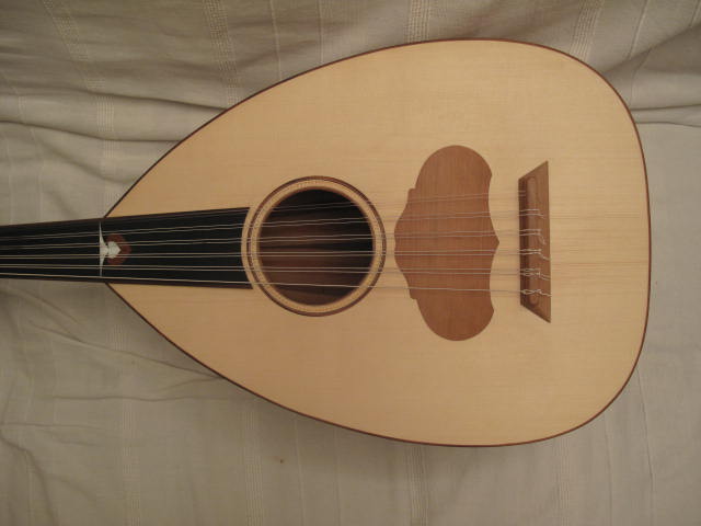

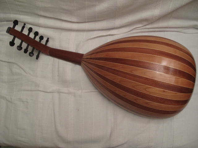

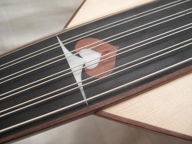

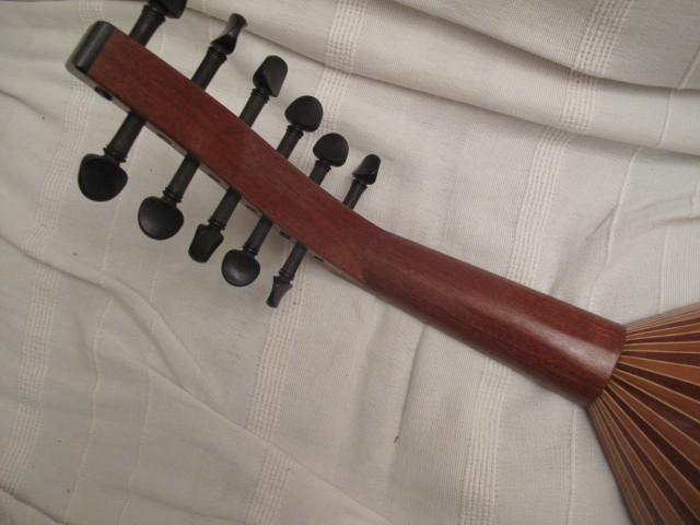

Hello all,
just like to share with you pictures and a record for my new oud. One may talk of restauration because the bowl as been used from scratch after some modification.
Then everything else has been built from new by Thomas Dauge who has create the soundboard and made a new neck and peghead.
It is by his help that i could conclude this older project (http://www.mikeouds.com/messageboard/viewthread.php?tid=16096). This time he made all on his own, keeping some tracks from the older project but using another receipe for thinking the soundboard.
Hope you'll enjoy as much as I. I feel the sound rich and well equilibrate. The design he realized is a pleasure for me
Here are some pictures. And a mobile phone record..Hope it will give justice to its sound ! The oud is 2 weeks old
https://www.youtube.com/watch?v=WWdkwxfgPNM
The website of Thomas Dauge:
http://www.thomasdauge.com/
http://www.thomasdauge.com/19.html
Best regards to all
IMG_1300.JPG - 42kB IMG_1301.JPG - 43kB IMG_1304.JPG - 36kB IMG_1305.JPG - 56kB IMG_1306.JPG - 59kB IMG_1309.JPG - 33kB IMG_1310.JPG - 46kB

That's a very fine looking oud! And your video is fine too, the oud sounds very clear and crisp to me even when played in higher positions.

Congratulations for your new oud Marouan ! The sound seems well balanced and the craftsmanship is really good....

Thanks, i'm glad you like it. I will try to make new record in other condition, to give another catch for the sound.
indeed the sound keeps well defined in the trebles, this area of the soundboard was think for that and it worked fine.
Dan, the bowl is not a Sandi this time. Seems he doesn't propose his kits anymore. This time the bowl come from a Turkish oud which went for sale in my area, unknown maker,I think from the late 80's beginning 90's.
All other woods come from Thomas's sources.
For sure next project should be making the bowl also. We made this choice this time for a matter of availability and to keep the project affordable. But as you can see on his website for the lutes he build, he can make bowls for sure ;)
