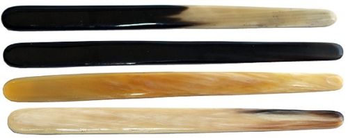

Hi all. All new stock in. Spent most of the day yesterday making this large bunch. Order them soon cause they go fast. I have a nice amount of stubby ones on the bottom right. Usually I dont use these for concerts myself, but I keep one in my wallet for when I lose mine or when I dont have my oud, and a few times it came in handy. I also have a few really long ones 150mm + as some people prefer this. And I have everything in between. Dont forget I also make saz/baglama/buzuq picks as well.

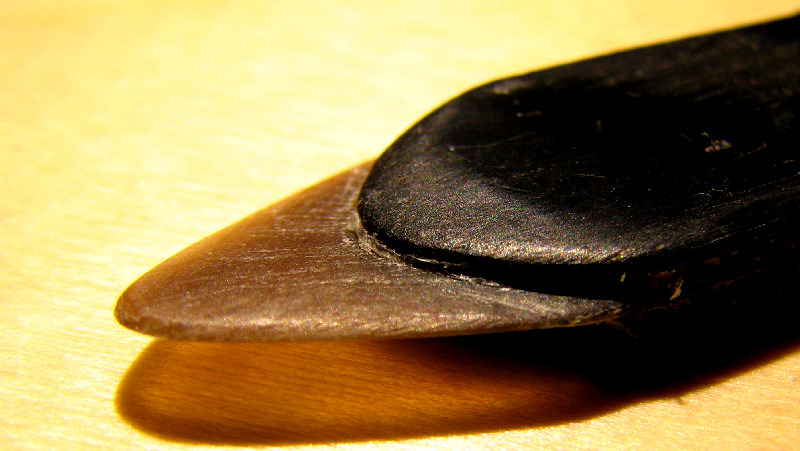

Not to detract from the beauties here, for the budget-tied, the horn blanks from MidEast Manufacturing that a lot of US on-line shops sell at about $10 for 6 are maybe a little thin at 0.030", but very usable. They are soaked in oil and just need to be shaped. Now here comes something like the antithesis of the most elegant risha, my favorite:
RishaHornDelrin1.jpg - 48kB
Backed with a delrin blank, it's fat in the hand. I'll have to make a prettier one with shrink-tubing instead of the pathetic electrical tape, but this one plays very nicely.

[*] posted on 8-28-2011 at 07:16 PM
No question, Bulerias, and the prices you charge are very fair. I was just answering the question as to where blanks could be found inexpensively.
My oddball risha for some reason works very well for me, there's something about the extra thickness in the hand.
How thick are your thickest ones?

[*] posted on 8-28-2011 at 07:26 PM
One thing I learned is that everyone has their own preference. Blanks can indeed be found inexpensively. It just takes at minimum, a decent file (emery board) to do the rough shaping. Also take care and wear a dust mask, you don't want to inhale horn particles into your system.
My thickest rishis can be whatever the customer wants. I haven't done anything thicker than 1.2mm. The people that use these tend to hold the rishi very very short.

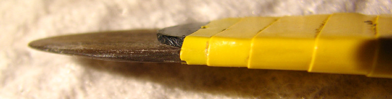

[*] posted on 8-29-2011 at 12:16 PM
As you say, we get attached to our rishi. Here's a (slightly) prettier version of the same concept. The horn (about 0.032", 0.8 mm) is sandwiched between two delrin blanks. I'm just looking for a way to have a slightly thicker grip, but retain a flexible risha. If the horn was that thick, it would be quite rigid. But probably we can all agree, there's nothing like horn. My lovely taped wonder has delrin at one end (for quiet practice) and horn at the other for real playing. Maybe horn in a thin leather "sandwich" would work.
RishaHornDelrin2.jpg - 122kB
