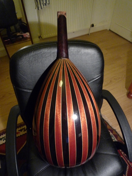

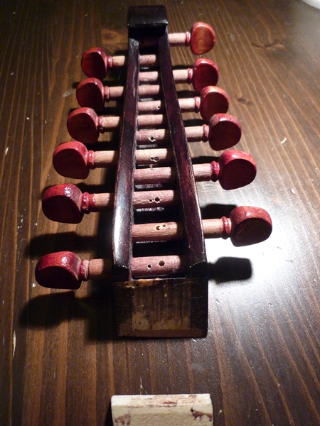

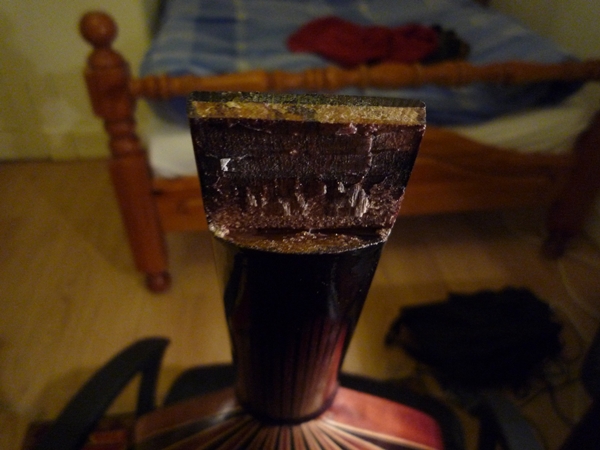

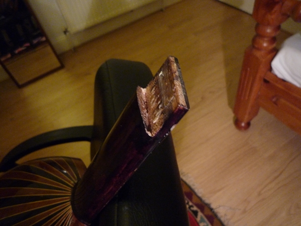

Hey folks,
Right here's the deal. The pegbox (+nut) has separated from the neck :(. This occurred when I was re-stringing my oud, the pegbox just fell off as the strings were being taken off.
However for a while I have noticed the neck-joint was loose, but the joint remained together whilst strung - It seems that the string tension was holding the joint together in the end and the glue was no longer effective.
Second of all, at the neck-body joint has several visible separations, and the adjacent ribs are slightly separating from the rim of the bowl (multiple splits on left side). i mentioned a year ago, and seems to have gotten a bit worse, but i hesistated hoping it would setting. This seems to me a more serious problem.
I live in the UK (Manchester, and also Scotland during term at university) and dont know any luthiers/teachers/oudists; could a local guitar shop repair this?
As a wind musician i have no experience in fixing string instruments. Unless in all your experiences you believe this can be fixed by myself, i dont fancy trying.
The oud is made by Jawharet Salmeen from Dubai, and is my first oud. I would like to fix it (i dont like potential instruments lying around not being played), but unless its going to cost me the price of a new instrument i dont see any economy in doing so.
So my questions:
- Can i fix this myself?
- Is it worth it to get repaired?
- Could these problems be related to the humidity in the UK?
Advice, tips, and warnings are all welcome.:)
Many thanks
Mehran
Oud.JPG - 219kB Pegbox & nut.JPG - 244kB

[*] posted on 2-22-2010 at 02:42 AM
It's hard to see what's happening at the neck/bowl area. Perhaps some more photos?
On the pegbox it looks like nothing is damaged at all. I would imagine that the oud was made in a dry climate with just enough hide glue, and in the damp "climate" of the U.K. the glue just softened and finally gave. I remember hearing of an oud that collapsed into a small pile of wooden parts when taken from the desert to the seashore.
I would just get some hide glue and reglue the joints. I would use hot hide glue unless there's no way you can, in which case you can use liquid hide glue as long as it's well short of expiry date. Clamp as best you can, let set a day or two and she should be good to go. I'd say it's eminently fixable, no big deal. The other areas can probably be glued as well, hide glue makes a good filler and tends to pull the parts together. You can use heat to reposition pieces. But some better photos would help.
Although such joints would likely never come undone, I would not yield to the temptation to use an aliphatic resin glue, so called carpenter's glue, because it's much better to be able to repair and reglue joints as needed than to have a joint that cannot be undone/redone. Resin glues are strong but unlike hide glue they creep under tension, and then the joints cannot be redone without completely removing all the old glue (this is considered a one shot joint). So just stick to what instrument makers have used for centuries if not millenia.

Hi Mehran,
I had exactly the same problem with my oud a while ago - the peg box just fell off without warning. It was easy enough to fix and i'm sure you can do it yourself.
I used Araldite two component glue (the slow drying one).
Just prepare as usual:
Sand down all bits of left-over glue.
Dry, clean, slightly roughened surfaces.
Use clamp to hold it in palce.
Make sure you place the peg box EXACTLY where it was before breaking off.
Allow a good one and a half days to dry.
You'll be fine.
When mine broke off I thought long and hard what could have happened and in the end put it down to sloppy manufacturing and not enough glue being used in the first place. I'm quite glad I had to re-glue it as now I know it will hold!
Good luck!

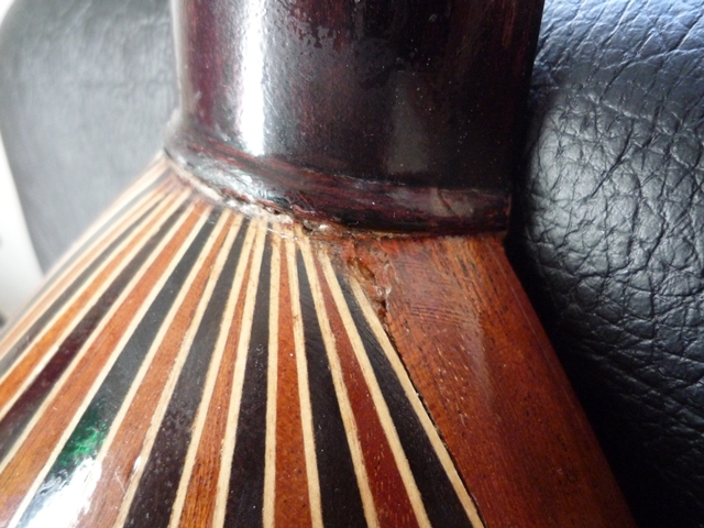

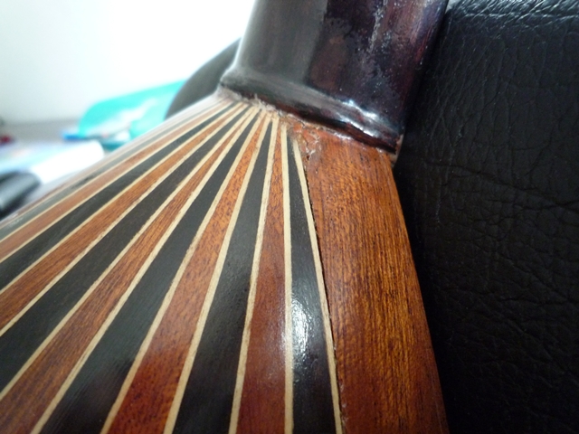

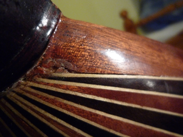

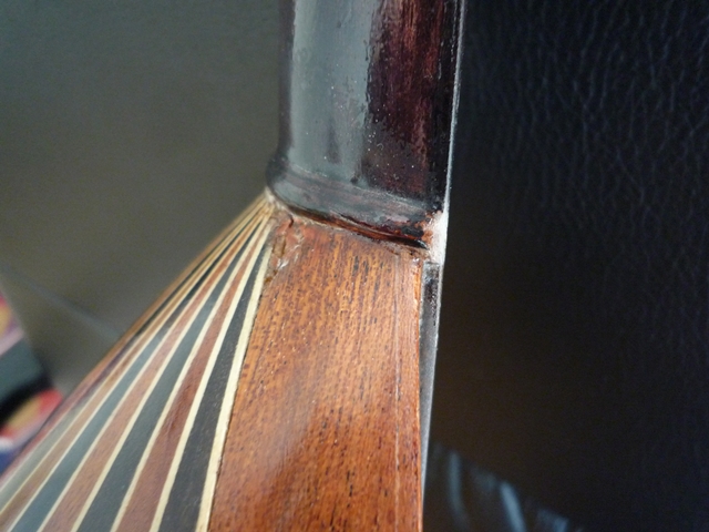

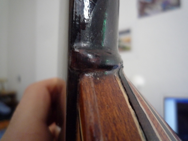

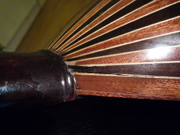

Rights here more images of neck-bowl area, its hard to see exactly what going on. (click images for enlargement)
What it looks like is the joint between the 1st and second rib on each side is separating (not between the first rib and the soundboard).
On the right side the split between the ribs is around 5-6 cm long. You can also see that where the split has begun, a small area where the wood has disintegrated.
right.JPG - 260kB right1.JPG - 232kB
This looks much more dramatic in the picture than it really does.
On the left the split between the 1st-2nd rib is around 5cm long.
left.JPG - 253kB
***Its interesting to note that the split between the second/third rib on the left side has closed off since last night (when I took the strings off), probably because the strung tension no longer applies.

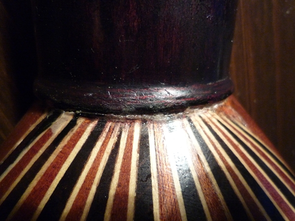

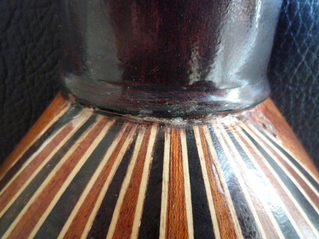

Between the neck and the rest of the bowl a small line of separation can be seen - its hard to see what's happening here. Cant get close enough for the camera to really see whats happening.
centre.JPG - 247kB
Note the joint between the neck and the 1st rib seems to be pretty intact, and that they splits are happening after it.
other.JPG - 217kB other 1.JPG - 179kB
Say i did want to try and repair it myself, id have a few questions:
- what grit rating of sandpaper? how far do clean it (just the glue, or make it really smooth by taking some wood)
- how would i clamp the joint? is there a special "oud" clamp?
- where is the best glue available?
- any other tools required?
- what would be done to fix the neck-bowl area? (or at least prevent it from getting worse)

Am I mistaken or are the cracks at the neck/body joint not causing any structural problems? Is there any movement between the neck and body? It looks like a fairly typical "production" job, where gobs of varnish and "paint" are used to create the impression of smoothness and fit that were not achieved by mortal means. If there isn't any movement I would respect the tradition and"inject" hide glue into the crevices. I can't see using any sandpaper there unless it bleeds out and needs to be taken down. But hide glue sets as a golden amber and should look nice. If the rib can be pushed deeper in, do so, if not, leave it. As you said, it's your first oud.
Let's be practical. Glues have a whole "second life" issue. Gluing a volkswagen to a gorilla to Houdini's shoes is relatively simple. But what later, when you need to undo it? And the next day when the trick must be repeated? Glues don't like to meet other glues. They don't mind their own flesh and blood.
Your separations look clean, to the point where you can probably use the residual glue to help you align the pieces. Check it. If the pieces line up well, glue and all, you'd be a masochist to start with removing the old glue. Yet if you want to apply products like "Smeagol's All-Purpose Petrochemical Smear" or "Vulcan's Own Toxy-Poxy" or "Gorilla Rigormortis", you will find removing the previous glue is part of the fun. If you use the same type you can use the tried and true "more glue" approach, as long as you clamp the pieces too.
Identify the glue the good folks at Jawharet Salmeen used to assemble your instrument. Use a hot needle to see if the residual glue melts nicely. Use hot water on another tiny spot to confirm. It it's meltable and softens with hot water, 99% chance it's old-fashioned hide glue. The solution is pretty obvious. I like easy. If you don't see a glue-pot and accessories in your near-future, know that Liquid Hide Glue is just hide glue with some urea and mystery salts added, that for some reason stays viscous at room temperature until spread out and exposed to air. There is resistance to the liquid stuff among the cognoscenti, but for no clear reason. The technical data looks the same for liquid vs. traditional hot melt. There are plastic or plastic-coated clamps that don't hurt the wood, and it's a matter of what you can find in the local shops, but old style C clamps can probably work fine.
Of course if a coven of luthiers in Manchester will inspect your ruin and poke and prod and prognosticate, and you don't really NEED the oud, you can put it off ;-)

The pegbox to neck joint, at best of times, is relatively weak due to the areas of end grain in the joint surfaces. To judge from the images posted, the joint problem seems to be due to a failure of the glue - not the surrounding wood surfaces.
Hot hide glue is the traditional glue used for this joint and will be satisfactory if properly prepared and applied. However, a weak hide glue joint may manifest itself in failure if:
1) the joint is not a perfect fit.
2) the glue is of insufficient 'bloom' strength or poor quality.
3) the glue has been weakened by reheating in the pot too many times (i.e. is not freshly made).
4) the glue has been weakened by over diluting with water in the pot.
5) the glue has been weakened by 'cooking' in the pot above 140F.
6) the glue has been allowed to cool and 'gel' before clamping the joint. ('speed is of the essence' when using hot hide glue - a few seconds at best).
Using hot hide glue successfully requires some experience! Liquid hide glue falls into category 2) above (despite claims of a few enthusiasts as to its effectiveness). It is probably stronger than the poorest grades of hot hide glue but inferior to the best hot hide glue (the same applies to liquid fish glue - but that's another story)
Also incorrectly prepared weak hide glue may be hard but brittle and will fail if subject to impact loads - like accidentally knocking the end of the peg box against a hard surface or worse, dropping the oud, pegbox down, on the floor!
So, if you have little or no experience in making or repairing instruments using hide glue and your instrument is valuable (probably not in your case as the pegbox joint glue has failed - an indication of inferior workmanship) and you want hot hide glue to be used for the repair then take it to a professional luthier to get the job done (although not all professional luthiers use hide glue!).
Otherwise, if the instrument is not of significant value and you are otherwise obliged to repair the pegbox joint quickly and cheaply yourself, take the advice of littleseb and use Araldite epoxy. Remove the weak hide glue residues and loose wood fragments so that the joint is a good fit - use a file and take your time!) I have used this brand of epoxy in the past for gluing lute pegboxes and have never had any failures of the pegbox/neck joint. Bear in mind that the joint surfaces must be well fitting and well degreased (I used 'Genklene' in the past - a solvent used for removing grease spots from clothing). Also, not all brands of epoxy are equal - 'Araldite' two part, slow cure is OK in my experience.
Good luck!
