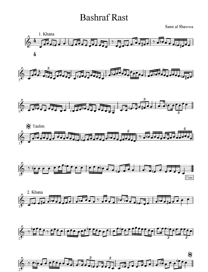

Saba on Huseyni (A) and Rast.
Bashraf Rast (Sami Al Shawwa):
Attachment: bashraf-rast-al-shawwa.pdf (161kB)
This file has been downloaded 291 times
(Modulation to Dilnishin in the third Khana).

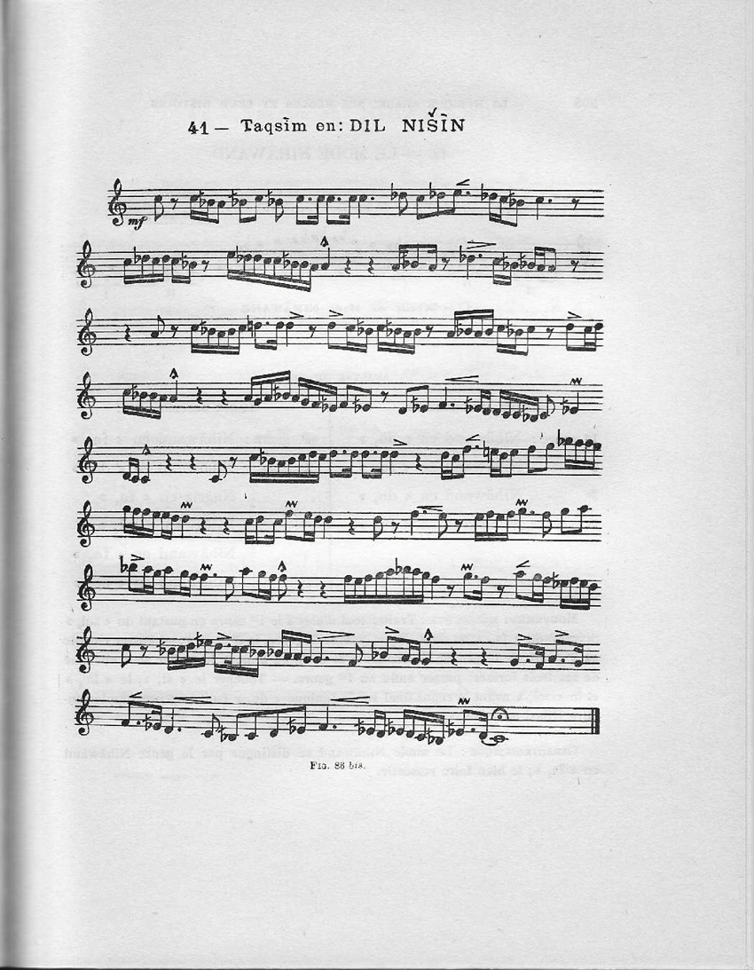

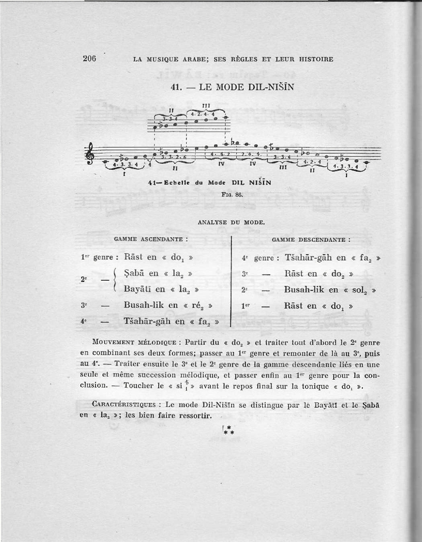

Structure and taqsim from the D'Erlanger book:
Attachment: phpypICd4 (467kB)
This file has been downloaded 296 times Attachment: php9kN3vX (541kB)
This file has been downloaded 341 times

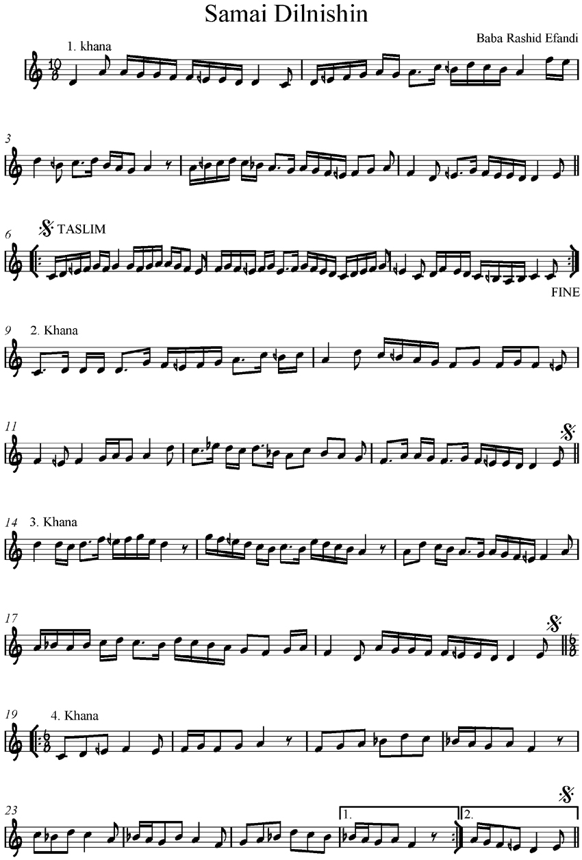

Version 2.
'Dilnishin Turki':
A Blend of Huseyni and Rast.
Samai Dilnishin.jpg - 341kB

The maqam structure:
http://www.alsiadi.com/Maqam_Dalansheen.html

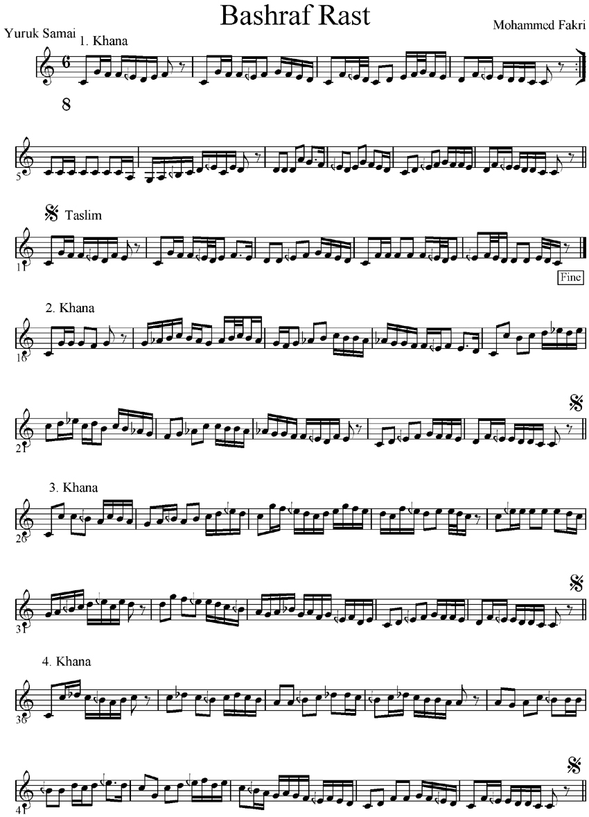

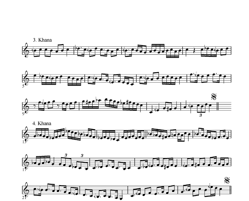

Here are two (Arabic) Rast Bashraf that modulate to Dilnishin (Dalansheen).
The first is my re-written version of the Sami Al Shawwa piece.
Dilnishin appears in the third khana.
Bashraf Rast Shawwa 1.jpg - 275kB Bashraf Rast Shawwa 2.jpg - 189kB
The second is a Syrian piece by Mohammed Fakhri.
Dilnishin is in the fourth khana.
Bashraf Rast.jpg - 362kB

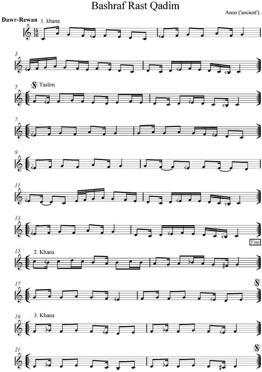

I have also encountered Saba (on Dugah) following Rast (Rast).
Rob Simms, in his book 'The repertoire of Iraqi Maqam',
http://www.amazon.com/Repertoire-Iraqi-Maqam-Rob-Simms/dp/081084758...
mentions that there are two varieties of Rast; 'Rast Hindi' and 'Rast Turki'.
'Rast Hindi' commonly modulates to Bayati, Saba and Hijaz on Nawa and Segah.
'Rast Turki' commonly modulates to Saba (dugah) and Hijaz (dugah).
This modulation to Saba (dugah) is in the third khana of the 'Bashraf Rast Qadim' piece (Cantemir) .
.Bashraf Rast Qadim.jpg - 301kB
