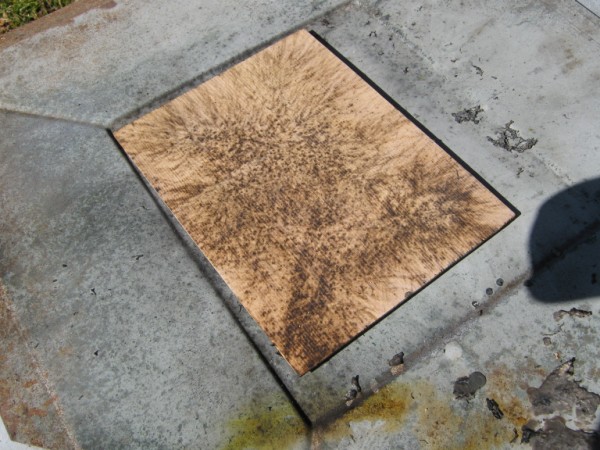

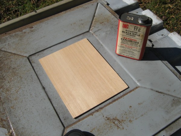

However, for those who would like to try carbonising the outer surface of an oud soundboard I ran a test yesterday on a piece of Sitka spruce
soundboard material out of curiosity. The attached images show the result.
Gunpowder (or 'blackpowder' as it is usually referred to) was replaced by modern 'smokless' explosives for guns during the early 20th C but is still
manufactured for those who use antique weapons such as flintlock or percussion lock muskets etc for military re-enactments or 'primitive' hunting.
Blackpowder is considered to be a low grade explosive and for sporting applications is available in four grades Fg, FFg, FFFg and FFFFg - the more F's
the finer the grain size of the powder - the finer the grain size, the faster the powder burns when ignited. It is important to select the correct
grade of powder - a gun firing a heavy projectile requires a slower burning powder than one firing a lighter projectile. So, for example using FFFF
grade powder in an antique 12 bore shotgun is asking for trouble with likely destruction of the gun barrel.
Blackpowder, when ignited rapidly burns (with a 'whoosh' sound) to produce a cloud of gas (white smoke) - as seen in the video. As long as the powder

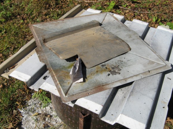

is not closely confined it will not result in an explosion. I did not have to hand a fireproof blanket (as seen in the video) so instead used a thin
stainless steel plate to cover the test piece. The plate was curved so that it was not in close contact with the test piece.
It is important to undertake any trials outside (notice the fire alarm sounding in the video!) for obvious reasons. I sprinkled a small quantity of FF
grade powder over the surface of the test piece, covered it with the plate and used a strip of newspaper as a fuse - giving me time to step well back
before the powder ignited.

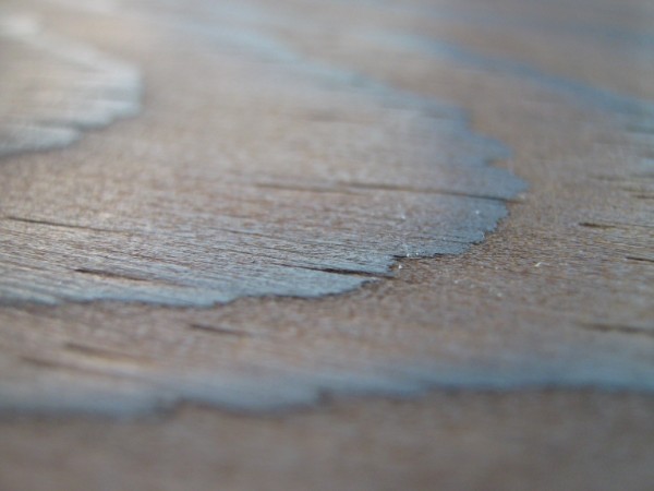

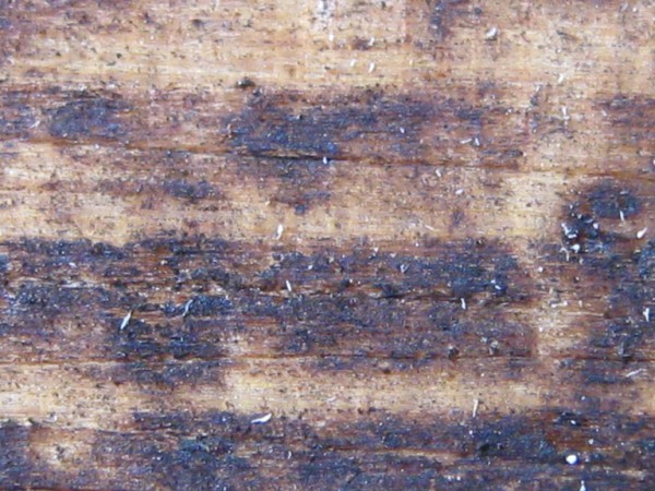

The result was indeed a burnt piece of wood - see the attached images but the scorching, although decorative in appearance, was far from uniform.
Perhaps more powder of faster burning grade is necessary to achieve a more uniform charring of the wood?
The attached close up of some of the more heavily charred areas shows localised 'pitting' and longitudinal fissures along the grain of the test piece
(the small white bits in the image are fragments of paper that I used to brush off the loose, coarse bits of carbon and burnt powder residue.
Another characteristic of burnt blackpowder is the lingering smell - resembling rotten eggs - enough to require removal of the test piece from my
workshop after photos had been taken!

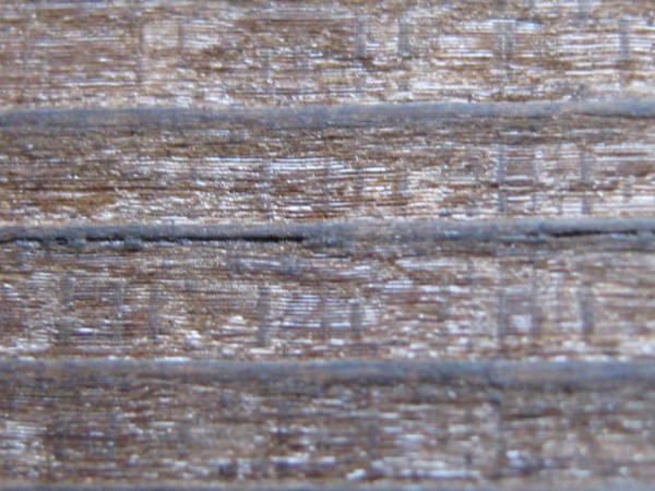

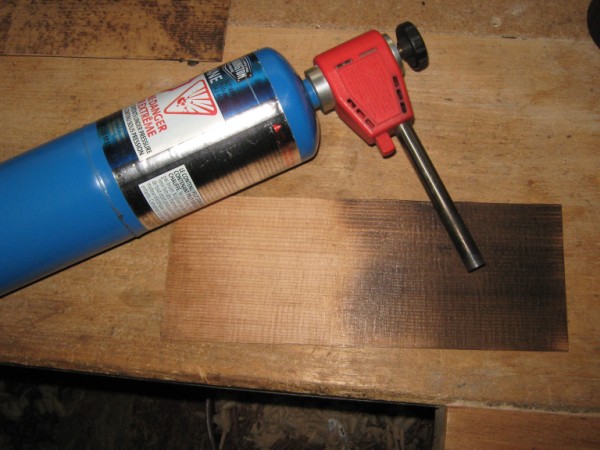

For experimental luthiers who are nervous about playing around with gunpowder, a safer alternative would be to uniformly burn a soundboard surface
with a propane torch and then remove much of the carbonised wood with fine steel wool rubbed in the direction of the grain.
This results in a 'raised grain' finish as the softer early wood cells are less resistant than the late wood cells.
The attached images are of a test piece of quarter sawn Sitka spruce - the macro image showing the latewood cells standing proud of the early wood
cells between.
The burning process causes the surface wood cells to shrink relative to the uncarbonised face of the wood causing permanent 'cupping' or 'bowing'
across the wood grain.
This might have some acoustic effect (good or bad) on a soundboard so treated?

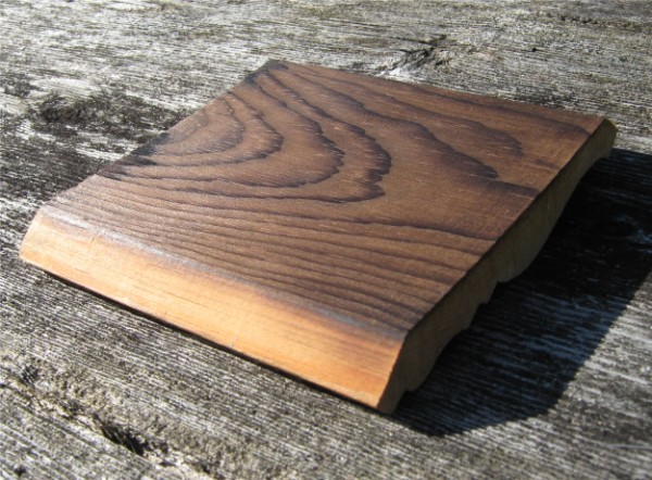

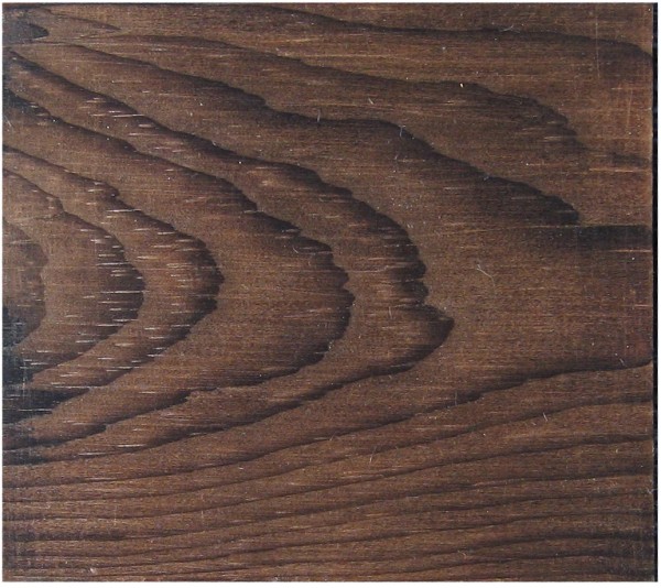

To complete these brief burning trials - for curiosity and information - a piece of slab cut white pine (plain white in colour) about 12 mm thick was
subject to uniform surface burning with a propane torch, rubbed in the grain direction with steel wool and then burnished with a cloth. This again
resulted in a slight 'raised grain' and 'cupping' across the grain - despite the relative thickness of the test piece.
I suspect that the carbonised wood surface also becomes harder than before - although I have no way of confirming this.
The resulting uniform Chestnut colour and resulting emphasis of the wood grain pattern is surprising - much better than can usually be achieved with a
wood stain on softwood. I understand that this procedure is sometimes used by woodworkers as a finishing procedure - but I had never tried it before
now.
So this might at least be a useful finishing procedure for some lighter toned luthier woods even if not recommended for more critical soundboard
