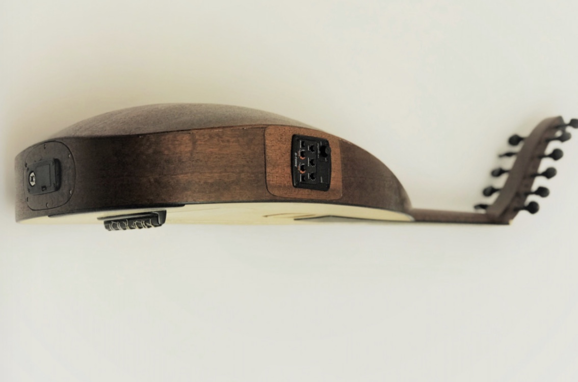

can someone explain to me how can you build an oud with this shape? it is flat with a little bowl shape!

I have built instruments with this design of back. Here's a renaissance vihuela I built earlier this year for a customer in the USA:
The trick is to build a form first, the same as with a bowlback, but a different kind of form. Then use this form to know the correct side depth at different points, and the arch of the back for bending.

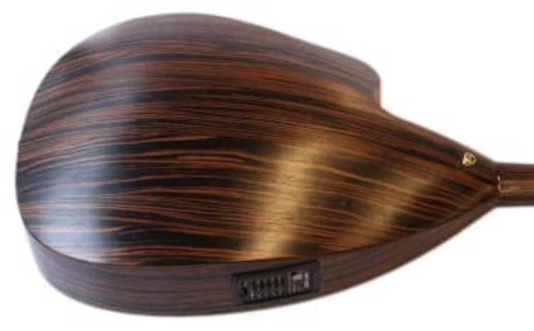

this is a similar shape without any curves in the sides !!

I have found my original mold for the vaulted back guitar so attach some images of a temporary set up for information and clarification. The mold does not need to be solid and full depth but is mounted on a spacer block to provide the required full depth of the guitar sides. This results in a considerable saving in material and work.
The guitar is built up in the face down configuration on a flat board - together with the finished neck/pegbox assembly.
The oversized side blanks after heat bending and trial fitting to the mold are then carved down to fit the mold profile (and edge angle) at all points - as mentioned earlier by Jo in this thread.
The shaped sides are then glued to the neck and end block and the ribs of the vaulted back bent, shaped, fitted and glued together in place. After trimming the rib edges the completed body/neck assembly is then removed from the mold and internal reinforcing strips of paper or thin fabric are glued over the rib joints - as is the case for an oud or lute bowl.
